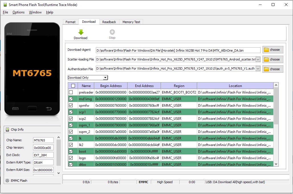

How to flash / unbrick a Infinix HOT 7 Pro X625
If you have trouble flashing then get the custom Infinix Download Agent (DA) file for this model
Before flashing, ensure that:
  • The battery is charged to an extent and inserted into the phone
  • The phone is powered off / switched off
  • You have installed Mediatek Preloader USB VCOM drivers
  • You have downloaded either parts of or the complete firmware above (depending on what you need to flash) and unzipped into a folder
  • You have a PC and USB cord

how to flash this firmware pls help
06-06-2019, 10:26 PM
(06-06-2019, 01:20 PM)goldlink how to flash this firmware pls help
flash using SP flash tool @ https://www.hovatek.com/forum/thread-159.html or software download tool @ https://www.hovatek.com/forum/thread-23709.html
if you still have any problems then create a new thread so we'll focus on it
