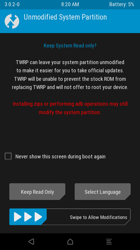

thanks a lot bro, i just found the TWRP 3.0.2
(pretended 3.0.0) on xda and it worked on my device but the
big problem now is that the touch input doesn't work, and
it looks like it's a kernel bug (unfixable) of the hit
looked for a non-touch based recovery (Philz,
CWM ...) everywhere but nothing Sad

(01-03-2019, 07:23 PM)TokyGerard
(01-03-2019, 07:00 AM)shankar1790 Twrp 3.2.1 with mtp support
https://mega.nz/#!20RwRYKL!Lxk4TDt7a-GMO...cI4boOG2Eo
Twrp 3.0.2
https://mega.nz/#!ilYg3YJa!2X4Ovo8X_xuCm...FMwKBhrbr4
No mtp support
Stuck here Sad

(01-03-2019, 07:34 PM)TokyGerard Stuck here Sad
alternatives for spd
try booting twrp using fastboot boot recovery.img
or
flash twrp recovery.img into boot partition then start up the phone using power button -- touch should be enabled but you will need to reflash your stock boot in order to return back to homescreen. this is similar to alternative 3 @ https://www.hovatek.com/forum/thread-24209.html

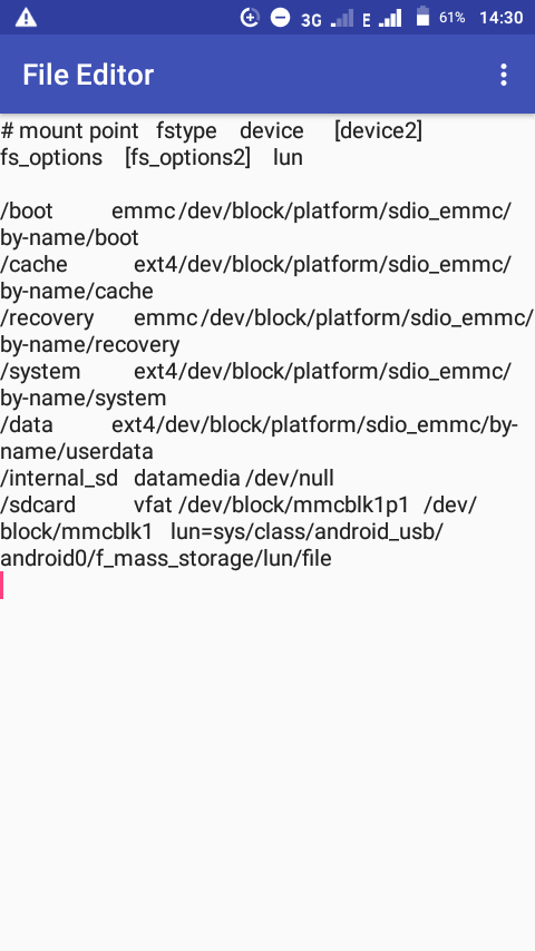

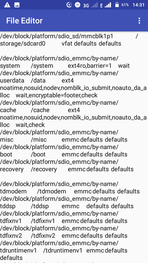

Thanks for your precious help bro, the alternative 3 seems suitable to me. Anyway I succeeded to port another non-touch based recovery using @shankar1790 's working TWRP as base by remplacing split_img and some files from ramdisk. I also tried to port CWMiui, Miui Recovery that @X3non gave me but their mountpoints are very precise with number and I didn't know how to compare them in fstab file. In CTR (from sc7731/sc8830) montpoints seem correct and similar but when I try to backup boot, my phone stuck in bootlogo and I didn't boot up once I reflashed stock boot on Research Download (but after I saw the boot backup in my sdcard located in clockworkmod/CTR folder), when I try to to backup system, it said "backup failed, can't mount system"... If you find any solution to fix that please tell me.
I leave here SS of my stock and ported CTR recovery :

(02-03-2019, 12:39 PM)TokyGerard Thanks for your precious help bro, the alternative 3 seems suitable to me. Anyway I succeeded to port another non-touch based recovery using @shankar1790 's working TWRP as base by remplacing split_img and some files from ramdisk. I also tried to port CWMiui, Miui Recovery that @X3non gave me but their mountpoints are very precise with number and I didn't know how to compare them in fstab file. In CTR (from sc7731/sc8830) montpoints seem correct and similar but when I try to backup boot, my phone stuck in bootlogo and I didn't boot up once I reflashed stock boot on Research Download (but after I saw the boot backup in my sdcard located in clockworkmod/CTR folder), when I try to to backup system, it said "backup failed, can't mount system"... If you find any solution to fix that please tell me.
i don't remember if any of those recoveries have a fully functional backup / restore feature, we only used them to help members achieve root when twrp touch doesn't work -- there was no magisk back then so root was mostly based on custom recoveries. ctr also bricked the device i tested with after backup / restore
you can get the number mount points using the guide @ https://www.hovatek.com/forum/thread-11203.html
test and see if the number mount points makes any difference on your device
