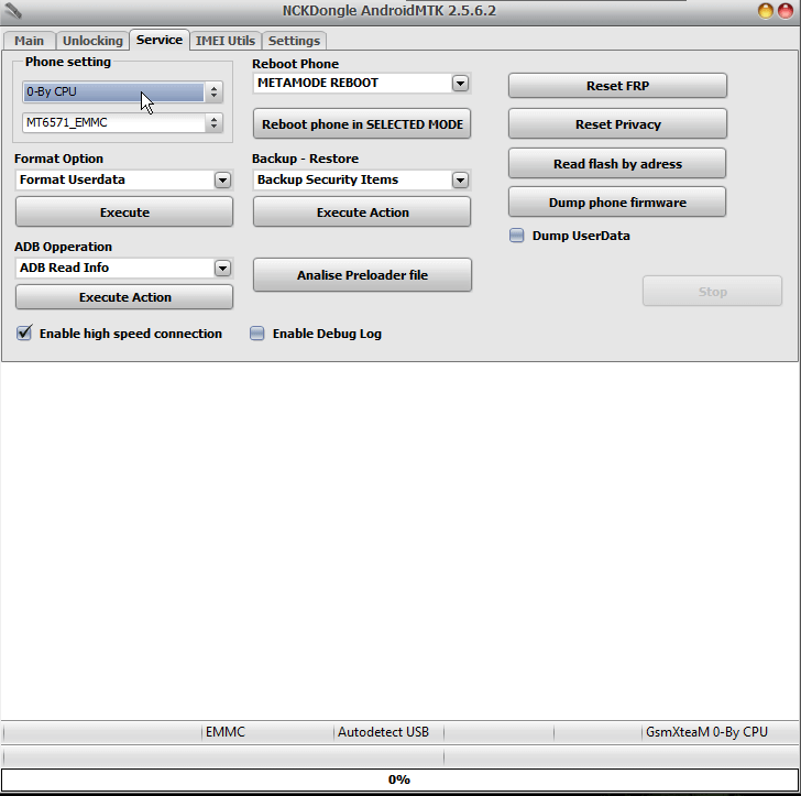

  2. Under Phone Setting leave first drop down as 0-By CPU
    [Image: how-to-bypass-privacy-protection-lock-us...ion-02.png]

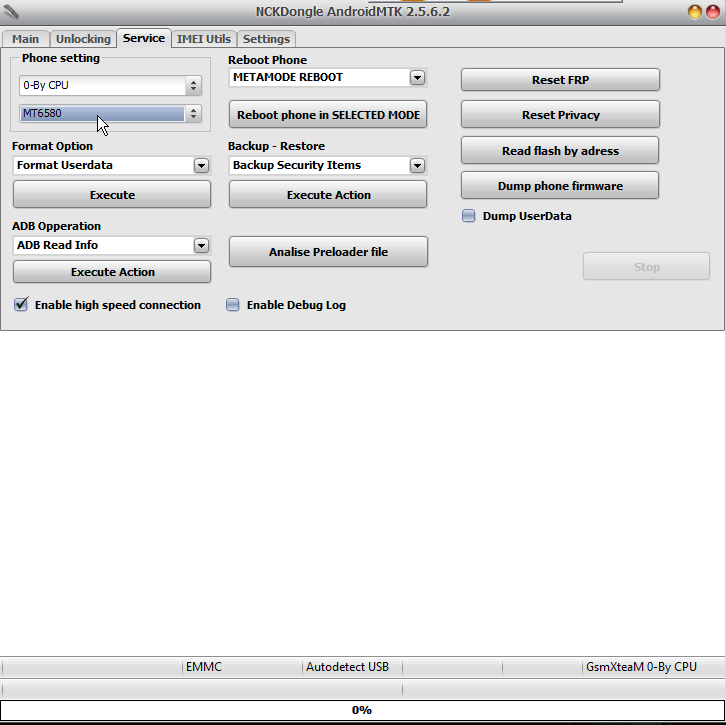

  3. On the second drop down box select your phone's CPU type, (findout using)
    [Image: how-to-bypass-privacy-protection-lock-us...ion-03.png]
