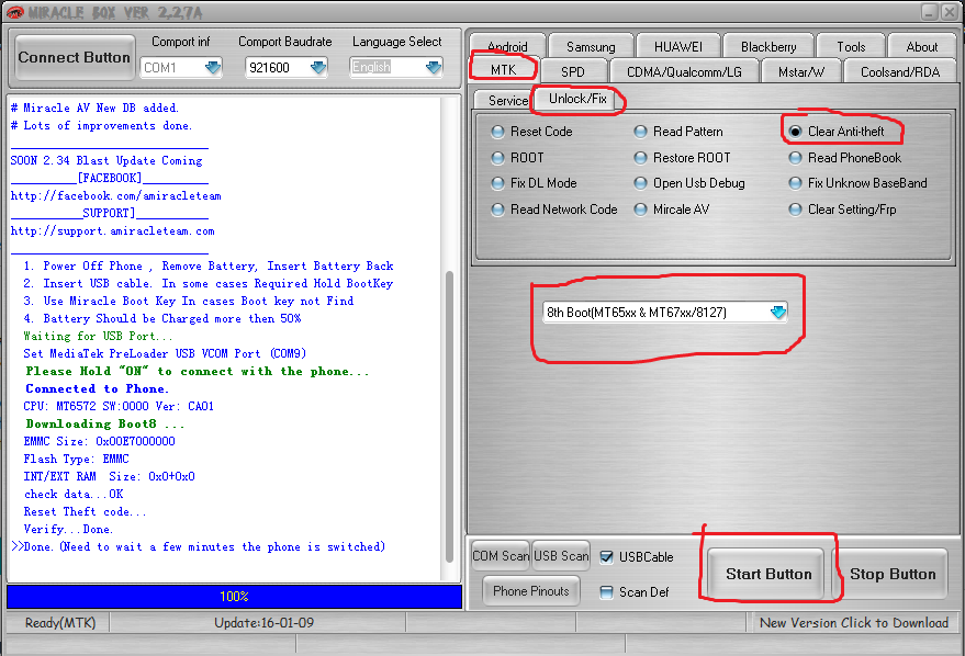

  3. Click on the MTK tab
    [Image: Hovatek-How-to-bypass-privacy-protection...-Box-2.jpg]
  4. Click on the Unlock / Fix tab
    [Image: Hovatek-How-to-bypass-privacy-protection...-Box-3.jpg]

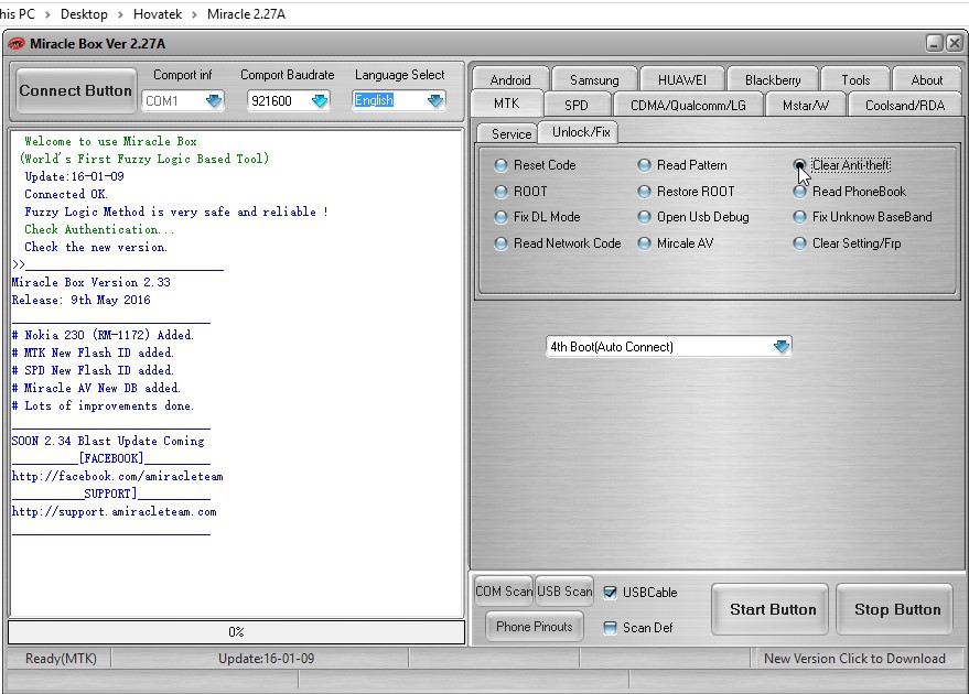

  5. Tick Clear Anti-theft
    [Image: Hovatek-How-to-bypass-privacy-protection...-Box-4.jpg]

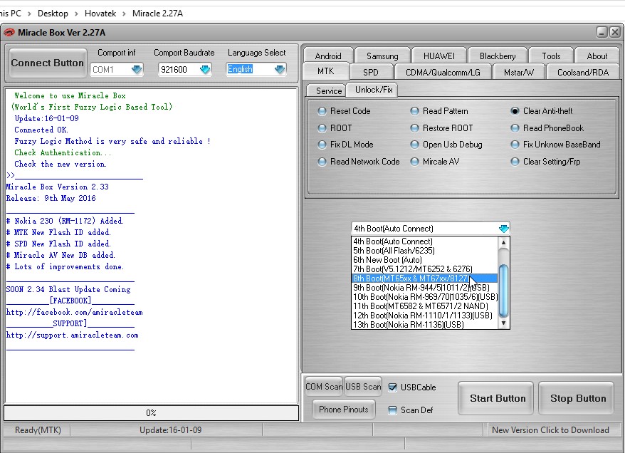

  6. Click the dropdown box and select your chipset type MT****
    [Image: Hovatek-How-to-bypass-privacy-protection...-Box-5.jpg]
  7. Click the Start Button
    [Image: Hovatek-How-to-bypass-privacy-protection...-Box-6.jpg]

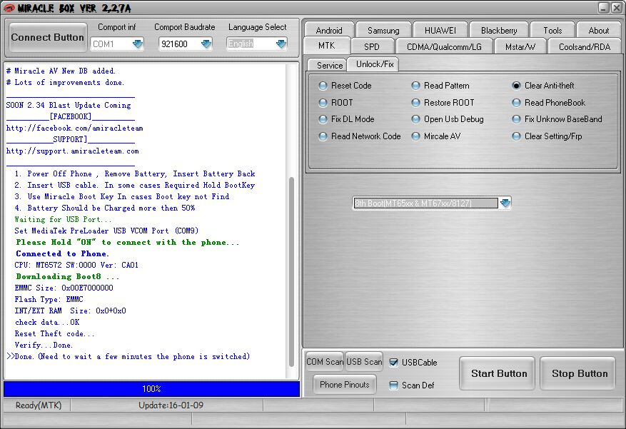

  10. Wait for the message ">>Done. (Need to wait a few minutes the phone is switched)"
    [Image: Hovatek-How-to-bypass-privacy-protection...-Box-8.jpg]
