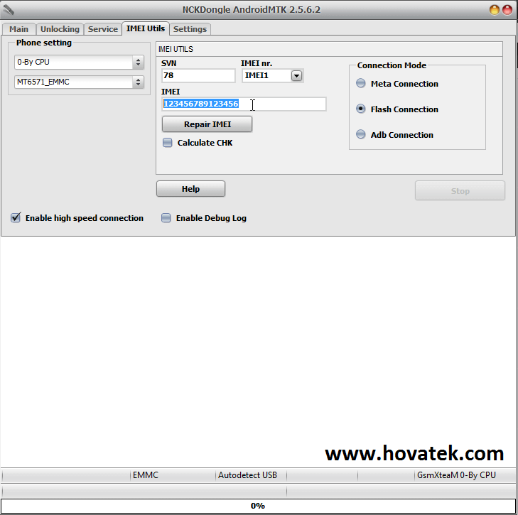

  1. Open NCK Module and Click on IMEI Utils
    [Image: how-to-write-imei-of-an-mtk-phone-using-nck-box-2.png]

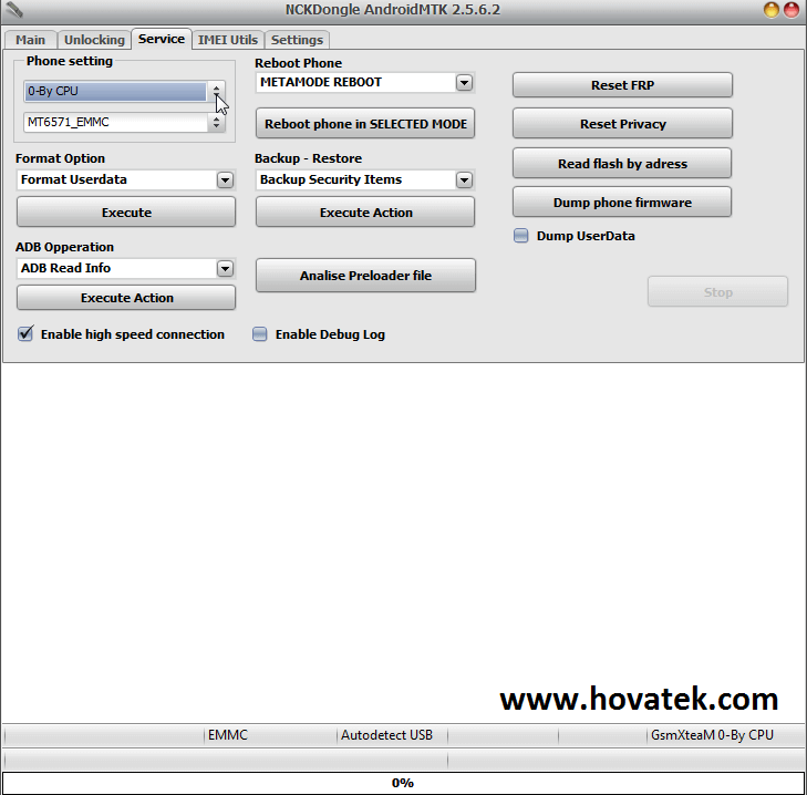

  2. Under Phone settings, leave the first dropdown as 0-by-CPU
    [Image: how-to-format-single-partition-of-an-mtk...-nck-3.png]
  3. Select your phone's chipset (MTxxxx) from the second dropdown
    [Image: how-to-format-single-partition-of-an-mtk...-nck-4.png]

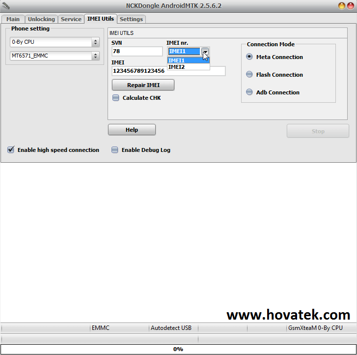

  4. Select which IMEI you will write, IMEI1 is for SIM 1 and IMEI 2 is for SIM2
    [Image: how-to-write-imei-of-an-mtk-phone-using-nck-box-3.png]

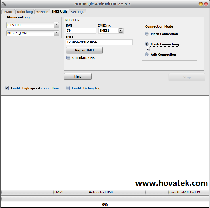

  6. Set connection mode as Flash Connection
    [Image: how-to-write-imei-of-an-mtk-phone-using-nck-box-4.png]

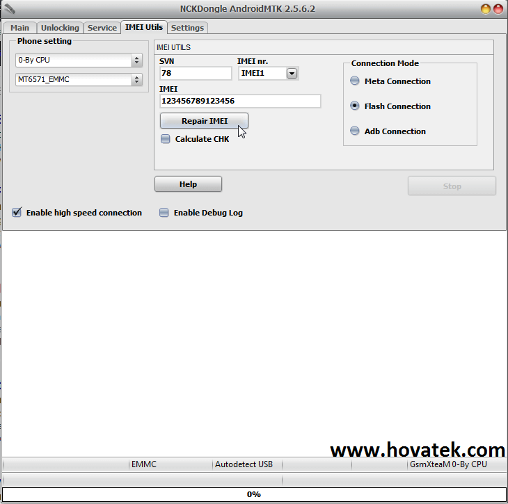

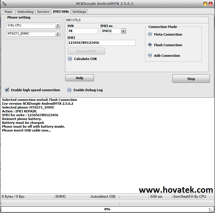

  7. Click Repair IMEI
    [Image: how-to-write-imei-of-an-mtk-phone-using-nck-box-6.png]

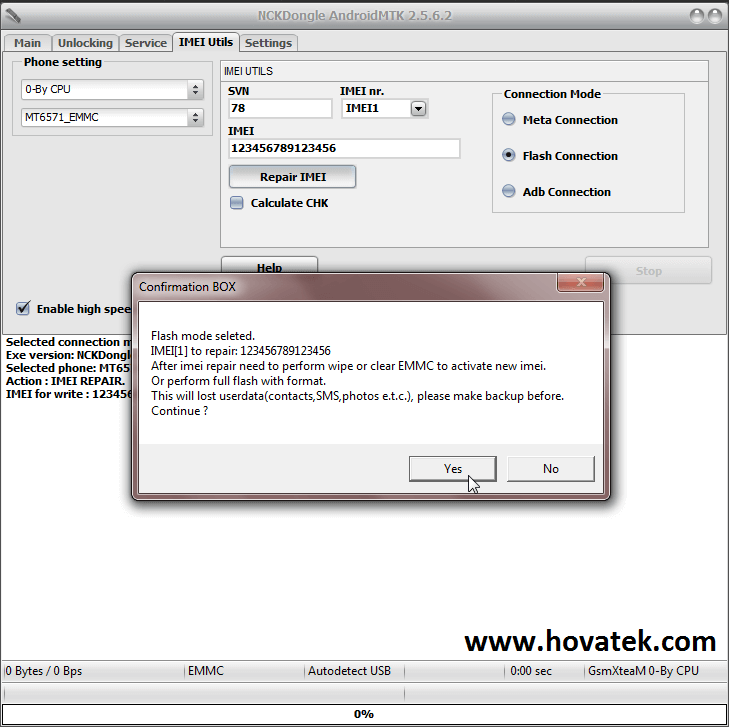

  8. A confirmation box will pop up to notify you that after writing IMEI you will need to factory reset via recovery mode or factory mode before the written IMEI will take effect. Click Yes
    [Image: how-to-write-imei-of-an-mtk-phone-using-nck-box-7.png]
  9. You will see Please insert USB cable now.., power off the phone (still with battery in), don't hold any button then connect a USB cord from PC to Phone
    [Image: how-to-write-imei-of-an-mtk-phone-using-nck-box-8.png]

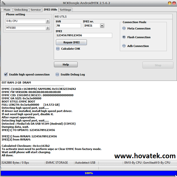

  10. You should see All Done
    [Image: how-to-write-imei-of-an-mtk-phone-using-nck-box-9.png]
