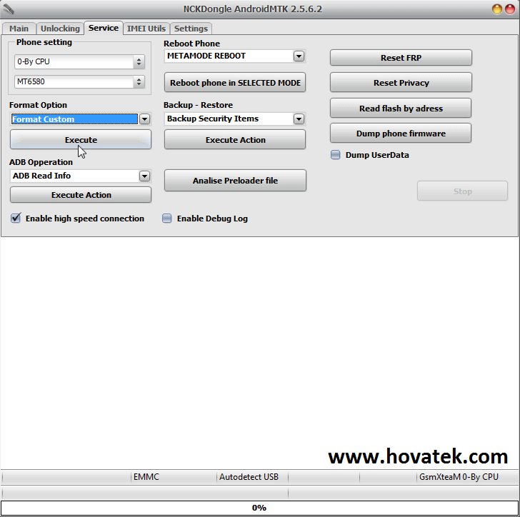

  5. Click Execute and Dialogue box will appear
    [Image: how-to-format-single-partition-of-an-mtk...-nck-6.png]

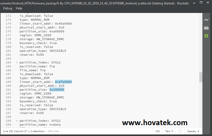

  6. Open your scatter file and scroll down the contents of the scatter file till you get to the partition you wish to format
    [Image: how-to-format-single-partition-of-an-mtk...-nck-8.png]
  7. Input the values of Linear_start addr and partition_size into format area then Click on Format
    Linear_start addr = Begin Address and Partition_size = Format Length
    [Image: how-to-format-single-partition-of-an-mtk...-nck-9.png]

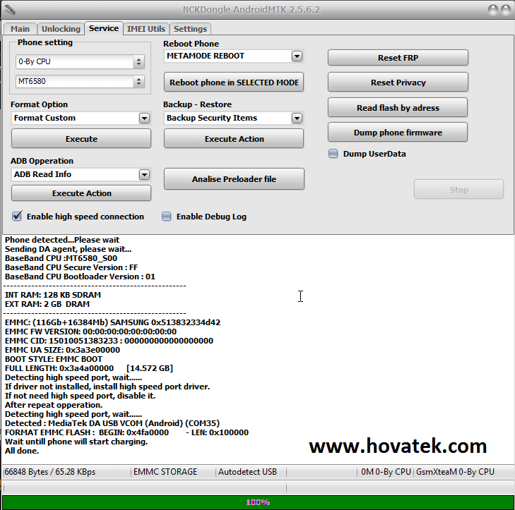

  8. You will see Please insert USB cable now.., power off the phone (still with battery in), don't hold any button then connect a USB cord from PC to Phone
    [Image: how-to-format-single-partition-of-an-mtk...nck-11.png]
  9. The device should get detected and start formatting the partition
    [Image: how-to-format-single-partition-of-an-mtk...nck-10.png]
