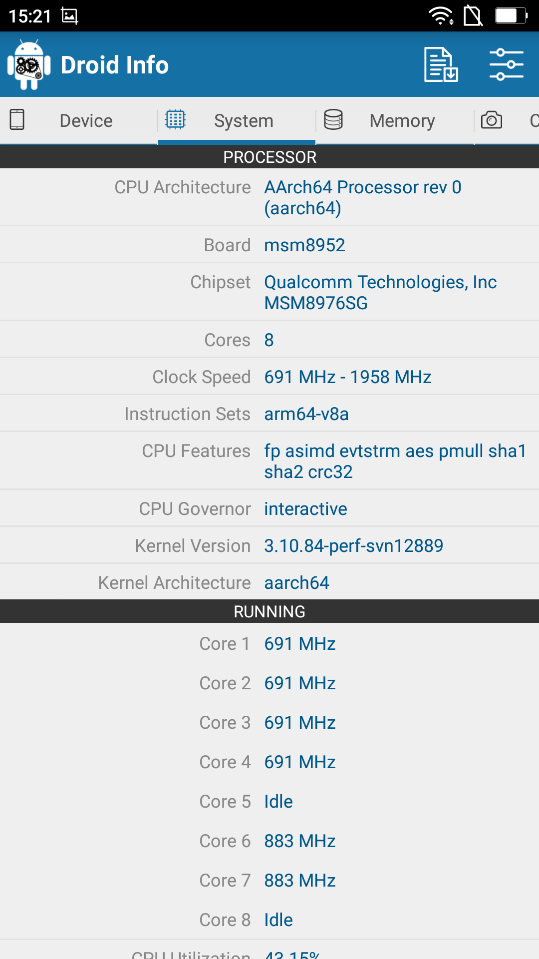

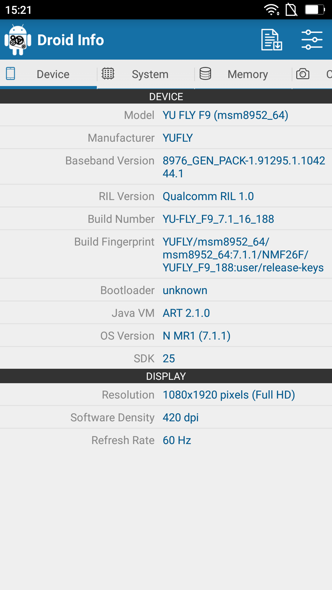

Hello, I've bought an Chinese brand phone model Yufly F9. But it doesn't have Google apps installed. I tried few installer but not working. So i guess it should be flashed through TWRP. Current system is android 7.1.1.
Device info:
CPU Architecture: AArch64 Processor rev 0 (aarch64)
Board: msm8952
Chipset: MSM8976SG
Instructions set: arm64-v8a
Kernel version: 3.10.84-pref-svn12889
Kernel architecture: aarch64
Please help me to install TWRP on this device.
I think bootloader is unlocked because i tried to earse userdata and it work.
Thanks
