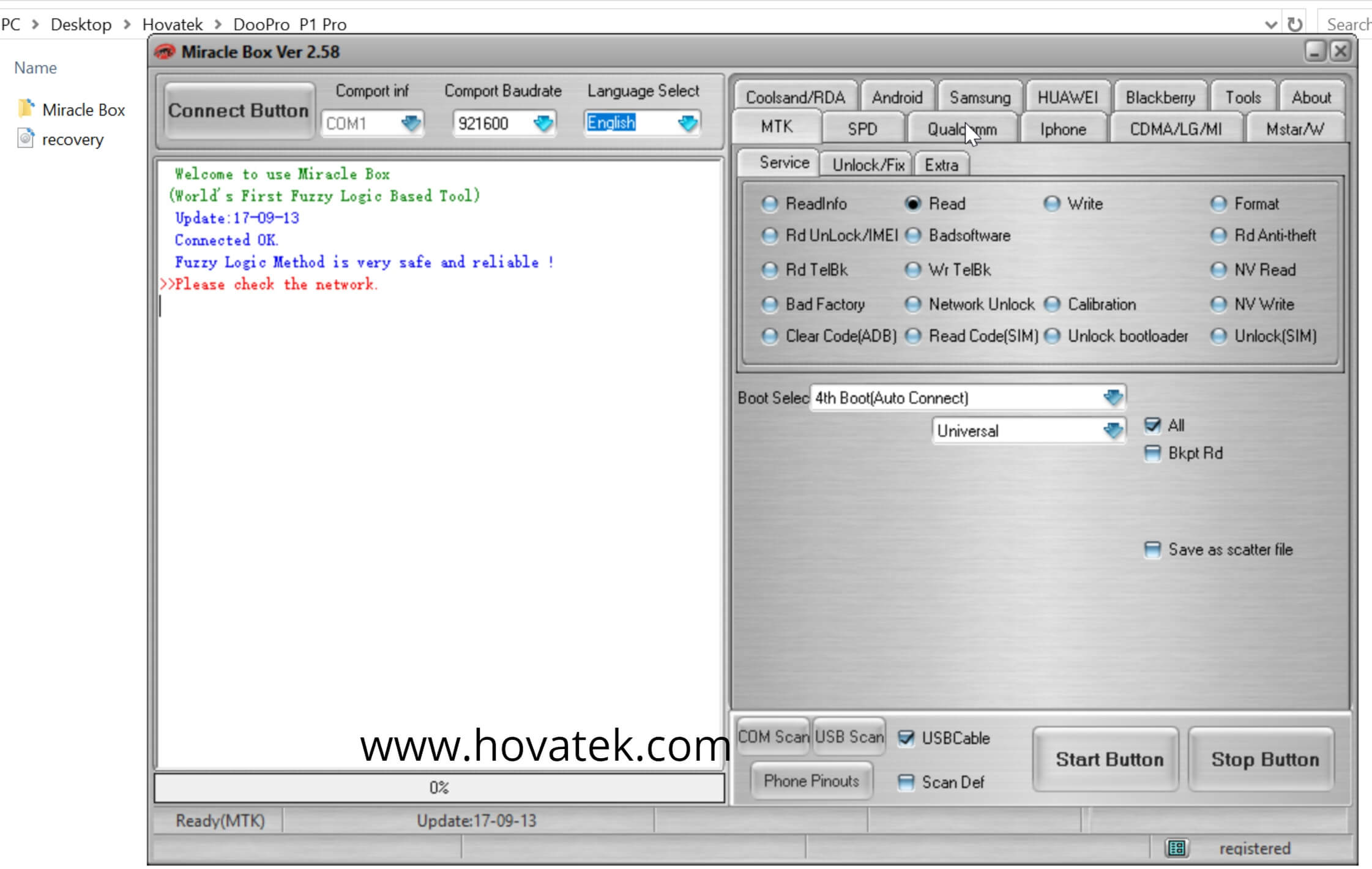

  1. Launch Miracle box and click the Qualcomm tab
    [Image: How-to-use-Miracle-Box-to-flash-a-single...comm-1.jpg]

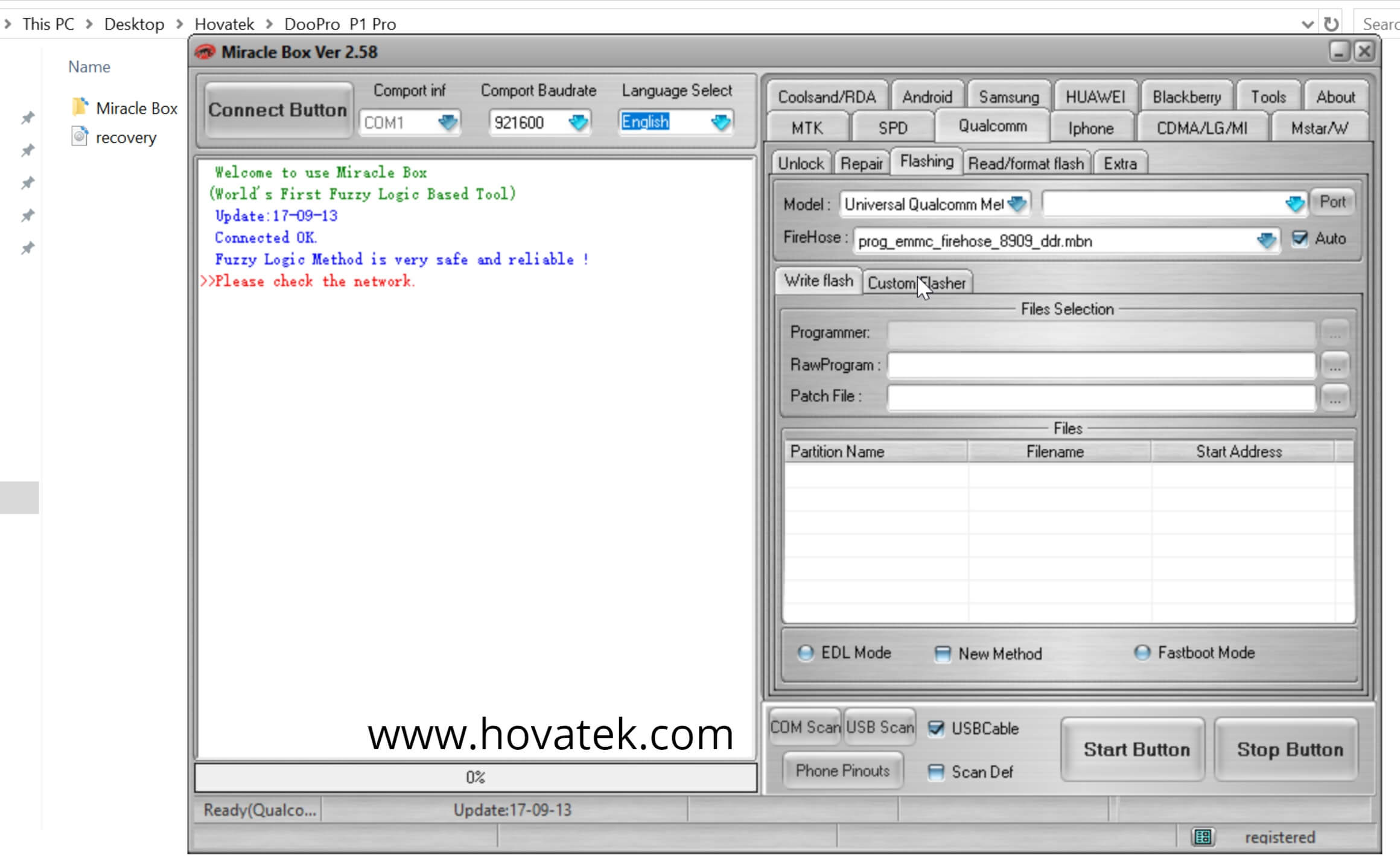

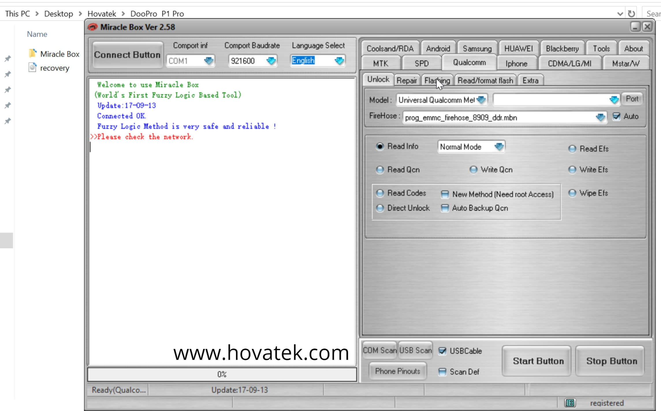

  2. Click the Flashing tab
    [Image: How-to-use-Miracle-Box-to-flash-a-single...comm-3.jpg]
  3. Click the Custom Flasher tab
    [Image: How-to-use-Miracle-Box-to-flash-a-single...comm-4.jpg]

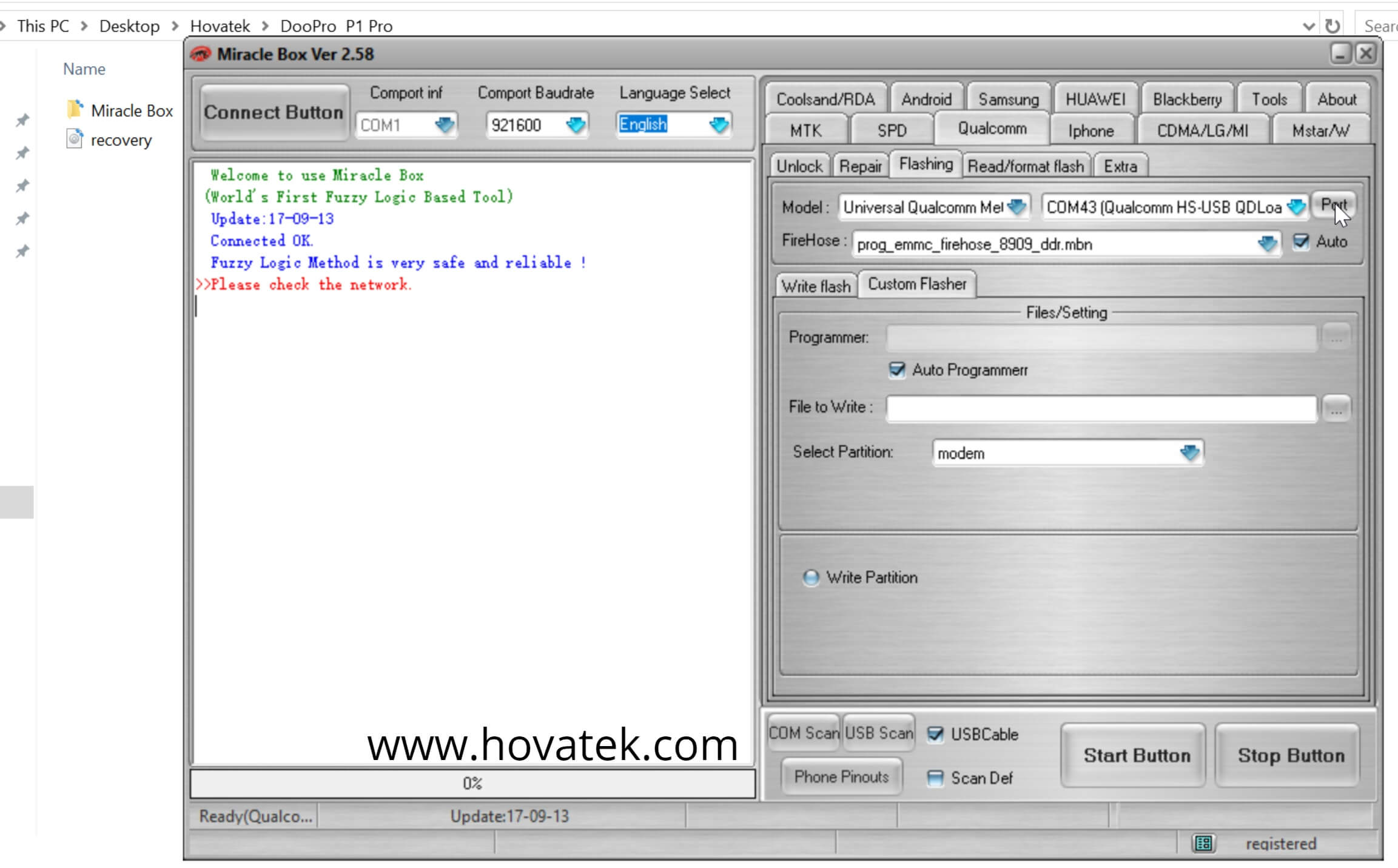

  4. Connect the Device to PC (via USB cord) while in Emergency Download (EDL) mode then click Port. It should get detected as Qualcomm HS-USB QDLoader 9008
    [Image: How-to-use-Miracle-Box-to-flash-a-single...comm-5.jpg]

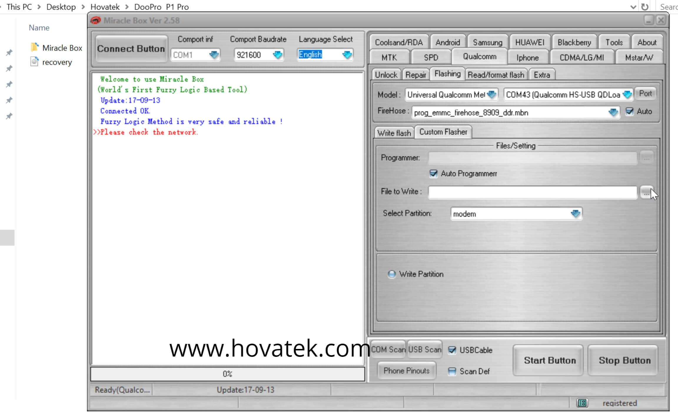

  5. Click the browse icon in front of File to Write
    [Image: How-to-use-Miracle-Box-to-flash-a-single...comm-6.jpg]

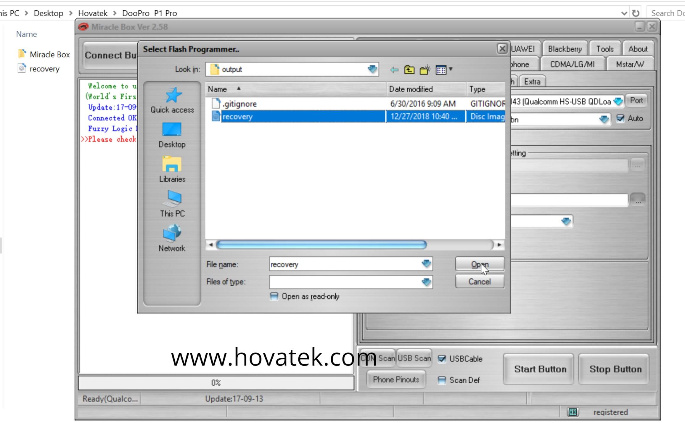

  6. Navigate to and highlight the file you wish to flash then click Open
    [Image: How-to-use-Miracle-Box-to-flash-a-single...comm-7.jpg]

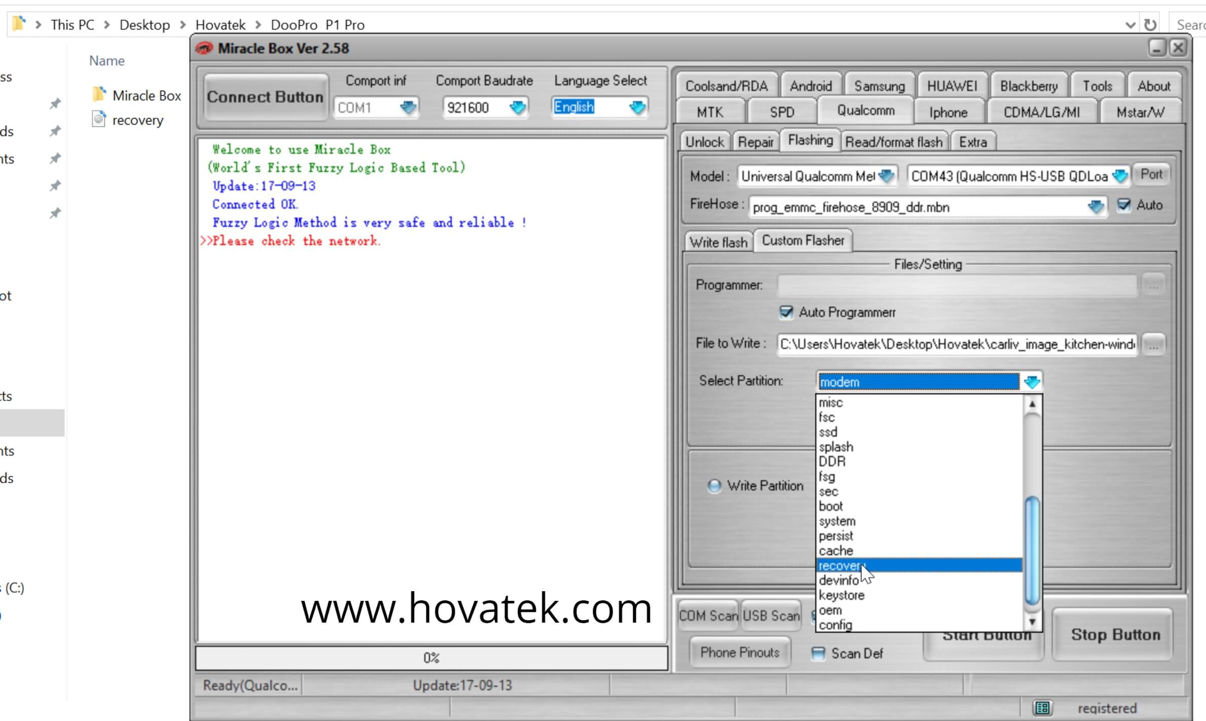

  7. Select the partition under the Select Partition dropdown
    [Image: How-to-use-Miracle-Box-to-flash-a-single...comm-8.jpg]

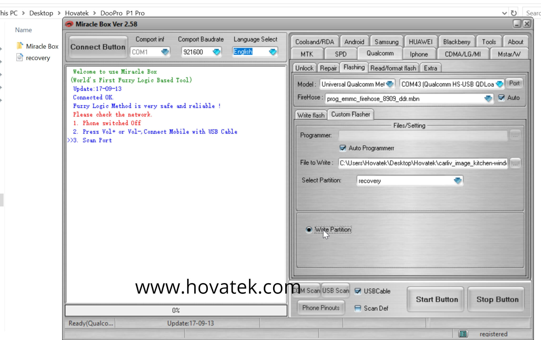

  8. Tick Write Partition
    [Image: How-to-use-Miracle-Box-to-flash-a-single...comm-9.jpg]

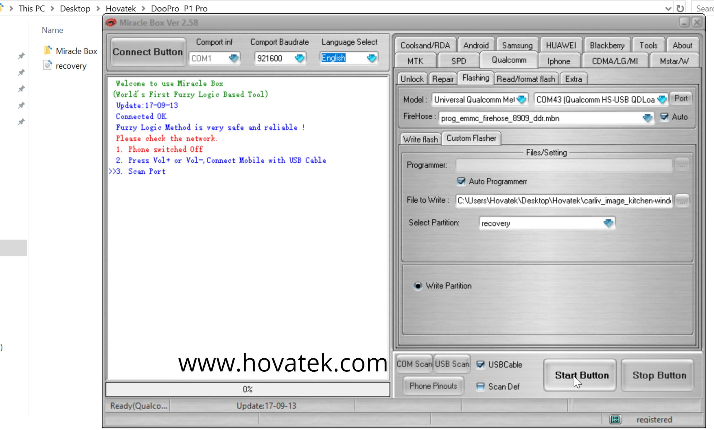

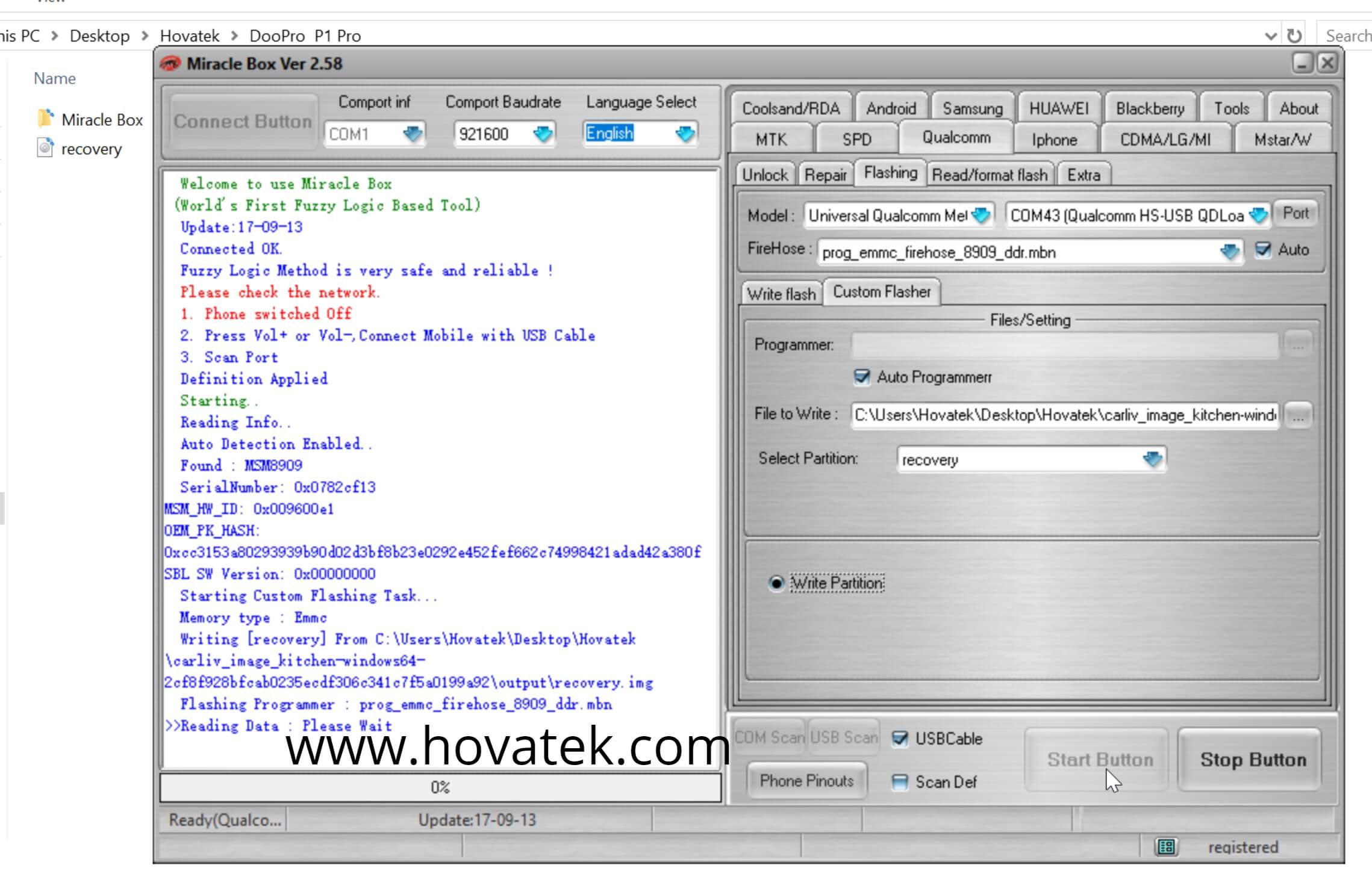

  9. Click Start Button
    [Image: How-to-use-Miracle-Box-to-flash-a-single...omm-10.jpg]

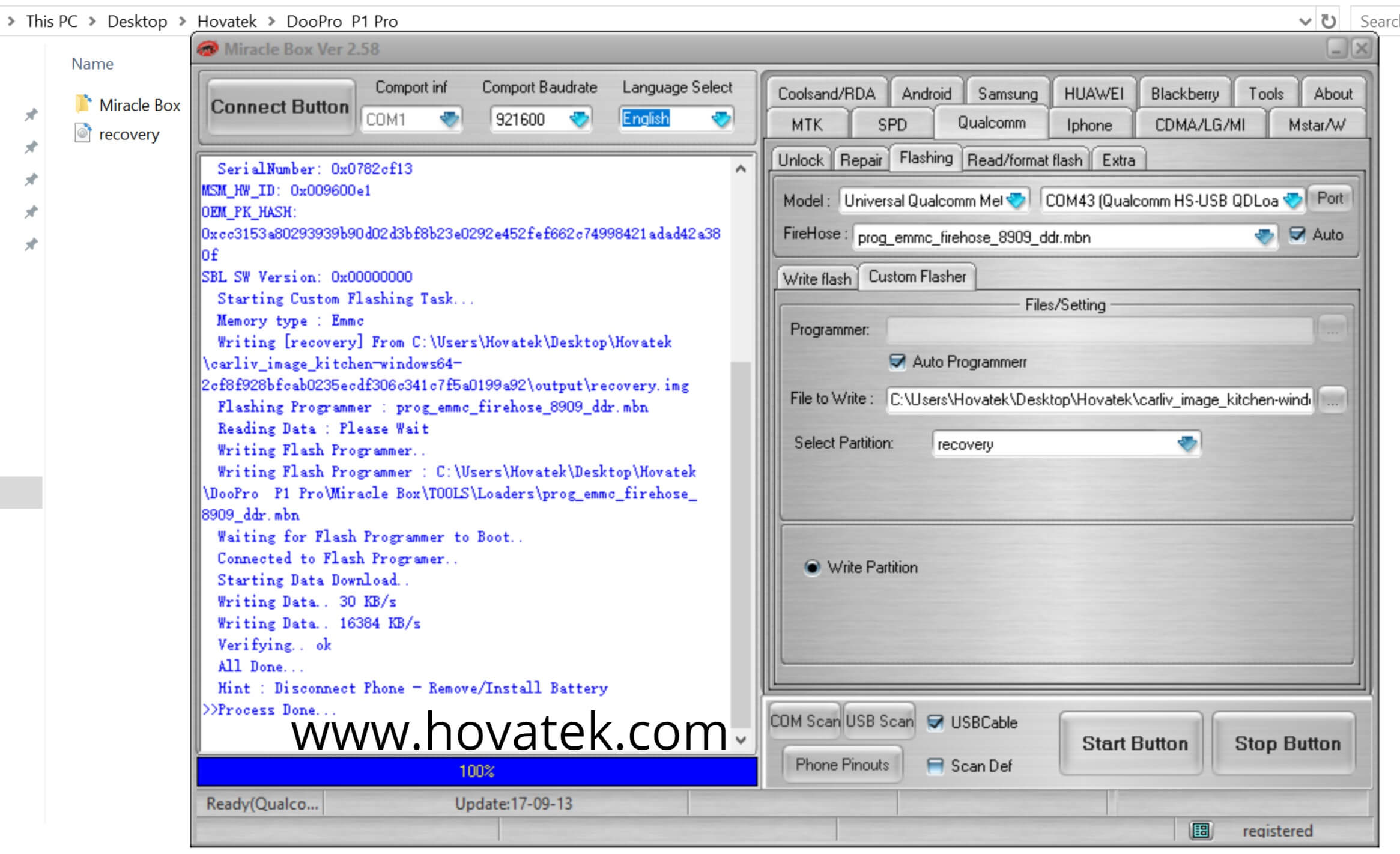

  10. Wait while Miracle box flashes the file
    [Image: How-to-use-Miracle-Box-to-flash-a-single...omm-11.jpg]
  11. You should see Process Done once completed
    [Image: How-to-use-Miracle-Box-to-flash-a-single...omm-12.jpg]
