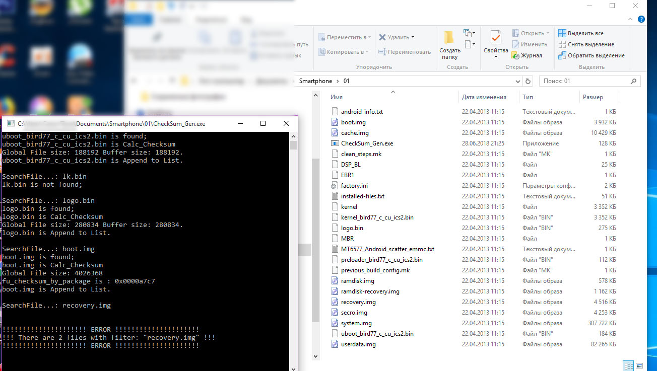

I have made as you have advised and there was a new error (see screenshot). But I don't see in the folder 2 identical files "recovery", though the program indicates it.
cut ramdisk-recovery.img out of the folder and retry generating the checksum.ini.

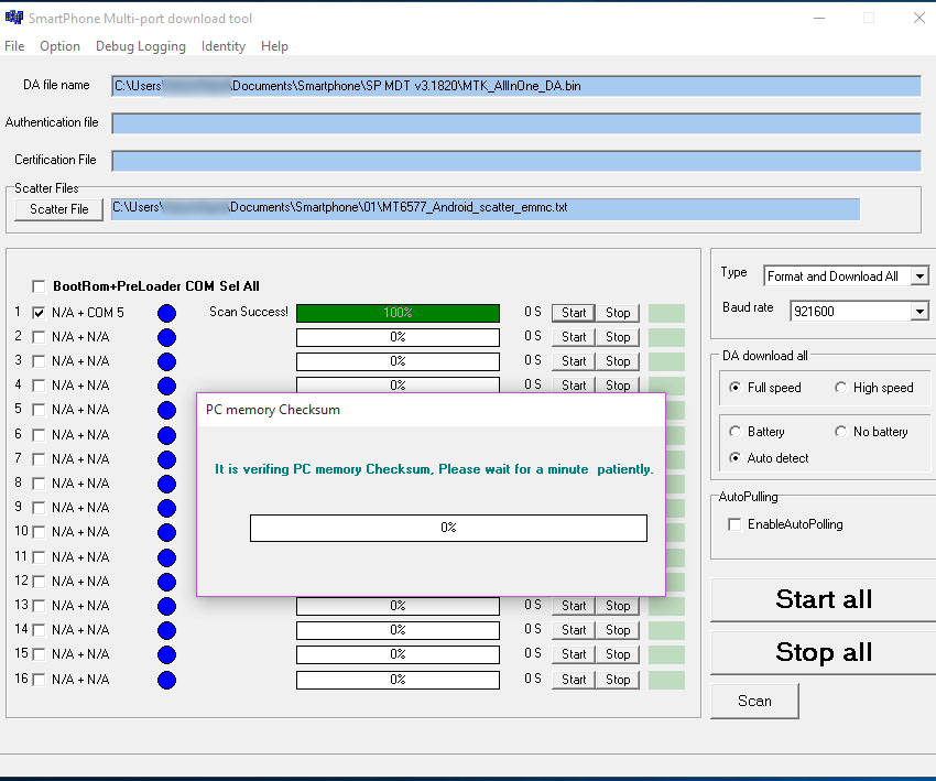

Yes, I have made this. The file "Checksum" has been created. But when I click on "Start" everything freezes (see sreenshot). Why?
This post was last modified: 22-08-2018, 01:08 PM by Alex5.
50,906
23-08-2018, 12:05 PM
(22-08-2018, 12:48 PM)Alex5 Yes, I have made this. The file "Checksum" has been created. But when I click on "Start" everything freezes (see sreenshot). Why?
