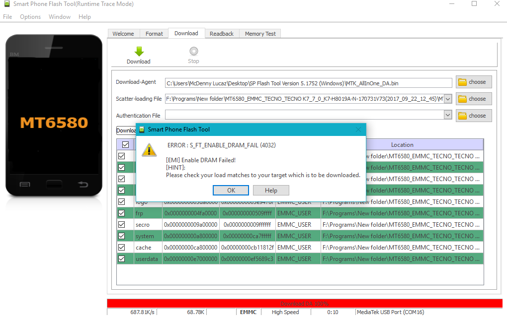

Today, accidentally went to format my TECNO K7 using SP flashing, and i formatted the bootloader too. Am trying to flash the original rom but it show ing the DRAM error Sad . I have attached the error screenshot.
Please i really need help

(10-05-2018, 08:21 AM)Oluka Denis Hello
Thanks
That's a mismatch error (refer to https://www.hovatek.com/forum/thread-439.html )
Ensure to download the firmware for your phone's original Build Number. You can check https://www.hovatek.com/forum/thread-20510.html

bad emmc or nand some mtk phones will not accept any firmware after format, never format any new mtk phones just download the firmware
for your problem
just try different version of the rom using different version of spflash tool
