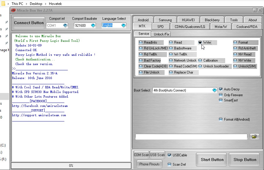

Quote:In this video tutorial, I'll be showing you how to flash a Miracle Box dump in scatter format using Miracle Box You're going to need your Mediatek VCOM drivers (which I have here), Miracle Box & Miracle Box dump (firmware) What I mean by Miracle Box dump is a backup made in scatter format using Miracle Box. After making backup, I'm going to show you how to flash the same backup to the phone using Miracle. For this tool, you'll need drivers. If you're using Windows 8 and above, its very important to disable your driver signature verification on your PC. We already have a guide on how to do that on our website, use the search bar at the top.
I've done that on this PC, Make sure you do that before you proceed. Once that is done, you install VCOM drivers To do that, press the Window button and type "Device Manager". You're going to launch device manager Under device manager, you can just highlight any item on the list. I'm highlighting the first item Click on Action - Add legacy hardware - Next - Tick Install hardware that I manually select from a list - Next - Next - Have Disk - Browse - Locate the folder where your Mediatek VCOM drivers are. Open the Drivers folder USB VCOM Driver.
If yours is Windows 7 and above, you open the Win7 folder else select according to yours Mine is a Windows 10, I'll open the Windows 7 folder. Now, I have the option of 32 or 64 bit You need to know your PC's system type. To do that, right-click on My Computer or This PC - Properties Under System Type, I have 64 bit operating system. I select the 64 bit option here and click Open Click OK - Highlight Mediatek Preloader USB VCOM Port - Click on Next - Next - Wait while the driver is installed.
You might have this device cannot start (code 10) error. its nothing to worry about. You're getting it because you've installed an unsigned driver. Click Finish. You might notice the yellow icon here. Nothing to worry about. Doesn't mean drivers will not work. Now that drivers are installed, its time to go ahead with flashing You need to open the Miracle Box folder. Its important you disable your antivirus temporarily (if using Loader) Launch your Miracle box (I'm using the loader version). You might have a grayed out or inactive start button. If you find yourself in that situation, its nothing to worry about. We have a guide on how to fix that. Head over to the Hovatek website, use our search bar. Type "How to fix miracle box inactive start button" in a few seconds, you'll be done with that. I've had mine fixed so I'm going to go ahead with flashing.

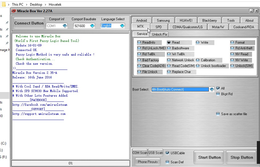

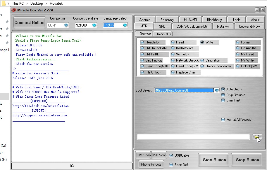

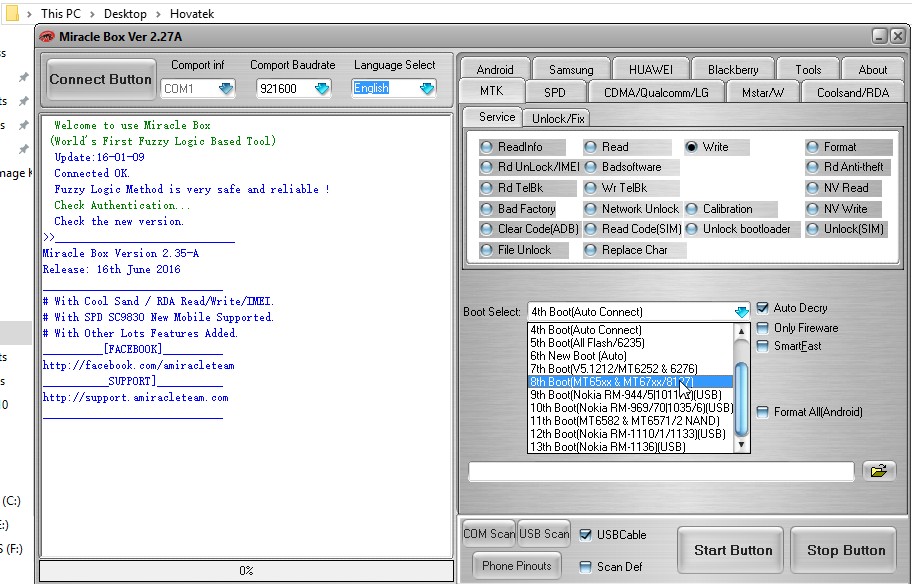

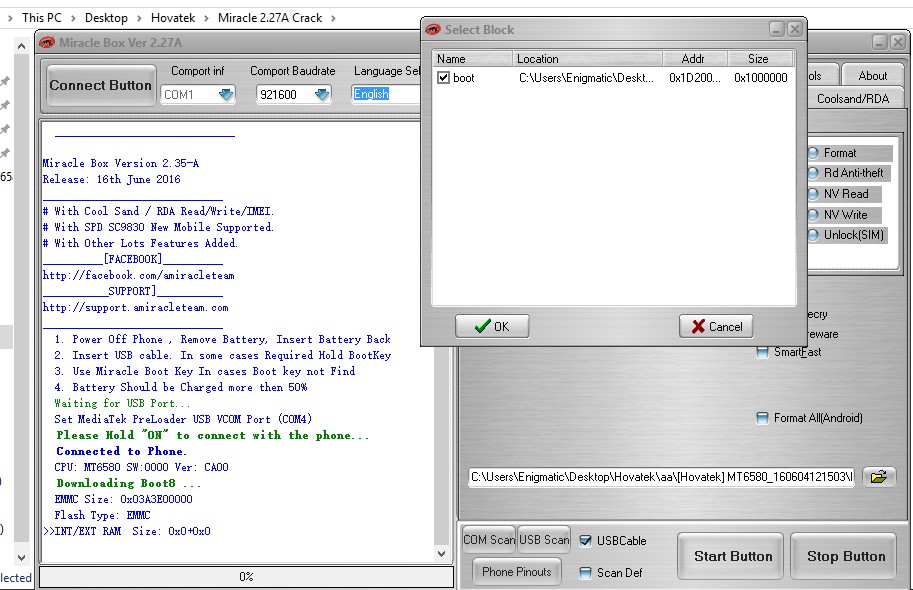

Make sure you have the MTK tab ticked then tick Write. If you don't know your chipset, select 4th boot mine is MT6580 so I select 8th boot. Do not tick format all unless you know what you're doing Click on this folder icon. Navigate to the locaiton where your Miracle Box dump is, select Scatter & click Open. Once that is done, click on your Start button then wait till Miracle box shows Waiting for USB Port.. At this point, you're ready to connect the device. You power off your Mediatek phone, battery charged & inside Don't press any button at all. Connect it to the PC via USB cord and wait.
You'll have a popup asking you to select what you want to flash. If you're flashing a full firmware, you'll have a very long list & need to tick the partitions you intend to flash. I intend to flash just preloader & LK. Its very important you tick preloader because on some chips, you'll get an error if you don't tick preloder. Make sure its for your own phone Then click OK and wait for flashing. Alright! Flash is done and I have Write Done. I can disconnect the phone and power it up.
