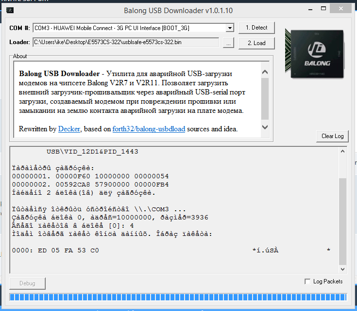

Pls i tried to flash HUAWEI E5573Cs-322 with balong usb loader but i always get this message. the flash doesnt seem to work.
i have installed all necessary driver. but still doesn't work.
please help me out gurus.
COM3 - HUAWEI Mobile Connect - 3G PC UI Interface [BOOT_3G]
       USB\VID_12D1&PID_1443&REV_0001
Ïàðàìåòðû çàãðóçêè:
00000001. 00000F60 10000000 00000054
00000002. 00592CA8 57900000 00000FB4
Íàéäåíî 2 áëîêà(îâ) äëÿ çàãðóçêè.
Ïûòàåìñÿ îòêðûòü óñòðîéñòâî \\.\COM3 ...
Çàãðóçêà áëîêà 0, àäðåñ=10000000, ðàçìåð=3936
Âñåãî ïàêåòîâ â áëîêå [0]: 4
Ìîäåì îòâåðã ïàêåò êîíöà äàííûõ. Îáðàç ïàêåòà:
0000: ED 05 FA 53 C0                                   *í.úSÀ           *
49,610

you need to explain what you mean by "the flash doesn't seem to work"
also whats your device firmware version?
and i noticed you used usbsafe not covered in our guide

what i mean is that after putting the modem in boot shot pin method, i selected the the usbloader file and then i clicked on load button, but it doesnt seem to flash properly. the progress bar is meant to move bit by bit, but that doesn't happen on my own. the bar just loads completely fast. i even tried other usb loader files but no success. my modem is MTN Huawei E5573Cs-322.
My purpose of doing this is that i have exhausted the unlock attempts and cant seem to type the unlock code.

Hello Iken99, note that if your router counter is at zero you won't be able to flash bin file into the modem. So, for you to unlock the modem using balong usb loader, it needs to have atleast one unlock attempt left.
Hope that helps.

this unlock method that involves bootshot and flashing loader doesn't work on devices using latest SW version. you might have seen it if you went through the guide at https://www.hovatek.com/forum/thread-16772.html
