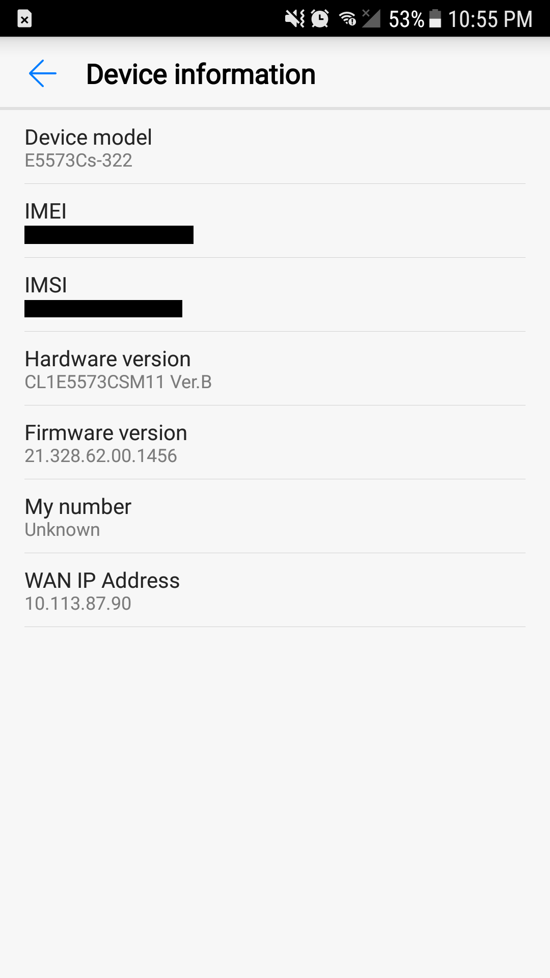

  1. Visit the original interface and take note of details of the MiFi device (e.g SN, IMEI, Network APN / Profile settings etc)

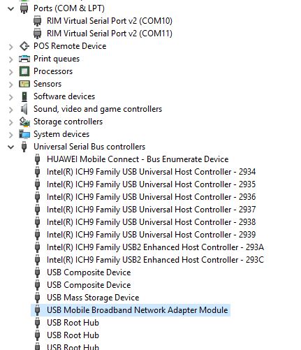

  3. Extract the Swift-E5775 iso using 7zip then run Autorun.exe or setup.exe in MobileWIFI folder (it will install the necessary drivers)

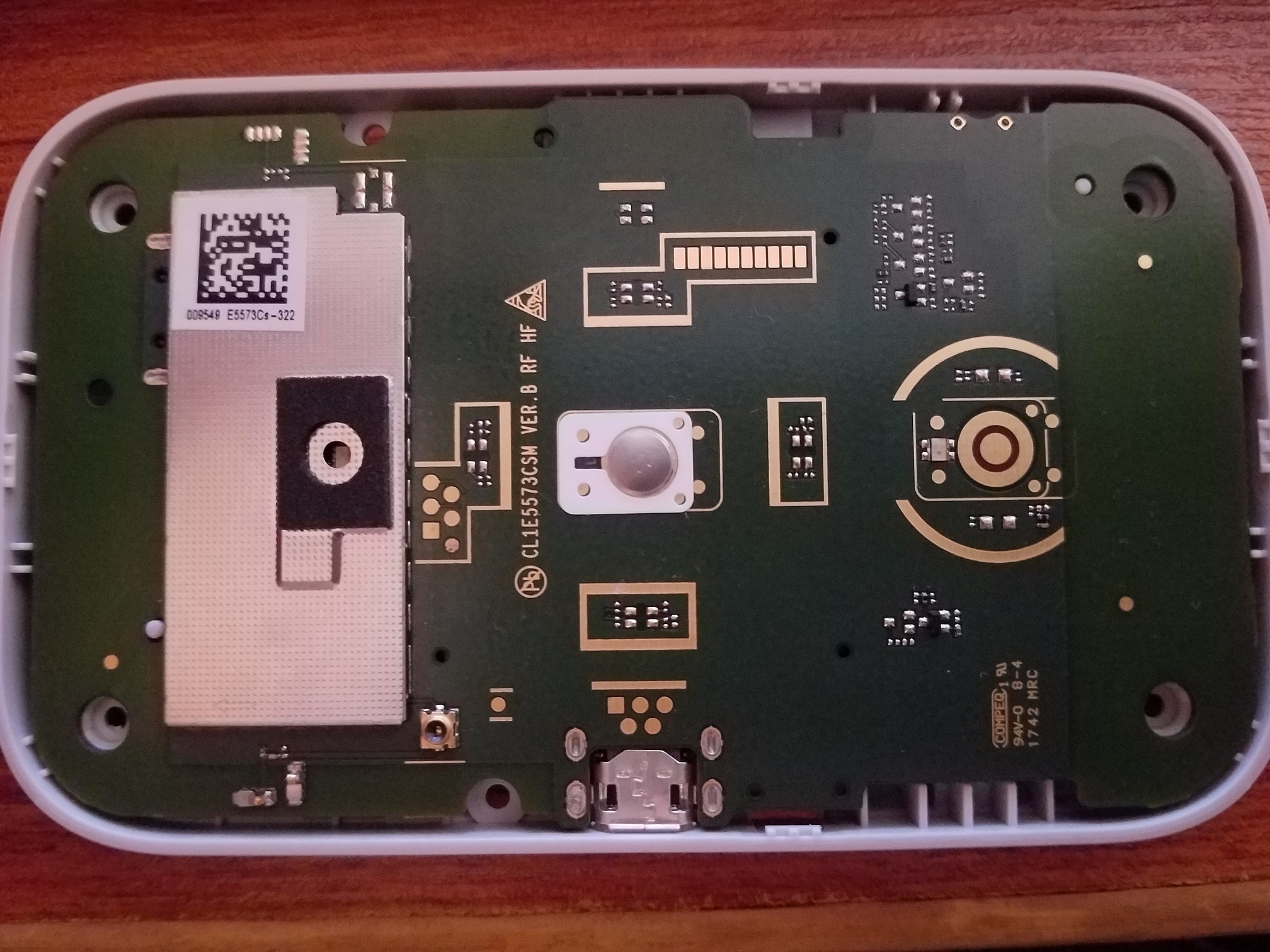

  4. Dismantle the device down to the motherboard
    [Image: How-to-Unlock-MTN-E5573Cs-322-Mifi-3-1.jpg]
  5. Connect the battery but don't power on the device
  6. Boot shot the device by touching the wire to the two points in the image below
    [Image: How-to-Unlock-MTN-E5573Cs-322-Mifi-4.jpg]

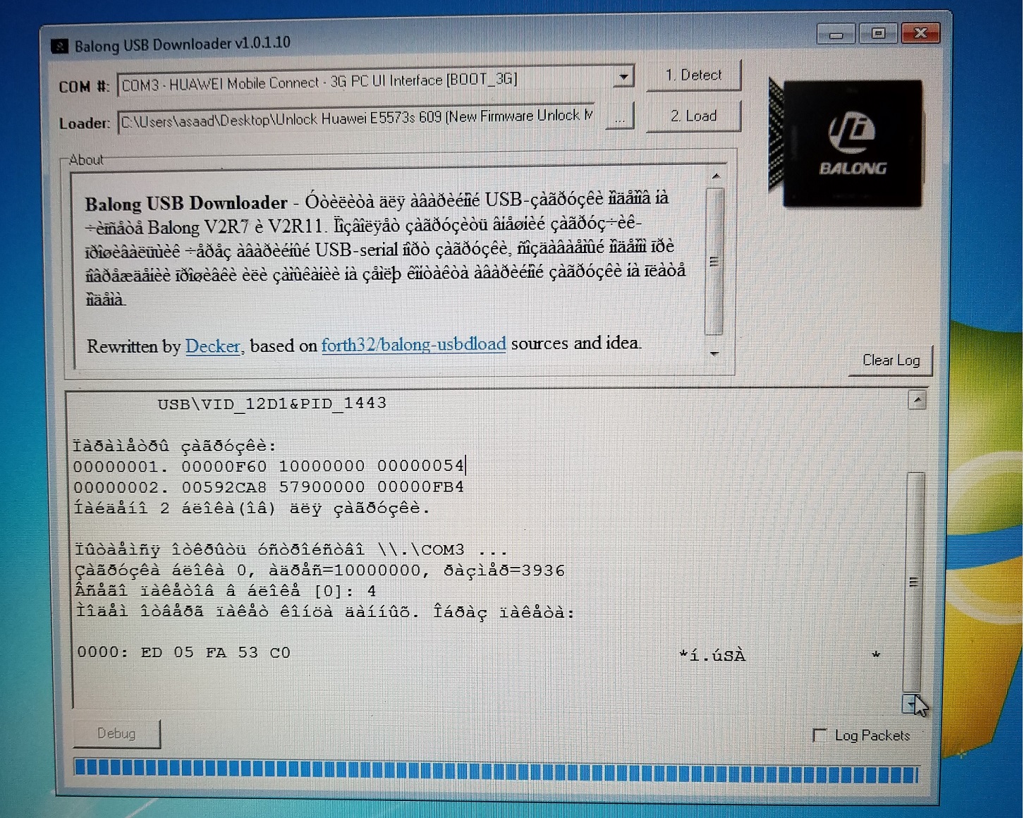

  8. Launch balong USB downloader
    [Image: How-to-Unlock-MTN-E5573Cs-322-Mifi-5.jpg]
  9. Click on detect > the device should be detected and labeled
    [Image: How-to-Unlock-MTN-E5573Cs-322-Mifi-6.jpg]

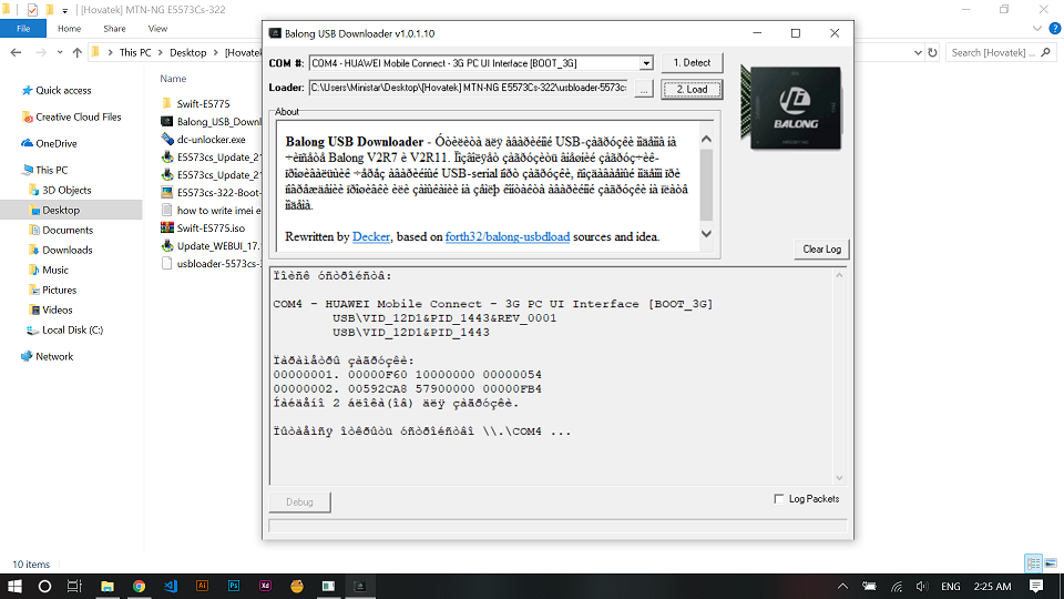

  10. Click on the small box labeled as "...", in the new window that opens, locate the usbloader-5573cs-322.bin (or E5573cs-921_usbloader if you have the Cs-931 model) file and select it
    [Image: How-to-Unlock-MTN-E5573Cs-322-Mifi-7.jpg]
  11. Click on Load and allow the procedure to complete.
    [Image: How-to-Unlock-MTN-E5573Cs-322-Mifi-8.jpg]

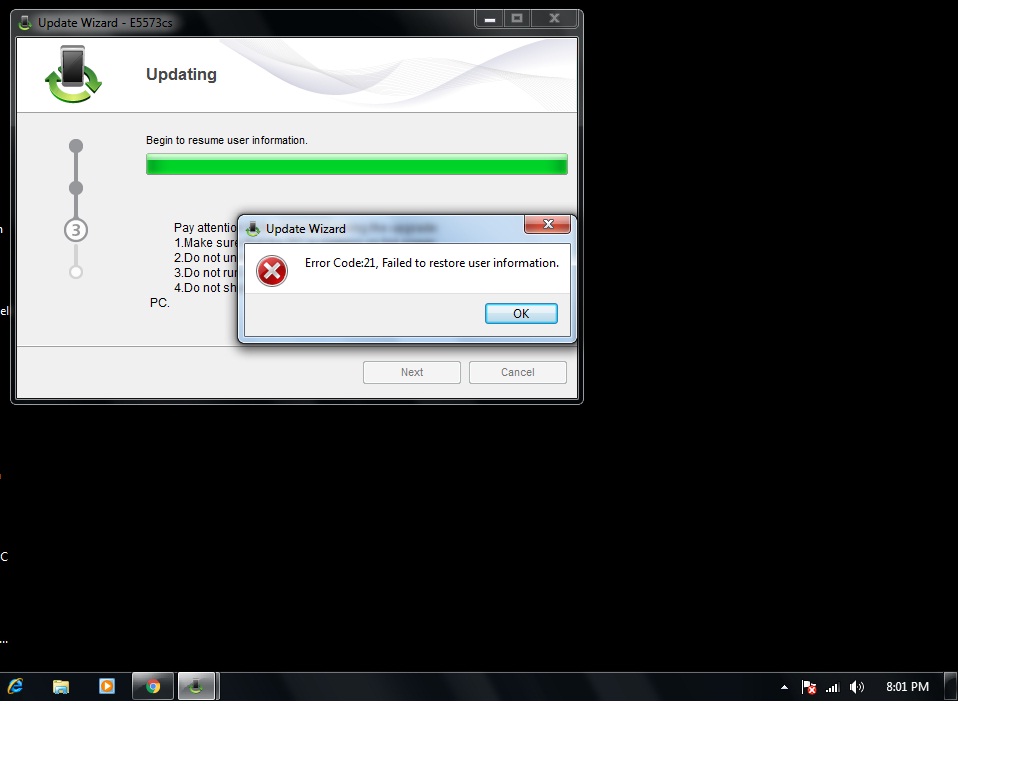

i attachment the picx i got this error in the end and my device light is off  .. like a died please help me
04-04-2017, 11:57 AM
(03-04-2017, 04:04 PM)renoos i attachment the picx i got this error in the end and my device light is off  .. like a died please help me
if you got the user information error, then nothing should be wrong with your device.
you might want to consider charging the battery of the device
