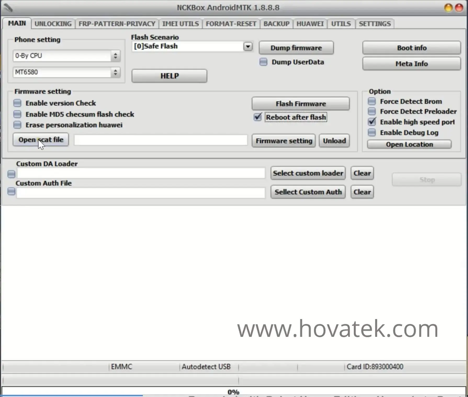

  1. Launch NCK Pro Box MTK Module
    [Image: How-to-flash-a-Mediatek-Android-phones-f...Box-1.webp]
  2. Under Main > Phone setting,  select your phone's chipset
    [Image: How-to-flash-a-Mediatek-Android-phones-f...Box-2.webp]

  5. Click Open scat file
    [Image: How-to-flash-a-Mediatek-Android-phones-f...Box-5.webp]
