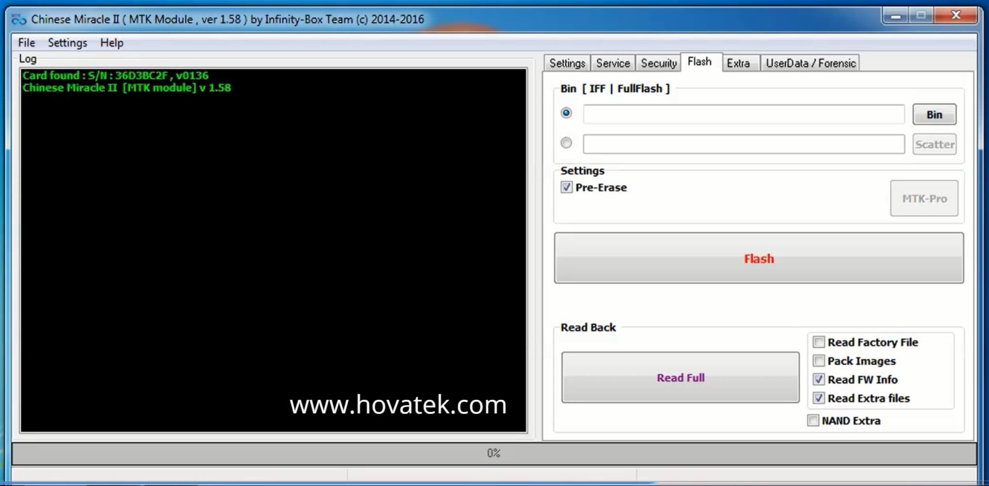

  3. Click the Flash tab
    [Image: How-to-backup-a-Mediatek-Android-phones-...-MTK-3.jpg]

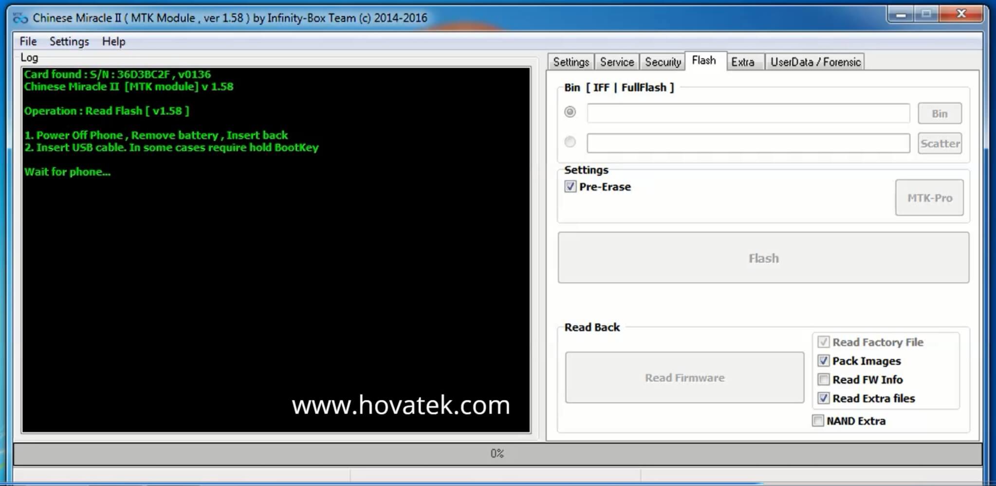

  4. Tick the boxes (in front of the Read Firmware button) based on how you intend to backup then click Read Firmware
    [Image: How-to-backup-a-Mediatek-Android-phones-...-MTK-4.jpg]
  5. Once you see Wait for phone... , power off the phone (still with battery inside) then connect to PC via a USB cord
    [Image: How-to-backup-a-Mediatek-Android-phones-...-MTK-5.jpg]

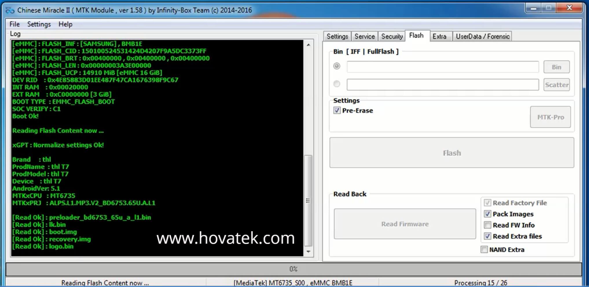

  8. CM2 MTK should strart backing up the phone's partitions, do not interrupt
    [Image: How-to-backup-a-Mediatek-Android-phones-...-MTK-8.jpg]
  9. Once backup is complete, you should get a Done message
    [Image: How-to-backup-a-Mediatek-Android-phones-...-MTK-9.jpg]
