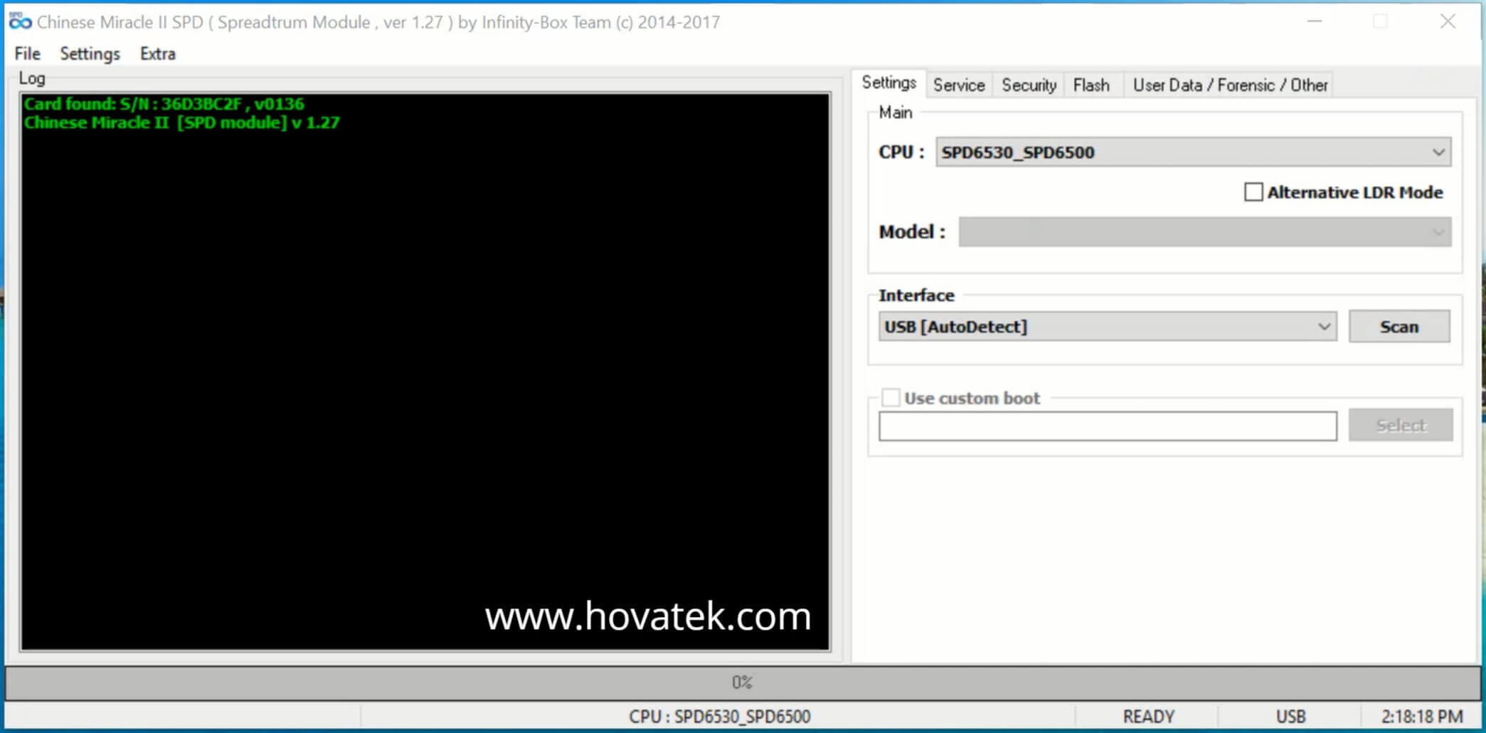

  2. Under the Settings tab > CPU , select your phone's chipset (to know your SoC, refer to https://www.hovatek.com/forum/thread-13054.html )
    [Image: How-to-backup-a-Spreadtrum-Android-phone...dule-2.jpg]

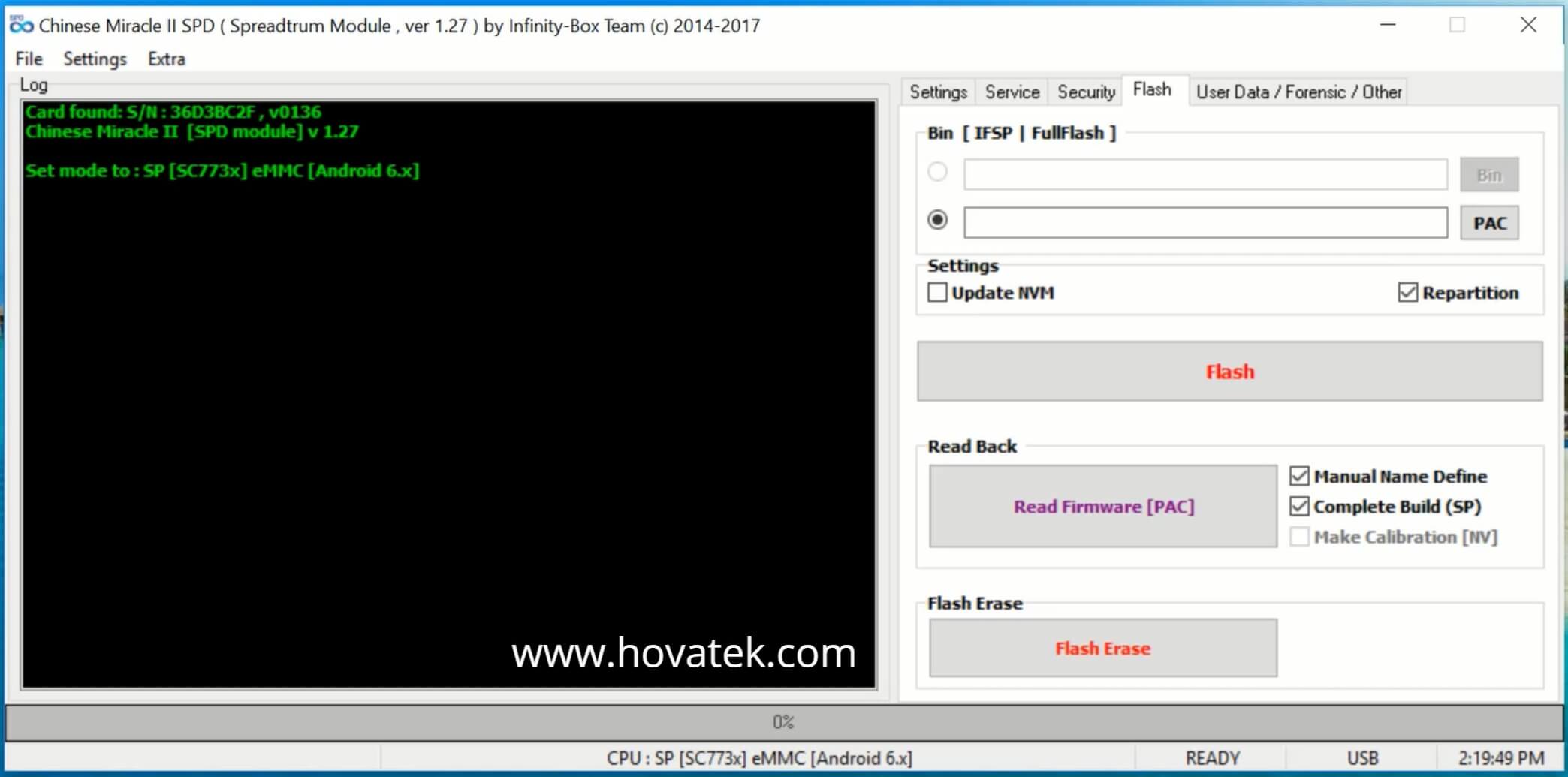

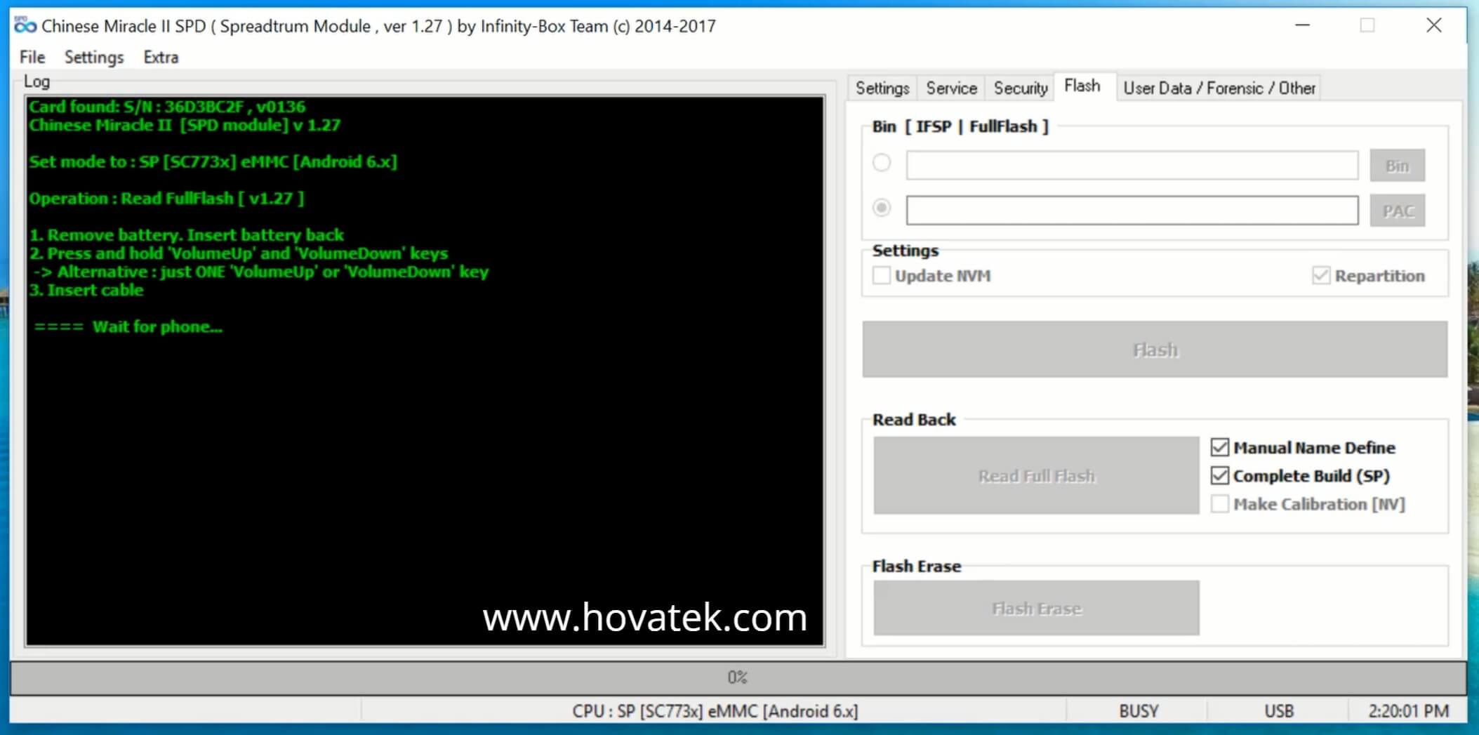

  3. Click the Flash tab (you can untick Manual Name Define) then click Read Firmware [PAC]
    [Image: How-to-backup-a-Spreadtrum-Android-phone...dule-3.jpg]
  4. Once CM II SPD shows ====Wait for phone... , power off the Spreadtrum phone (still with battery in) , hold the Volume down (decrease) button then connect to PC
    [Image: How-to-backup-a-Spreadtrum-Android-phone...dule-4.jpg]

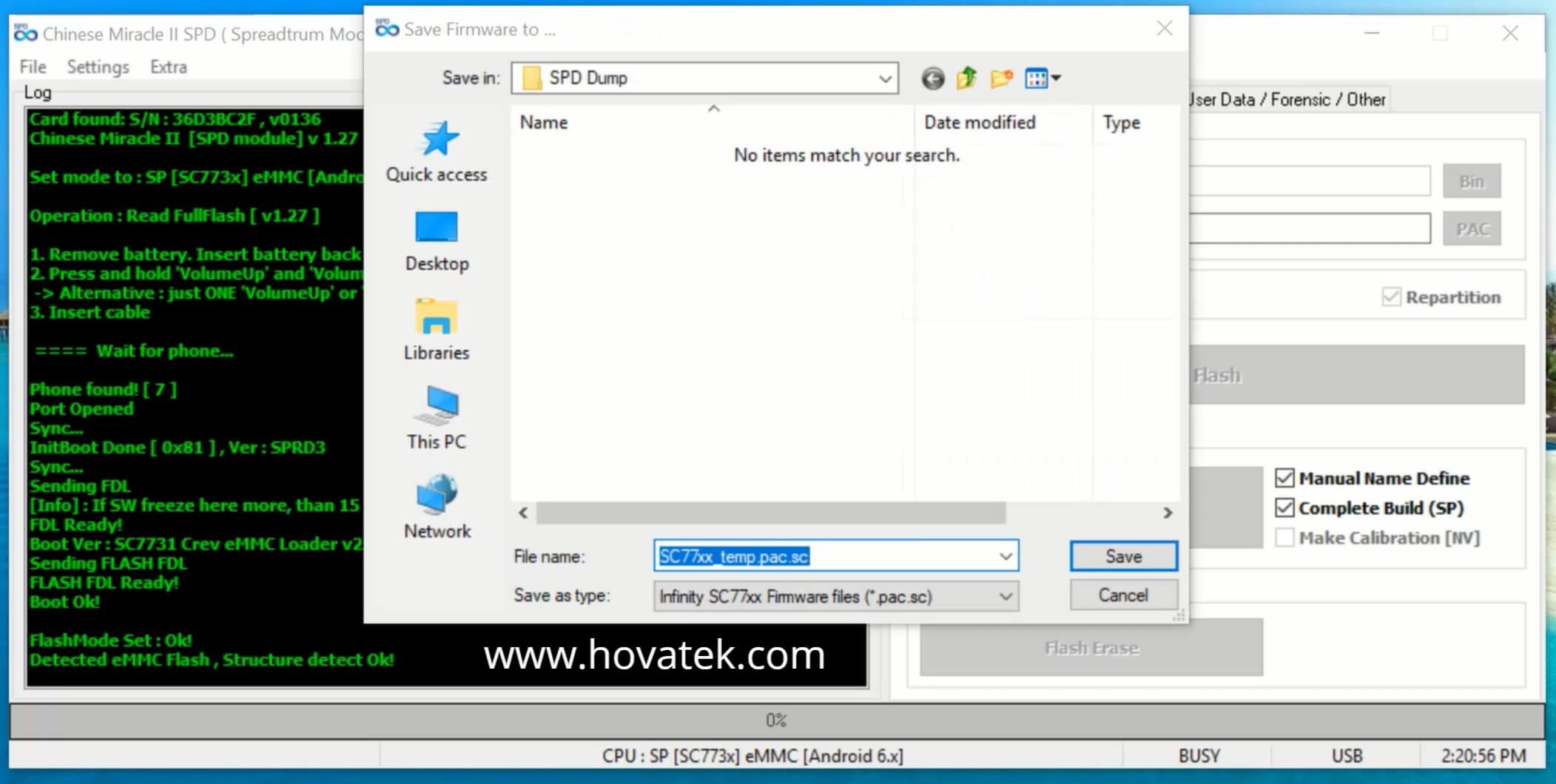

  6. In the Window that pops up, navigate to the location you wish to save the SPD backup then click Save
    [Image: How-to-backup-a-Spreadtrum-Android-phone...dule-6.jpg]

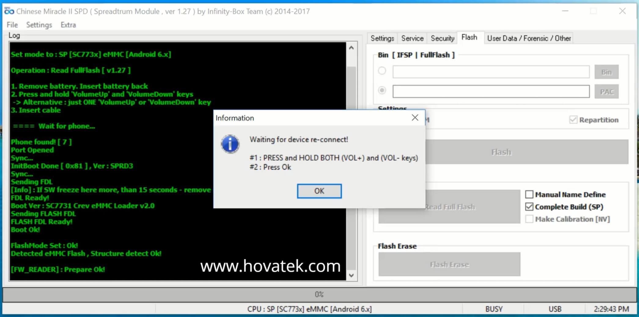

  7. If you get a Waiting for device re-connect! prompt, click OK while still holding the volume down button
    [Image: How-to-backup-a-Spreadtrum-Android-phone...ule-11.jpg]

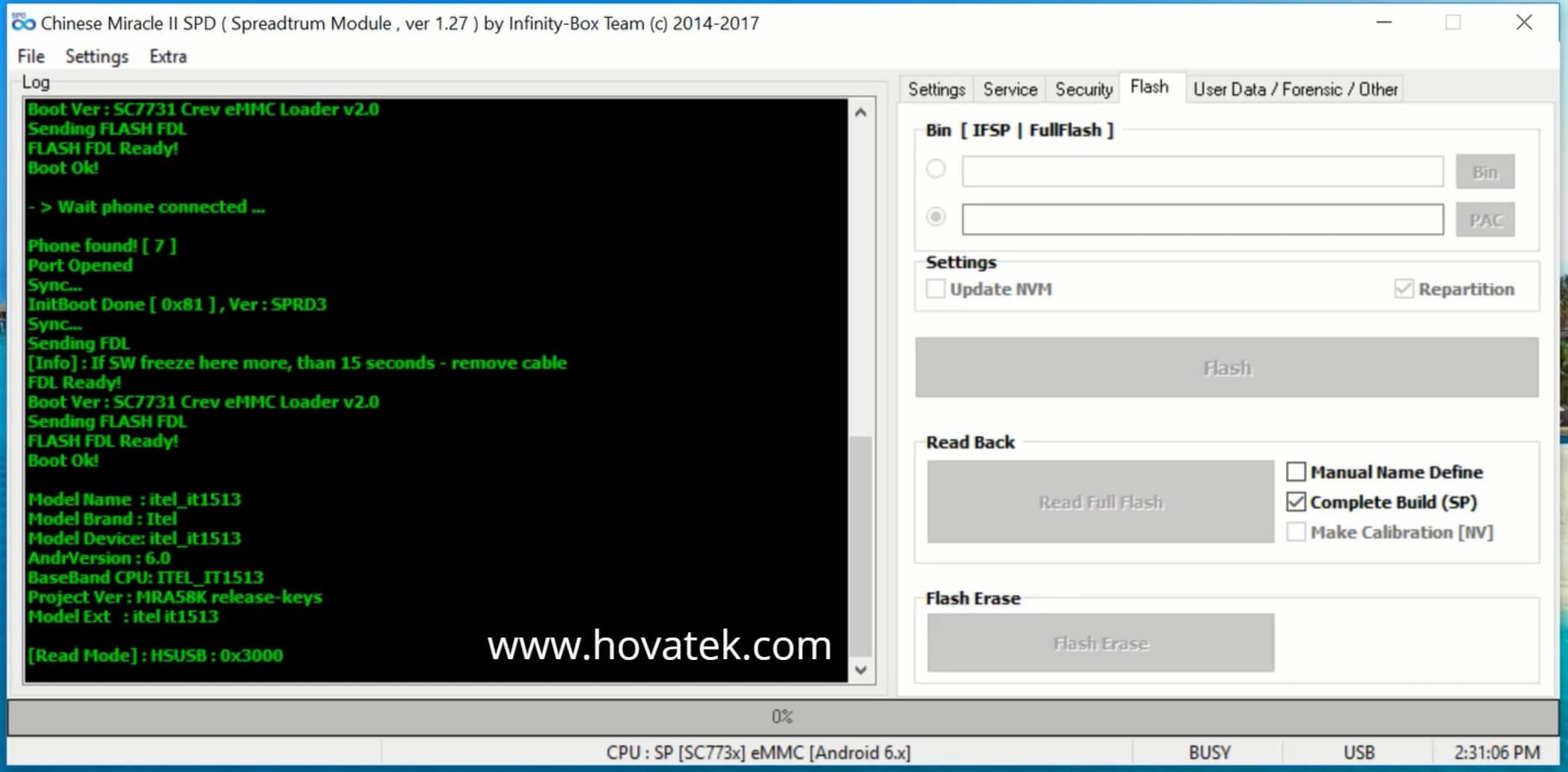

  8. Repeat the previous step till the phone's details gets displayed (Brand, Model, Android version etc)
    [Image: How-to-backup-a-Spreadtrum-Android-phone...dule-7.jpg]

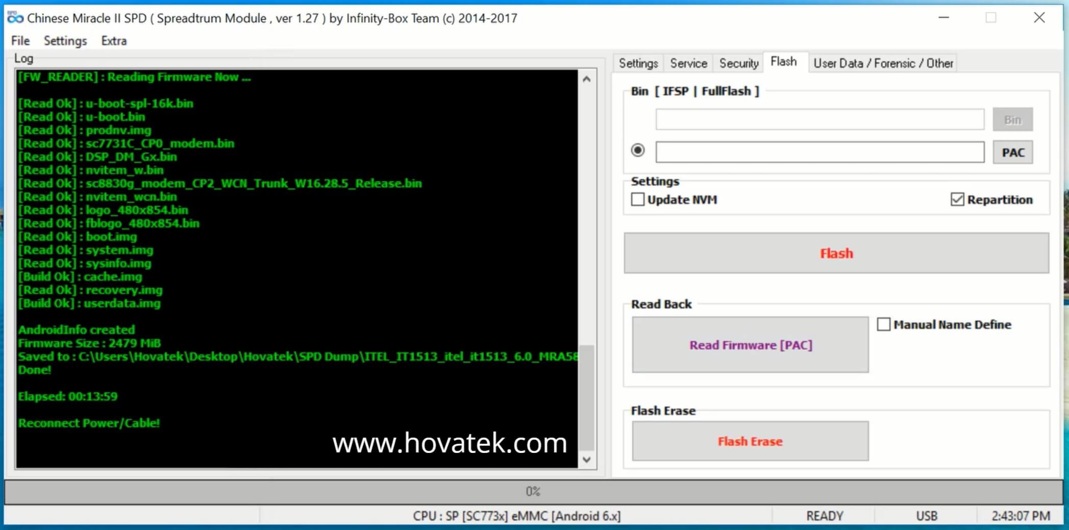

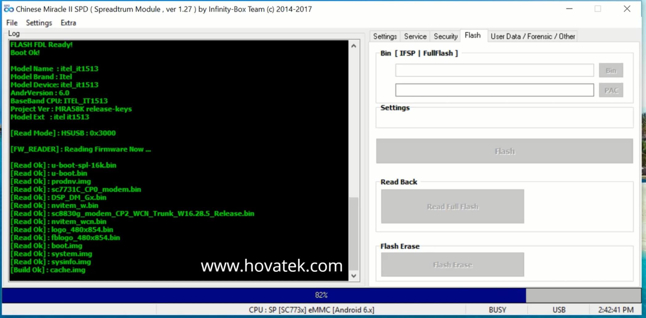

  9. CM2 SPD should now start backing up the partitions, you can now release the Volume down button
    [Image: How-to-backup-a-Spreadtrum-Android-phone...dule-8.jpg]
  10. Once backup is done, you should get a Done! confirmation along with the path to the backup
    [Image: How-to-backup-a-Spreadtrum-Android-phone...dule-9.jpg]

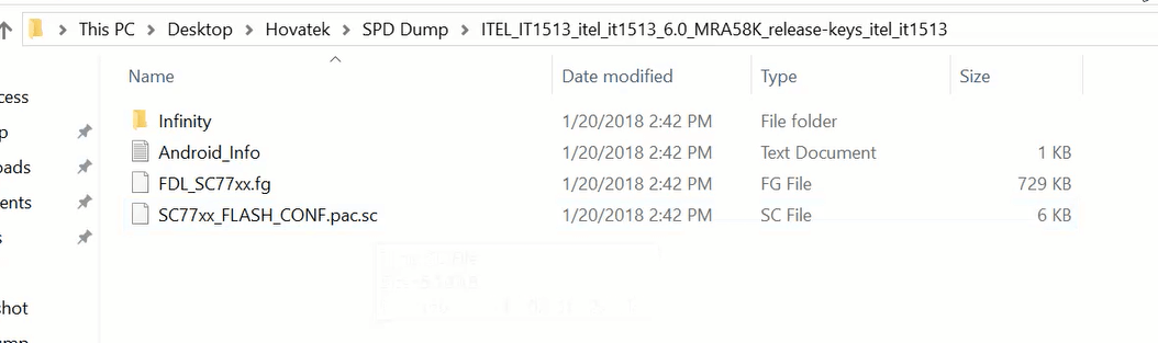

  11. Check the destination folder for your Spreadtrum (SPD) firmware backup files
    [Image: How-to-backup-a-Spreadtrum-Android-phone...ule-10.png]
