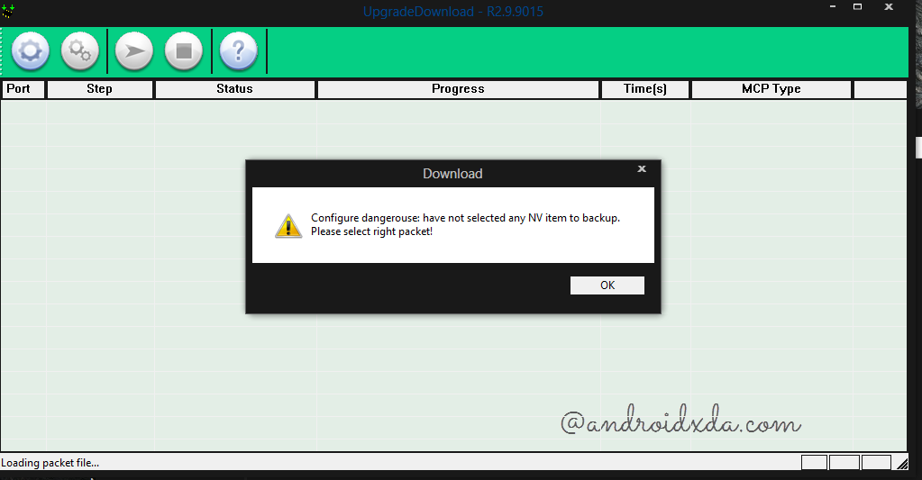

10-08-2018, 04:49 PM
how to fix that error attached
51,035
11-08-2018, 01:28 AM
(10-08-2018, 04:49 PM)joe-crack how to fix that error attached
try using research download tool R4.0.0001 at https://www.hovatek.com/forum/thread-15611.html
