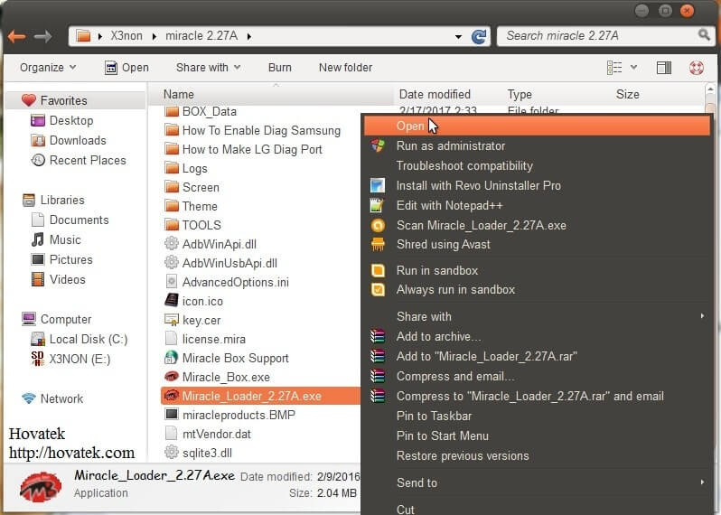

  1. Extract the content of the Miracle Box zip into a folder and launch Miracle loader exe

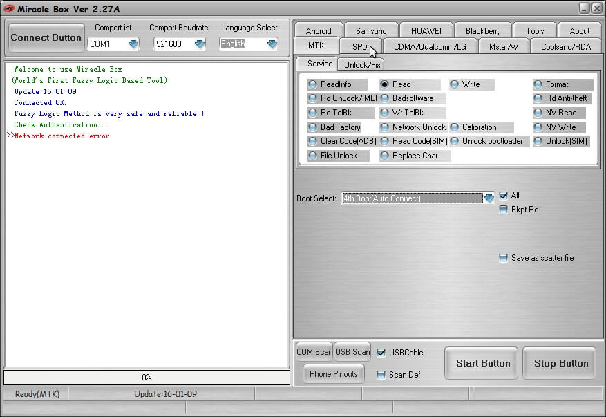

  3. Click on the SPD tab
    [Image: How-to-flash-a-Spreadtrum-Android-phone-...-Box-3.jpg]

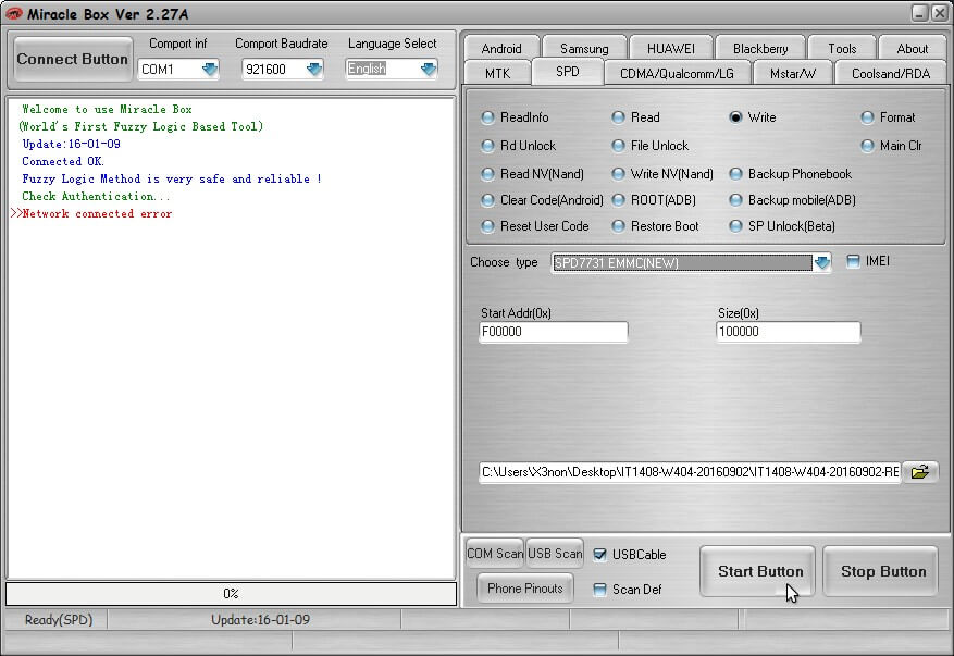

  4. Tick the checkbox beside Write
    [Image: How-to-flash-a-Spreadtrum-Android-phone-...-Box-4.jpg]

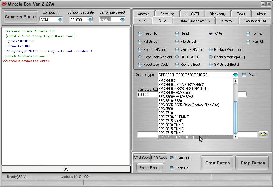

  5. Select the phone's chipset type from the dropdown bar
    [Image: How-to-flash-a-Spreadtrum-Android-phone-...-Box-5.jpg]

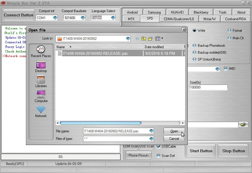

  7. In the window that opens next, select the .pac or .mira firmware file then Click on Open
    [Image: How-to-flash-a-Spreadtrum-Android-phone-...-Box-7.jpg]
  8. Click on the Start button
    [Image: How-to-flash-a-Spreadtrum-Android-phone-...-Box-8.jpg]

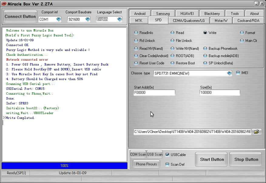

  9. You should now see >> "Scanning USB Serial port..." at the bottom left hand corner. Hold the vol down button on your phone and Connect the phone to the PC (must be switched off with battery inside)
    [Image: How-to-flash-a-Spreadtrum-Android-phone-...-Box-9.jpg]

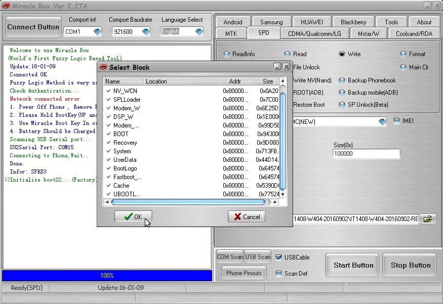

  10. A small windows should pop up. Select the items / partitions you wish to flash then click OK
    [Image: How-to-flash-a-Spreadtrum-Android-phone-...Box-10.jpg]

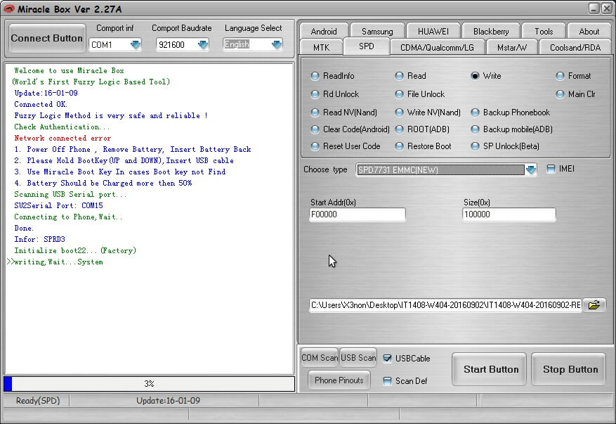

  11. Wait for the writing process to complete
    [Image: How-to-flash-a-Spreadtrum-Android-phone-...Box-11.jpg]
  12. Once successful, you should get a "Write Completed" message
    [Image: How-to-flash-a-Spreadtrum-Android-phone-...Box-12.jpg]
  13. You can now disconnect and power on the phone.
