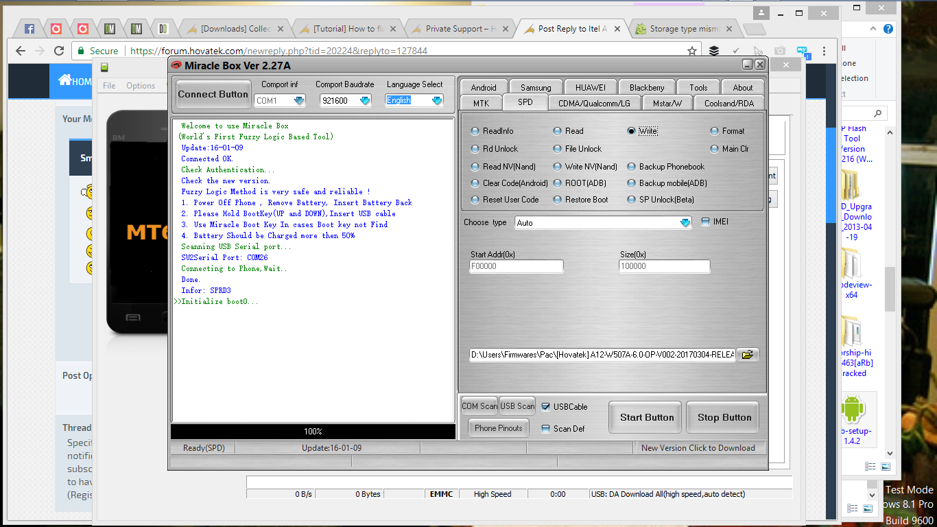

thanks, it solved the none serial blah issue. so, it got to this point and i didnt know what to think. help. thanks
This post was last modified: 08-01-2018, 01:39 PM by whizyrel.
08-01-2018, 01:50 PM
(08-01-2018, 01:33 PM)whizyrel thanks, it solved the none serial blah issue. so, it got to this point and i didnt know what to think. help. thanks
The miracle box loader version won't work on your phone.
