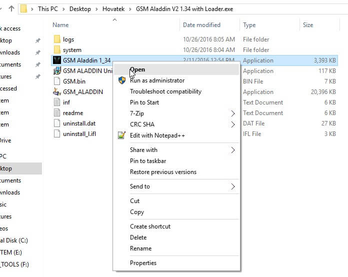

  1. Extract the content of the GSM Aladdin zip and double-click GSM Aladdin 1.34.exe
    [Image: Hovatek-how-to-backup-or-dump-MTK-Androi...-Box-1.jpg]

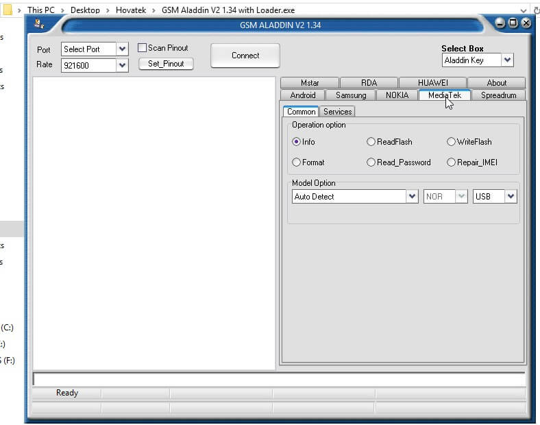

  2. Click the Mediatek tab
    [Image: Hovatek-how-to-backup-or-dump-MTK-Androi...-Box-2.jpg]

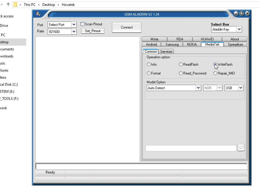

  3. Tick WriteFlash
    [Image: Hovatek-how-to-flash-firmware-to-a-media...-box-1.jpg]

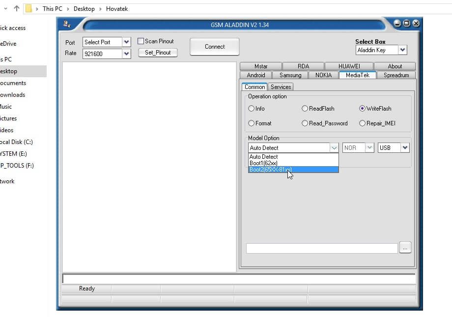

  4. Select your chipset type under Model Option or leave as Auto Detect if not sure
    [Image: Hovatek-how-to-flash-firmware-to-a-media...-box-2.jpg]

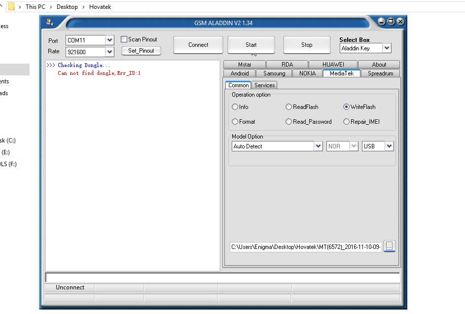

  8. Click Connect (at the top)
    [Image: Hovatek-how-to-flash-firmware-to-a-media...-box-6.jpg]

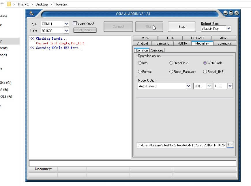

  9. Click Start
    [Image: Hovatek-how-to-flash-firmware-to-a-media...-box-7.jpg]

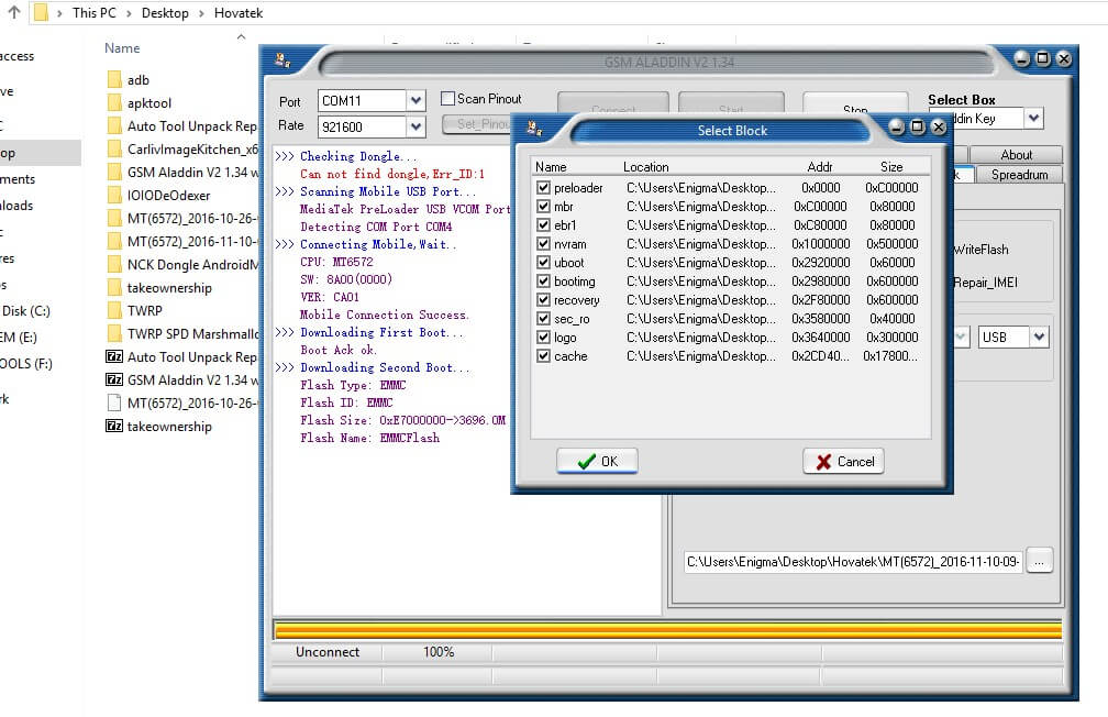

  12. A box should popup, tick the partitions you wish to flash to the phone
    [Image: Hovatek-how-to-flash-firmware-to-a-media...box-10.jpg]

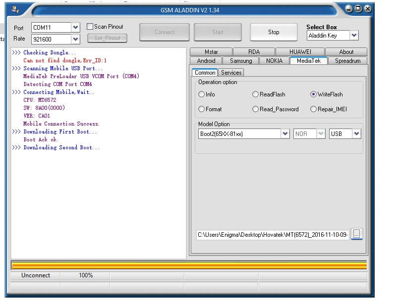

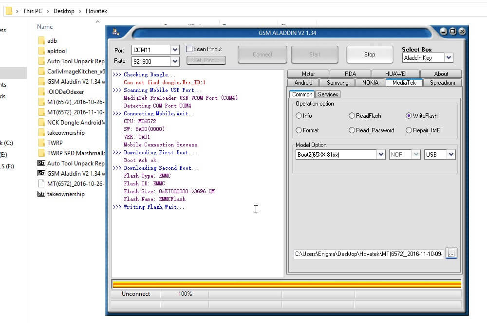

  13. You should now see >>> Writing Flash Wait...
    [Image: Hovatek-how-to-flash-firmware-to-a-media...box-11.jpg]
  14. Flashing should begin, do not interrupt
    [Image: Hovatek-how-to-flash-firmware-to-a-media...box-12.jpg]

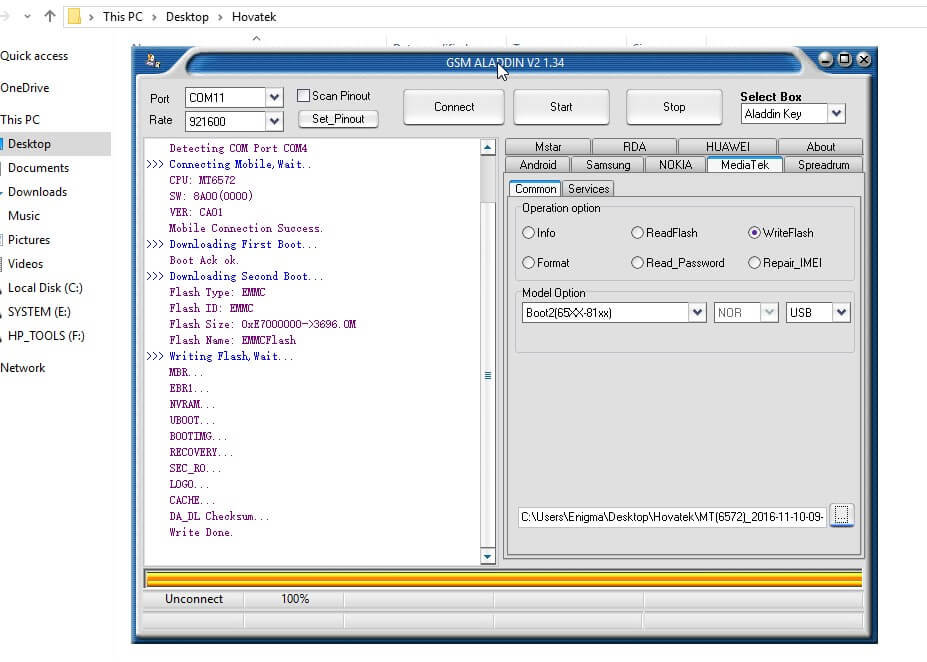

  15. Once flashing is done, you should see Write Done 100% . Disconnect the phone then boot
    [Image: Hovatek-how-to-flash-firmware-to-a-media...box-13.jpg]
