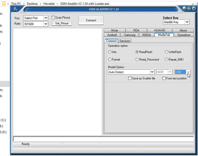

  4. Set Model option to Auto Detect and USB
    [Image: Hovatek-how-to-backup-or-dump-MTK-Androi...-Box-4.jpg]

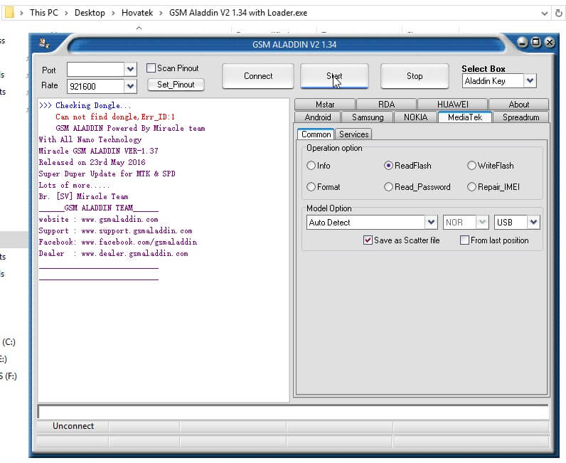

  7. Click Start
    [Image: Hovatek-how-to-backup-or-dump-MTK-Androi...-Box-7.jpg]

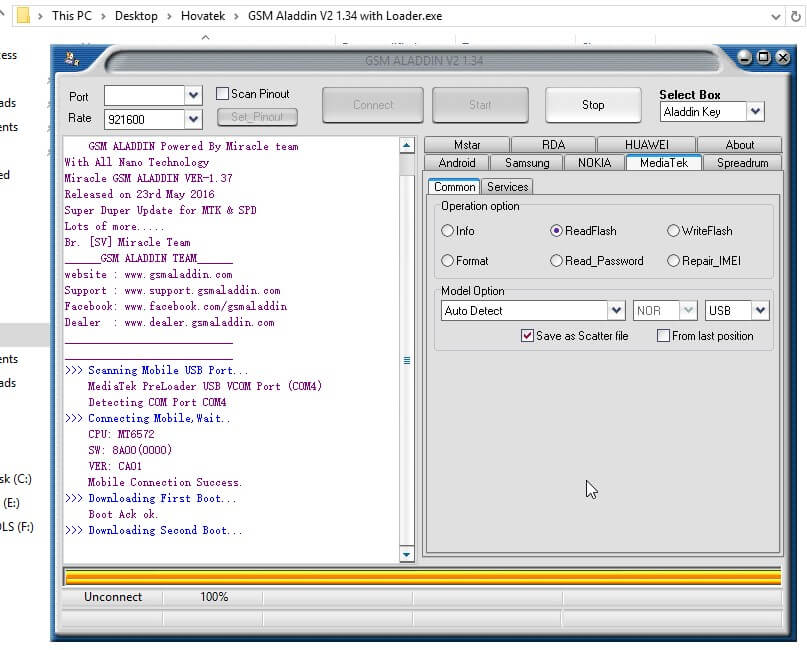

  8. You should now see >>> Scanning Mobile USB Port... . At this point, switch off the phone then connect it to the PC via USB cord (with or without the battery in it)
    [Image: Hovatek-how-to-backup-or-dump-MTK-Androi...-Box-8.jpg]

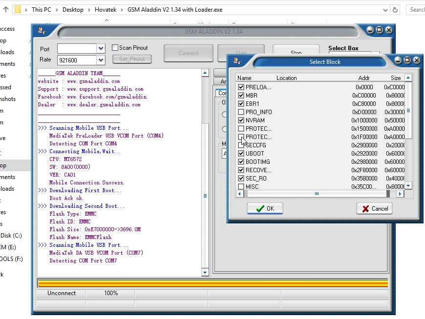

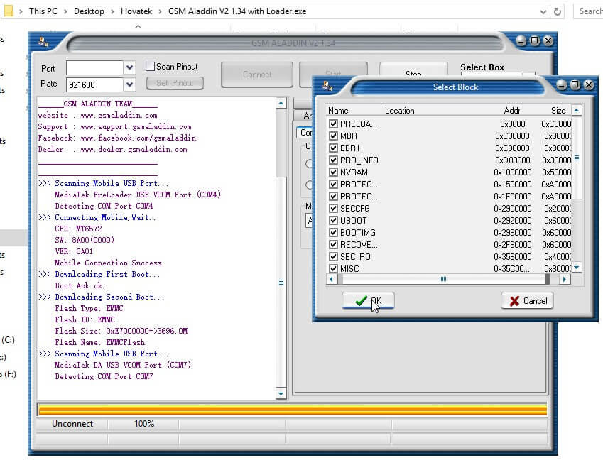

  10. If you ticked the Scatter file option, a box should popup. In this box, tick the partitions you wish to backup / Dump
    [Image: Hovatek-how-to-backup-or-dump-MTK-Androi...Box-10.jpg]
  11. Click OK when you're done
    [Image: Hovatek-how-to-backup-or-dump-MTK-Androi...Box-11.jpg]

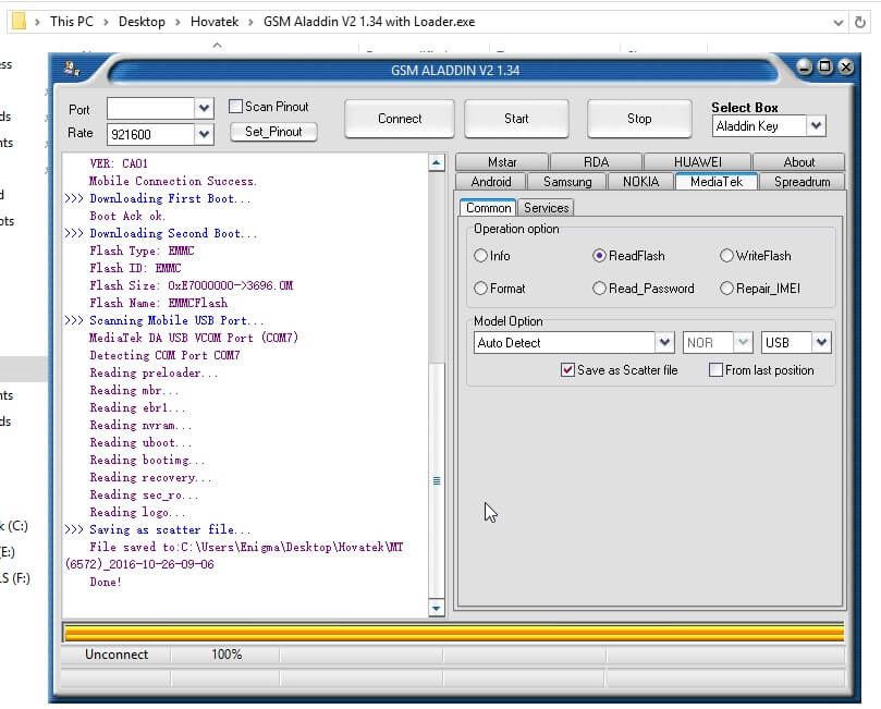

  13. GSM Aladdin should begin backing up the selected partitions. Do Not interrupt this process
    [Image: Hovatek-how-to-backup-or-dump-MTK-Androi...Box-13.jpg]

  16. Once backup is done, you should get a success message
    [Image: Hovatek-how-to-backup-or-dump-MTK-Androi...Box-14.jpg]
