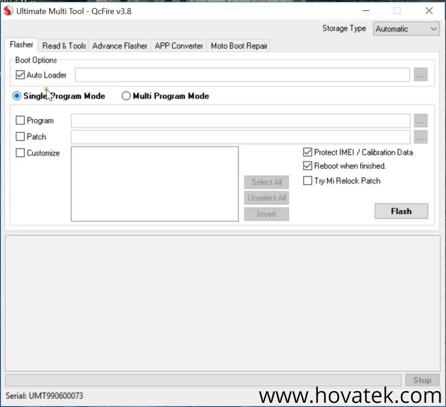

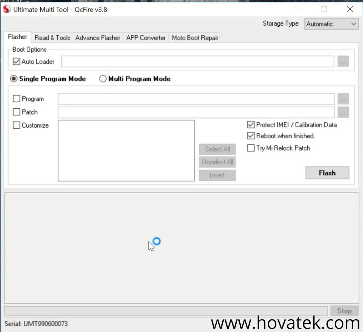

  1. Launch UMT QcFire
    [Image: How-to-use-Ultimate-Multi-Tool-UMT-QcFir...ware-1.jpg]
  2. You could flash with Single or Multi Program Mode but I'll go with Single in this example
    [Image: How-to-use-Ultimate-Multi-Tool-UMT-QcFir...ware-2.jpg]

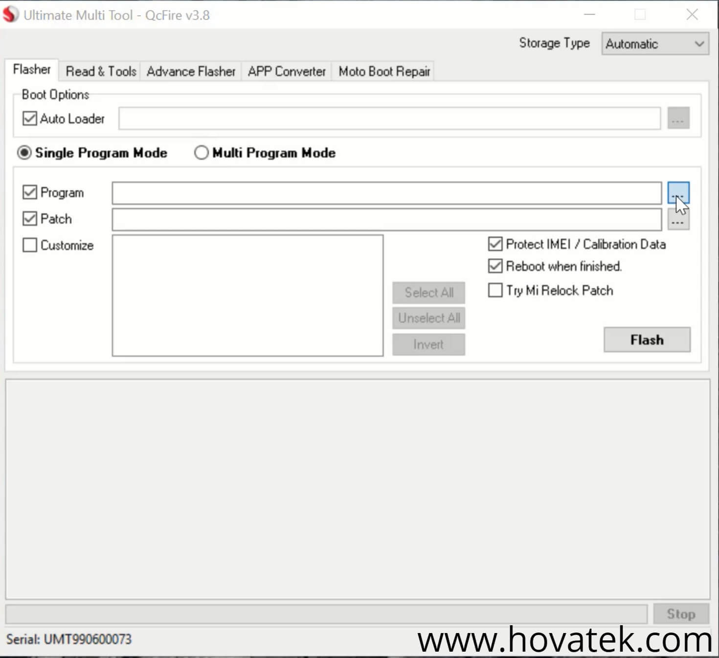

  3. Tick Program
    [Image: How-to-use-Ultimate-Multi-Tool-UMT-QcFir...ware-3.jpg]

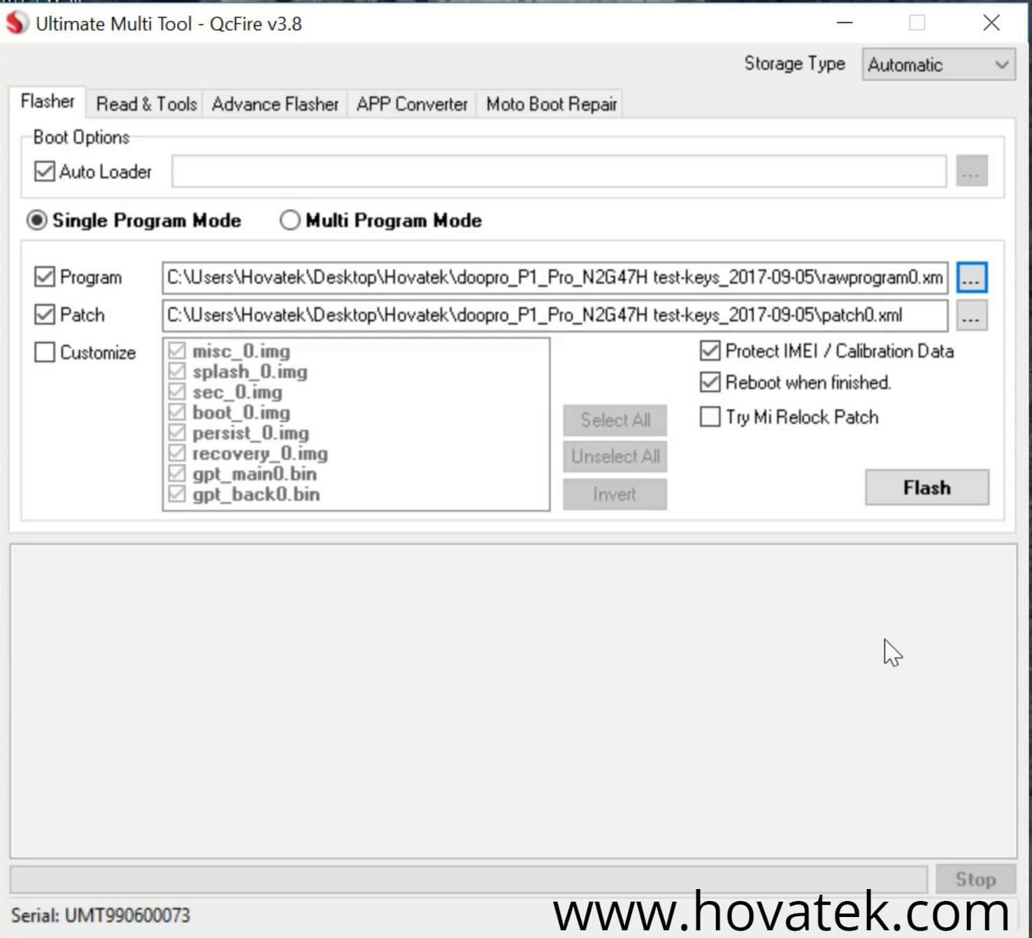

  4. Click the Browse icon in front of Program
    [Image: How-to-use-Ultimate-Multi-Tool-UMT-QcFir...ware-4.jpg]

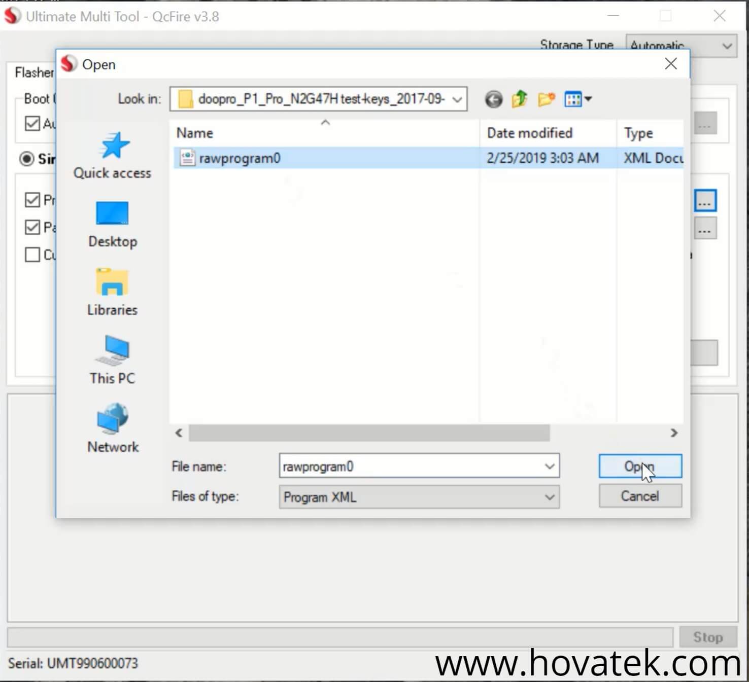

  5. Navigate to the location of the firmware, highlight the rawprogram() file then click Open
    [Image: How-to-use-Ultimate-Multi-Tool-UMT-QcFir...ware-5.jpg]
  6. The files to be flashed should now be loaded. You could tick Customize to choose partitions to be flashed
    [Image: How-to-use-Ultimate-Multi-Tool-UMT-QcFir...ware-6.jpg]

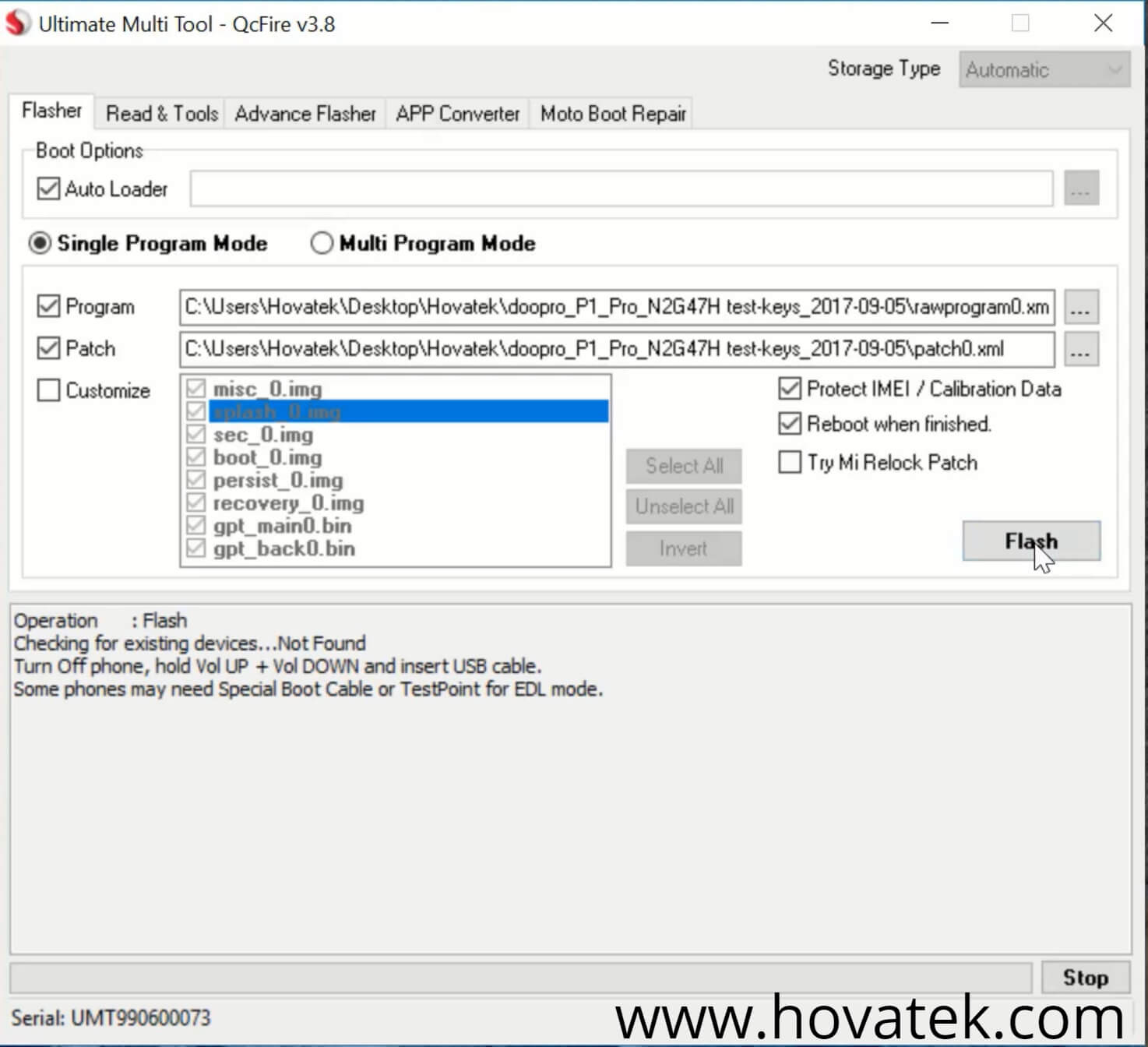

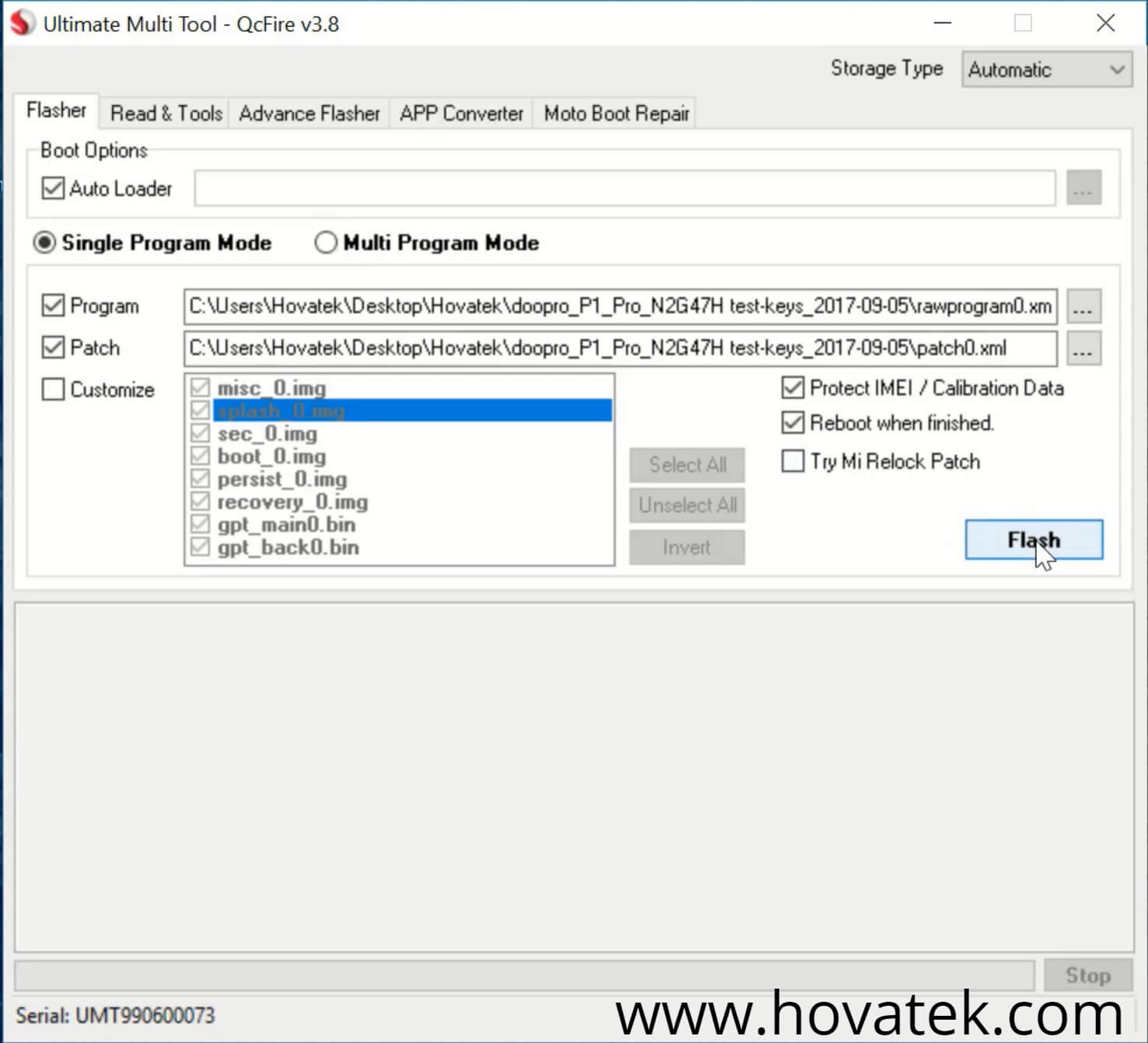

  7. Click Flash
    [Image: How-to-use-Ultimate-Multi-Tool-UMT-QcFir...ware-7.jpg]

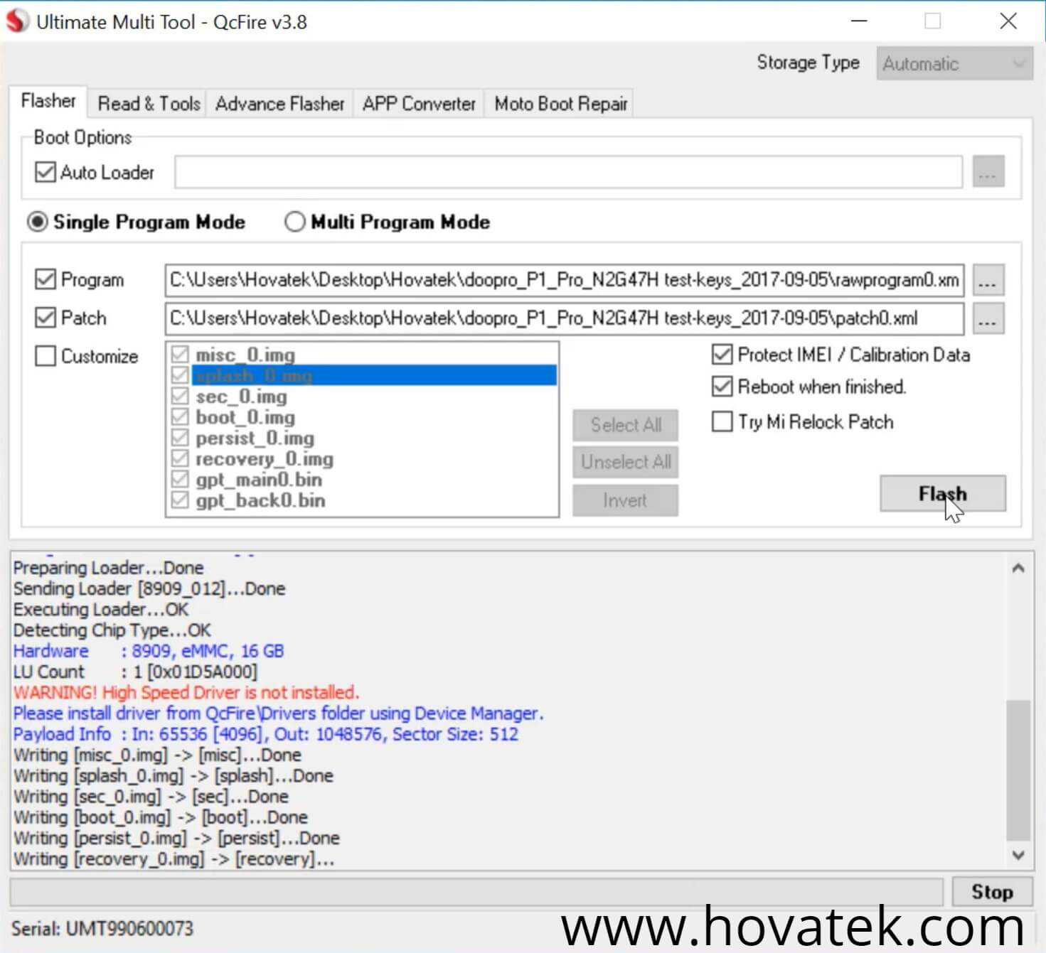

  8. Once you see "Turn off..", boot the device into Emergency Download Mode then connect to PC via USB cord
    [Image: How-to-use-Ultimate-Multi-Tool-UMT-QcFir...ware-8.jpg]
  9. The device should get detected
    [Image: How-to-use-Ultimate-Multi-Tool-UMT-QcFir...ware-9.jpg]

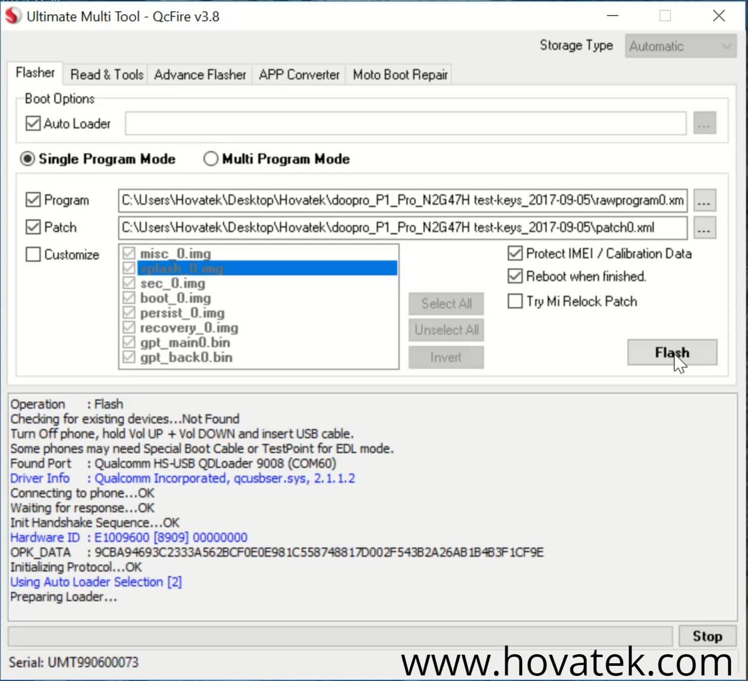

  10. UMT should start flashing the files to their corresponding partitons
    [Image: How-to-use-Ultimate-Multi-Tool-UMT-QcFir...are-10.jpg]

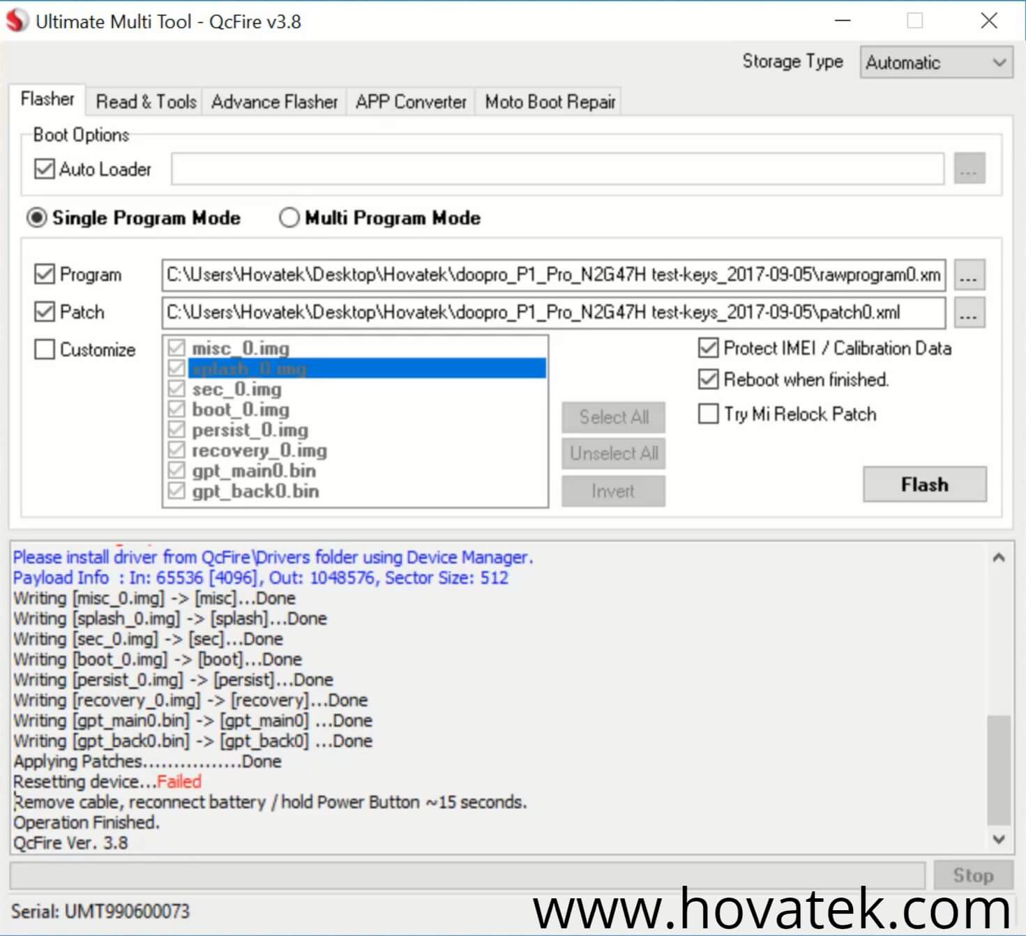

  11. You should see Operation Finished once flashing is complete
    [Image: How-to-use-Ultimate-Multi-Tool-UMT-QcFir...are-11.jpg]
  12. You can disconnect and power up the device.
