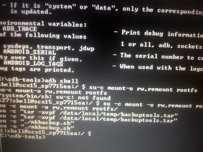

16-04-2015, 04:55 PM
Hi,
I tried to backup an Itel It1403, I got everything right up to the point where I have to type the command code
su -c mount -o rw,remount rootfs /
su -c "tar -xvpf /data/local/tmp/backuptools.tar"
su -c "./mkbackup.sh"
The screen shot of the response is attached with this reply.
Please I would like to know where I get it wrong.
gsmhospital
gsmhospital
gsmhospital
149
16-04-2015, 04:57 PM
Am waiting for your reply please.

(16-04-2015, 04:55 PM)gsmhospital Hi,
you're supposed to press enter after each command. not seeing much of a response here

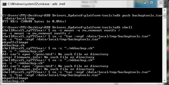

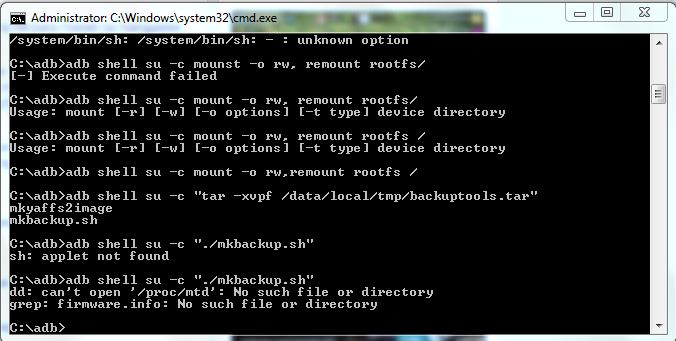

Hi Hovatek,
I tried doing a backup for an itel it1452 but after the last command it gave me an error which says "sh: applet not found". So I followed your instruction to install Busybox Installer (Jrummy) and started the process all over. All the commands ended up fine except the last one which gave the following output: shell@scx15_sp7715ea:/ $ su -c "./mkbackup.sh"
dd: can't open '/proc/mtd': No such file or directory
grep: firmware.info: No such file or directory
Please help me solve this. I am attaching the full screenshot.
Thanks.
