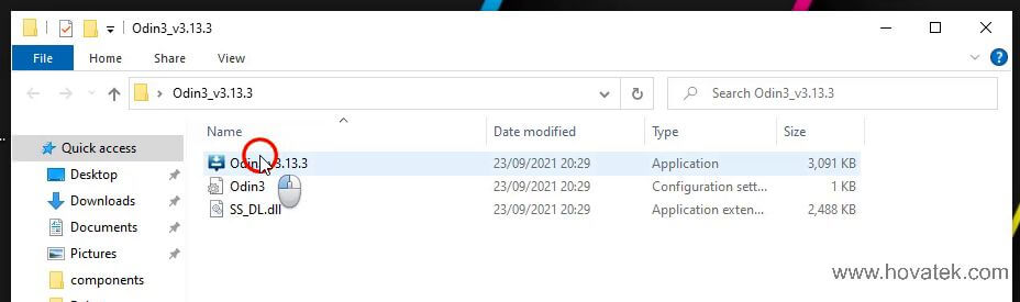

  1. Extract the contents of the Odin zip file into a folder and launch Odin

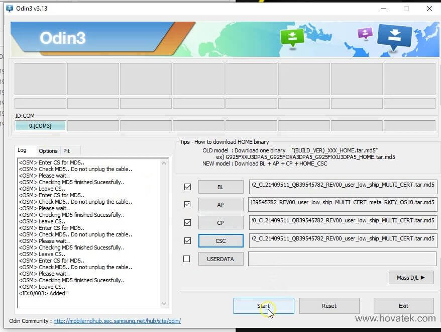

  6. After loading the file(s) to be flashed, boot the device into Download Mode then connect
    [Image: how-to-use-odin-to-flash-samsung-firmware-6.webp]
  7. You should see detection (Blue bar with COM Port number). Click Start
    [Image: how-to-use-odin-to-flash-samsung-firmware-7.webp]

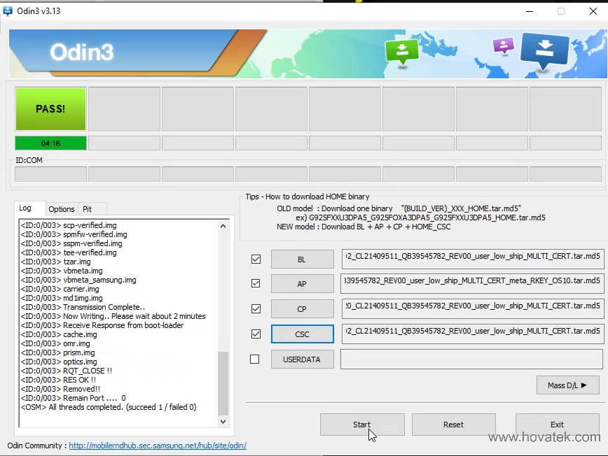

  8. Wait while Odin flashes the firmware
    [Image: how-to-use-odin-to-flash-samsung-firmware-8.webp]
  9. You should see a PASS message once flashing is done
    [Image: how-to-use-odin-to-flash-samsung-firmware-9.webp]
