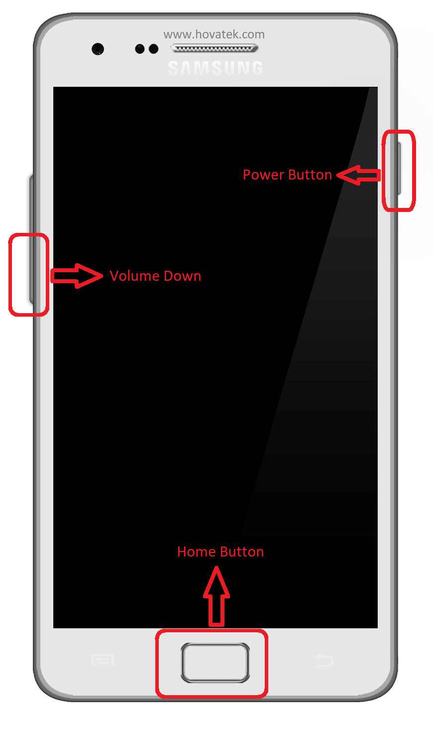

Volume Down + Home + Power keys (e.g Samsung Galaxy Xcover 3 SM-G389F)
Boot to download mode on samsung deivces such as the Galaxy Xcover 3, Galaxy S2, Galaxy S3, etc. having the Home button.
See the video below or @ https://youtu.be/sGsvgSAkA-s
[Image: How-to-boot-into-download-mode-samsung-home-key.png]
  1. Switch off your device
  2. Now press and hold the Volume Down + Home + Power keys
  3. The device should boot into Download Mode (Warning screen)
  4. You'll be prompted to press Volume Up to proceed to Download mode

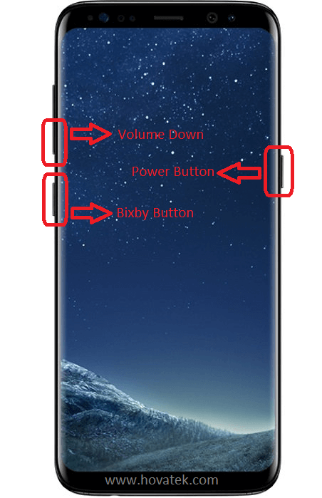

Volume Down + Bixby + Power keys (e.g Samsung Galaxy S8 SM-G950)
Boot to download mode on samsung deivces such as the Galaxy S8, Galaxy S9, Galaxy S10, etc. having the Bixby button.
[Image: How-to-boot-into-download-mode-samsung-bixby-key.png]
  2. Now press and hold the Volume Down + Bixby + Power keys

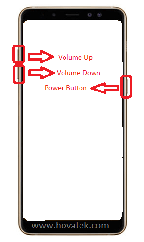

Volume Up + Volume Down + Power keys (e.g Samsung Galaxy A12 SM-A125)
Boot to download mode on samsung deivces such as the Samsung Galaxy A8 (2018), Galaxy A12, etc. having only the Power and Volume Up & Down buttons.
See the video below or @ https://youtu.be/wpPSXvean2Q
[Image: How-to-boot-into-download-mode-samsung-power-key.png]
  1. Power off your device
  2. Now press and hold the Volume Up + Volume Down + Power buttons

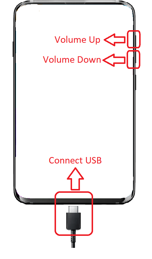

Volume Up + Volume Down + USB cable (e.g Samsung Galaxy Jean SM-A605K)
Boot to download mode on samsung deivces such as the Galaxy A51, Galaxy Jean, etc. having only the Power and Volume Up & Down buttons but using power button doesn't get you to download mode.
See the video below or @ https://youtu.be/NvCCrXR2xRA
[Image: How-to-boot-into-download-mode-samsung-usb-cable.png]
  2. Now press and hold the Volume Up + Volume Down then Connect to a power source using USB cable
  3. Ensure that the USB cable is connected to a power source such as a PC or charger
  4. The device should boot into Download Mode (Warning screen)
  5. You'll be prompted to press Volume Up to proceed to Download mode
