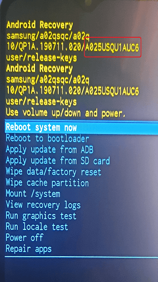

  1. First, you'd need to either boot to either recovery mode or download mode on your device
  2. The AP/PDA version should be displayed at the top of your screen e.g in the screenshot below of Samsung SM-A025u in recovery mode. You can search for a matching firmware using the AP version
    [Image: how-to-choose-the-right-firmware-for-you...vice-1.png]
  3. Also take note of the binary version usually indicated as U* or S*. In the above screenshot, it's binary version 1 (i.e u1)
  4. You should always download same firmware for the same binary version or higher as some devices don't support downgrading
