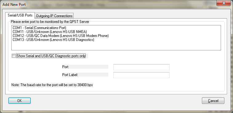

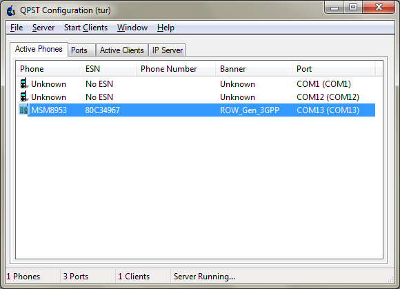

I've a try to go through the offered process, but stopped at 5-th step. I launch QPSTConfig.exe, connect my PC with device Le x527. After the window opened I saw no port available. Press the button add port: select the only port COM1 - Serial (Communication Port), select it, and press OK. Select Software download and saw Port COM1 No phone connected.
So, I stopped.
I have another phone Lenovo TB 8703x. I've inserted its cable to the PC, and repeated my made steps to see the difference.
The window add_new_port has 4 ports to choose. I checked all.
The window Active_phones has three string and the last is:
Phone: MSM8953 | ESN: 80C34967 | Banner: Row_Gen_3GPP | Port: COM13
I suppose the last one is more suited for next Step, cause it shows chipset MSM8953, ESN number 80C34967 /Really unknown for me/
My Le2 is really strange device, it support adb, fastboot, EDL mode, and so on, but all two windows just empty, the only port is COM1, as it is in windows 7.

The window add_new_port:
I have another phone Lenovo TB 8703x. I've inserted its cable to the PC, and repeated my made steps.

First:
So, I stopped.
