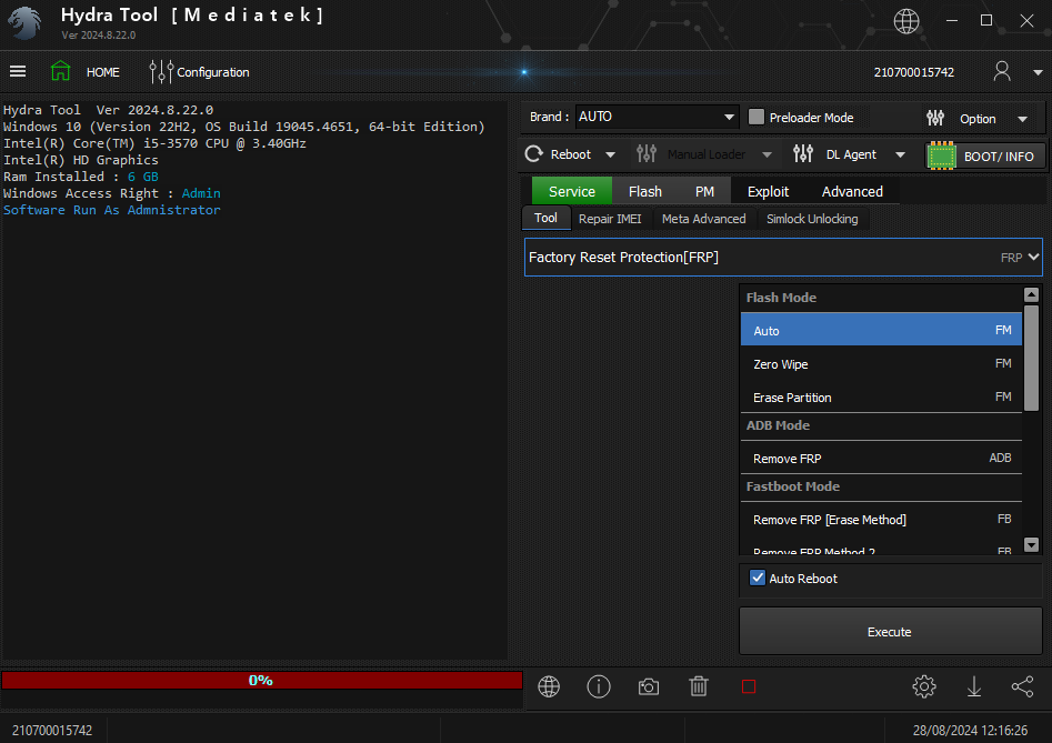

Run Hydra Tool as administrator
Double-click on MTK to access the section.
Click on the "Service" Tab, then select "Tool" under it

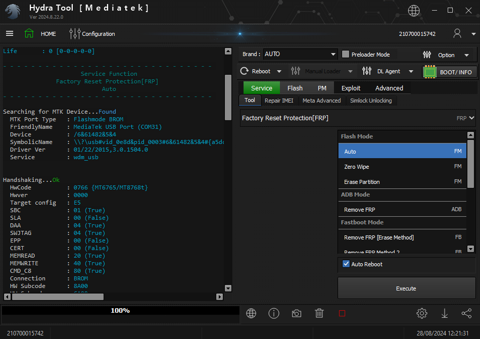

Click on the drop-down menu and select "FACTORY RESET PROTECTION [FRP]".
Under the dropdown menu, you will see a list of options. Keep it at "Flashmode > Auto"

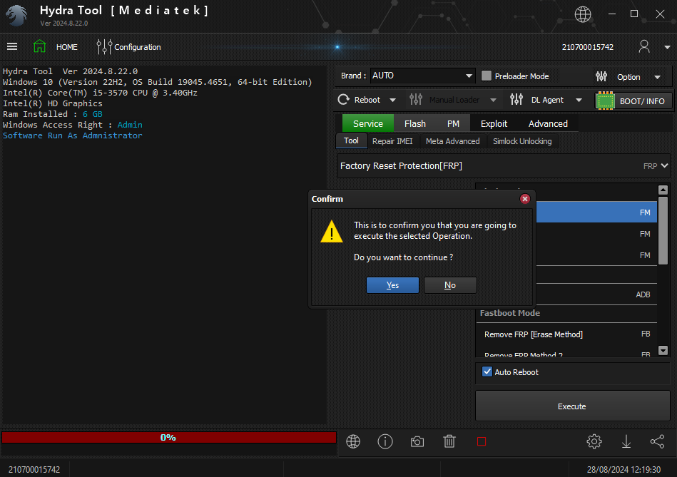

Click Execute, You’ll see a prompt to confirm the operation click "Yes" to proceed
Power off and connect your device. The process will start once your device is detected.

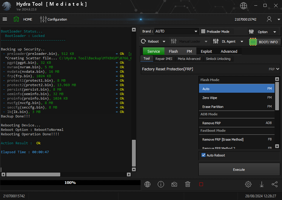

Wait till its done
Disconnect and Reboot the phone
