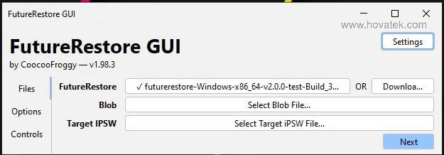

  1. Launch FutureRestore GUI
    [Image: How-to-downgrade-iOS-using-FutureRestore...dows-1.jpg]

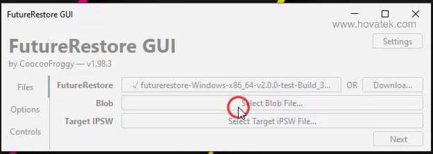

  2. Click "Select Blob File"
    [Image: How-to-downgrade-iOS-using-FutureRestore...dows-2.jpg]

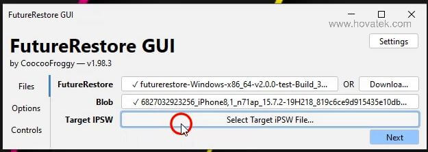

  3. Click "Select Target IPSW File"
    [Image: How-to-downgrade-iOS-using-FutureRestore...dows-3.jpg]

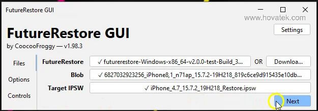

  4. Click Next
    [Image: How-to-downgrade-iOS-using-FutureRestore...dows-4.jpg]

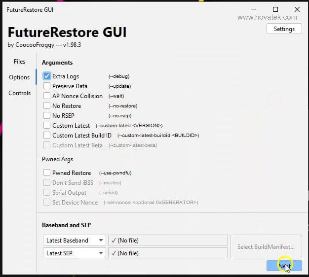

  5. Click Next
    [Image: How-to-downgrade-iOS-using-FutureRestore...dows-5.jpg]

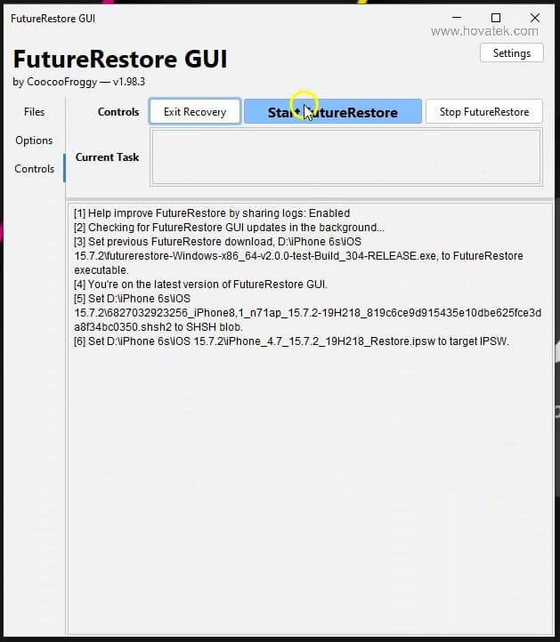

  6. Connect the device via cable (while powered on) then click Start FutureRestore
    [Image: How-to-downgrade-iOS-using-FutureRestore...dows-6.jpg]

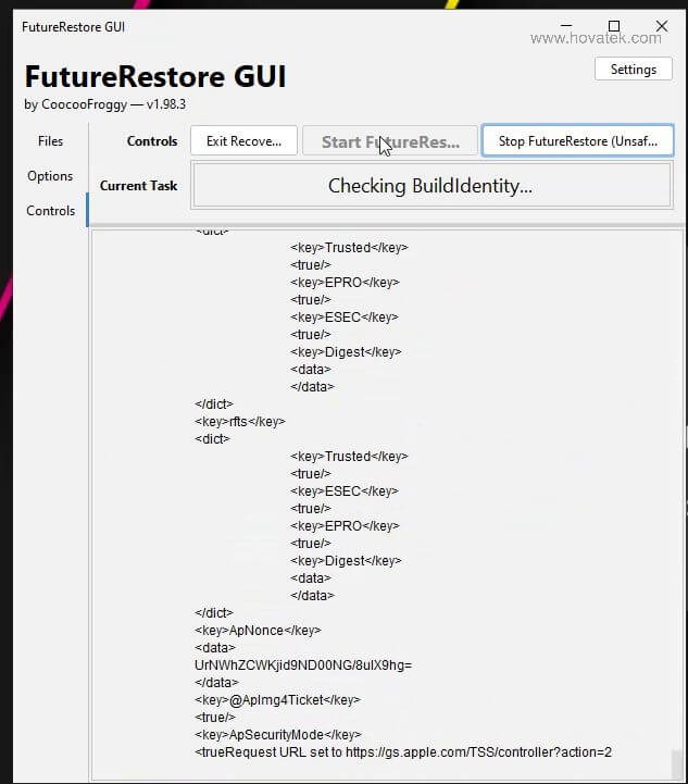

  7. Wait while FutureRestore flashes the firmware. The device might reboot or show certain colors on the screen
    [Image: How-to-downgrade-iOS-using-FutureRestore...dows-7.jpg]

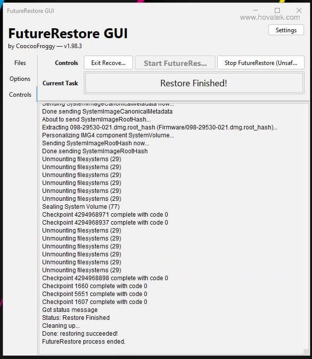

  8. You should get a Done message once the downgrade is complete
    [Image: How-to-downgrade-iOS-using-FutureRestore...dows-8.jpg]
