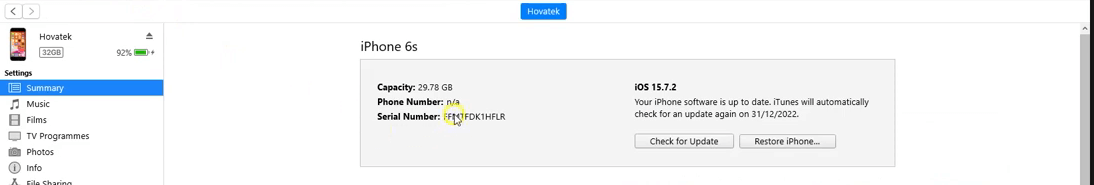

  1. Launch iTunes and connect the device to the PC, allow / trust when prompted on PC and device
  2. Click the phone icon at the top left corner
  3. Under your device's model, click Serial Number twice
    [Image: itunes-show-iphone-serial-number.png]
  4. It should change from Serial Number to UDID then ECID. Copy the ECID
  5. If your ECID is all numbers then it's in decimal and you need to convert it to hexadecimal using any decimal-to-hexadecimal converter
  6. Click ECID and it should change to Model Number, take note of this too
