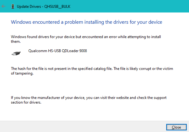

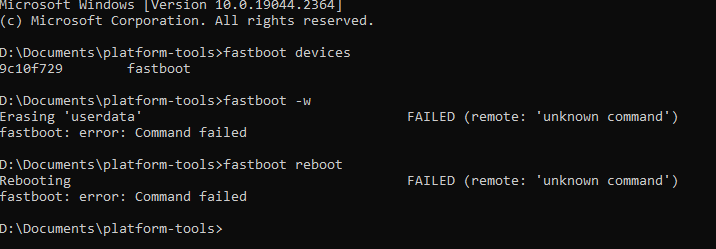

(06-01-2023, 10:20 AM)hovatek
(03-01-2023, 07:29 PM)somnomania [Image: 2023-01-03-13-28-21-Window.png]
Run
fastboot getvar all
Let see the output
1. We could also consider rebooting to EDL from fastboot if this model supports that
2. Do you have a way or option to power off the phone?
[Image: 2023-01-06-07-14-14-Window.png]
[Image: 2023-01-06-07-14-38-Window.png]
1. I tried "fastboot reboot edl" and it returned "fastboot: usage: unknown reboot target edl". Is there a different command?
2. I currently just pop the battery out and then put it back in after a second to turn it off.
