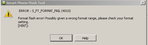

(26-08-2014, 03:04 PM)hovatek
(26-08-2014, 02:33 PM)aomine 1 / when I try to install an application that opens bootloader my phone, unfortunately I press the wrong version of another devices has different mine
2/ yes
3/yes, I did it myself backup
4/yes
5/at first I started with version 5, there was the same error after'm going to version 3
Seems your chipset is not recognized.
1. What was the other device you wrongly selected instead of yours?
2. List the files in your backup folder
the other devices was a Huawei ascend g300
[img][Image: dossiers_imagesia-com_nnoo_large.PNG][/img]
27-08-2014, 03:58 PM
#32
Download SP Flash tool V 3.1328 then do a format (DO NOT format Bootloader) . lets know if format was successful

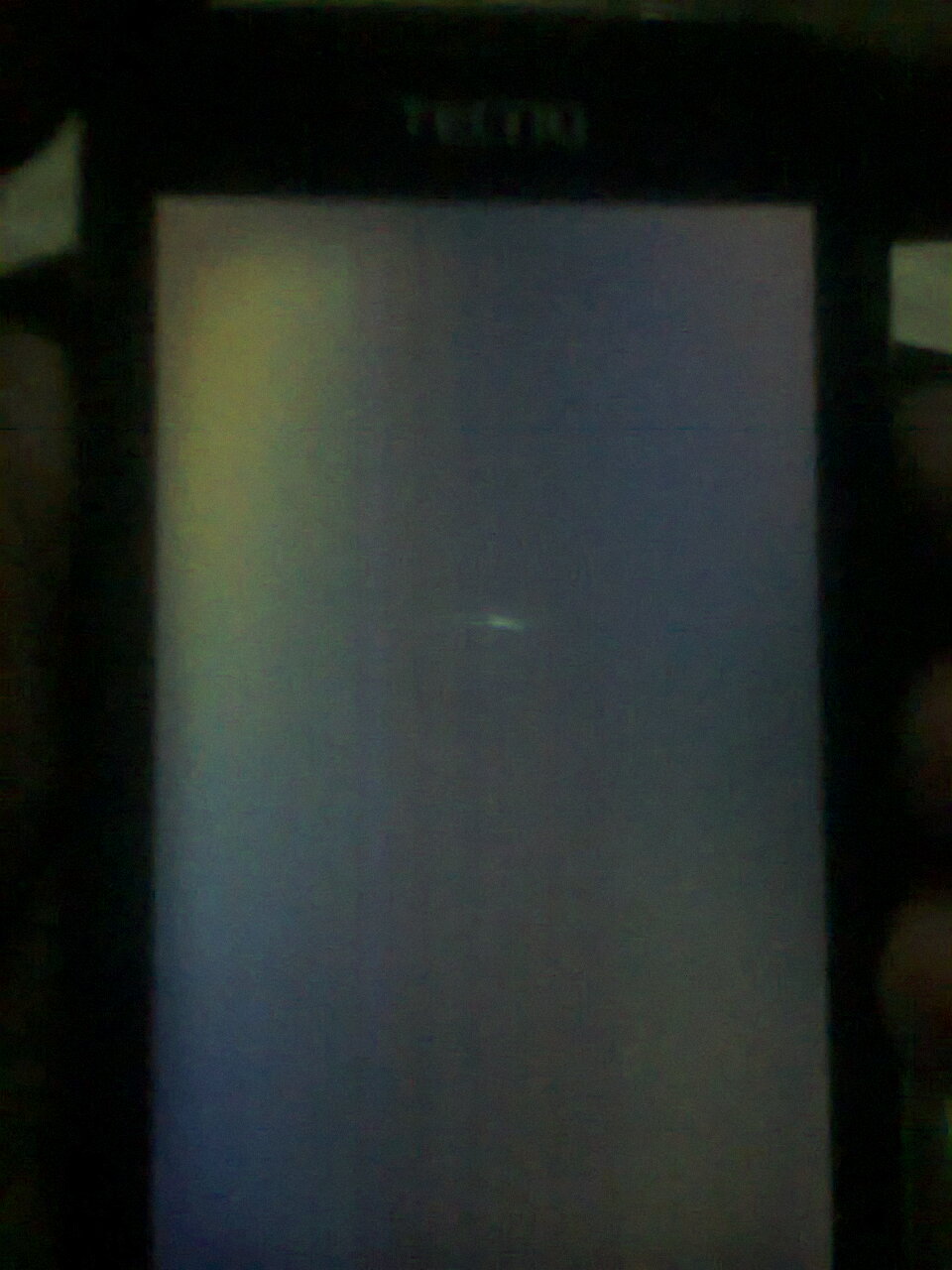

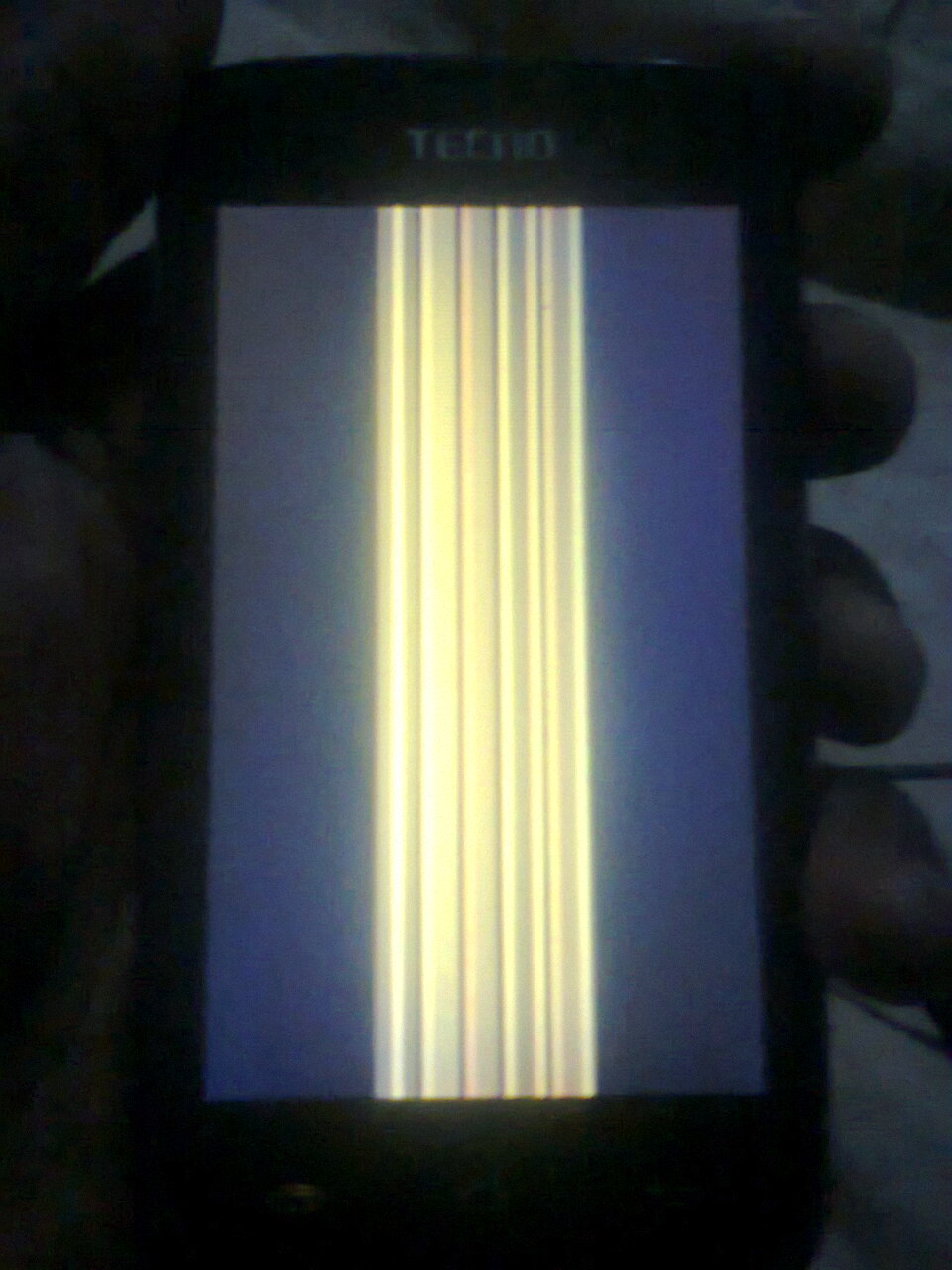

#39

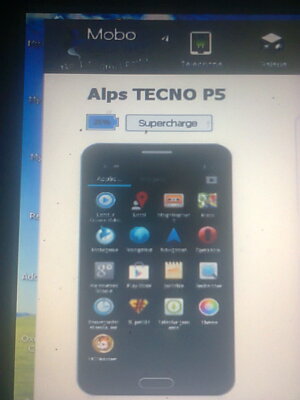

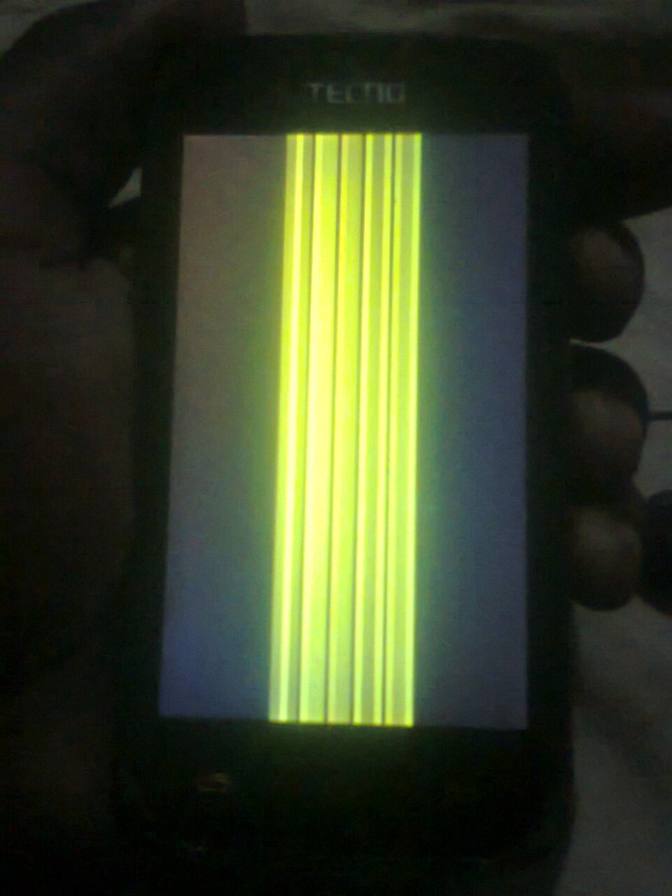

Hello!!!
I flash my P5 with thé backup of 2 different p5s but after all that my p5 does not boot normally. Please help
This's m'y screen
This post was last modified: 10-09-2014, 02:59 PM by Mcoul15.
10-09-2014, 03:15 PM
#40
(10-09-2014, 02:54 PM)Mcoul15 Hello!!!
This's m'y screen
what version of SP flash tool are you using?
