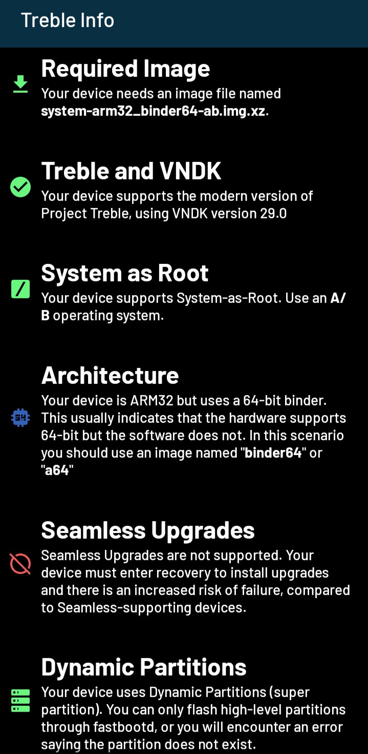

Recently I flashed GSI on my Unisoc phone which is Itel L6006...
Steps I used to flash:-
• Flashed the firmware
• Booted into fastbootd (using key combination, first recovery then fastbootd)
• Deleted Product Partition to free some space for system (fastboot delete-logical-partition product)
• Flashed GSI (fastboot flash -S 100M system system.img)
• Factory Reseted (from recovery)
• Then booted to system (from recovery)
Then it booted and everything is working just fine...but then I did some test and found a huge issue....
If I flash signed vbmeta for boot partition it gives me bootloop, I can confirm the vbmeta img is OK because I flashed it on my older system to root my phone with signed magisk-patched boot.img, and it worked just fine...
I tried flashing signed vbmeta to get root then flashing stock vbmeta then flashing system, it try to reboot into system but blink a black screen for 1 sec then reboot to fastboot mode
So, I really need to flash vbmeta after flashing GSI, to get root then to flash twrp
I did some research and found on some YouTube video teaching how to flash GSI in fastboot mode they first flashed empty vbmeta and empty vbmeta_system to disable DM_verify, but I didn't flashed any vbmeta BEFORE flashing GSI
Help me out

GSI: dotOS-R-v5.2-arm32-binder64-ab-VANILLA-OFFICIAL.img.xz
