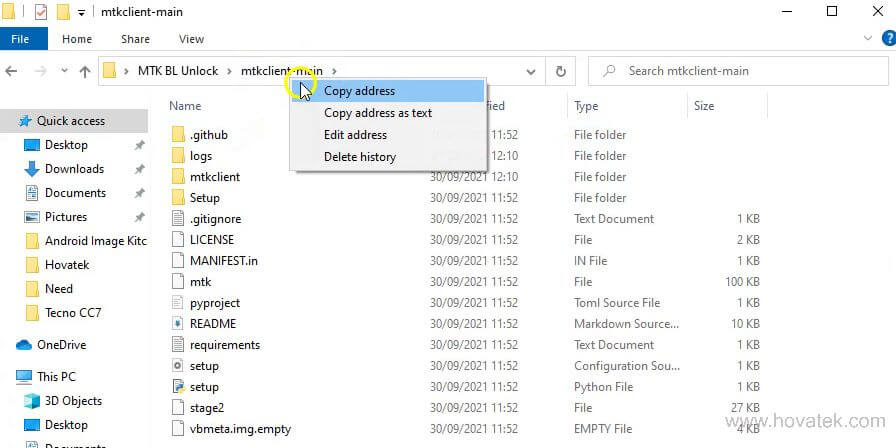

  1. Open the mtkclient folder, right-click the address bar at the top and copy the address

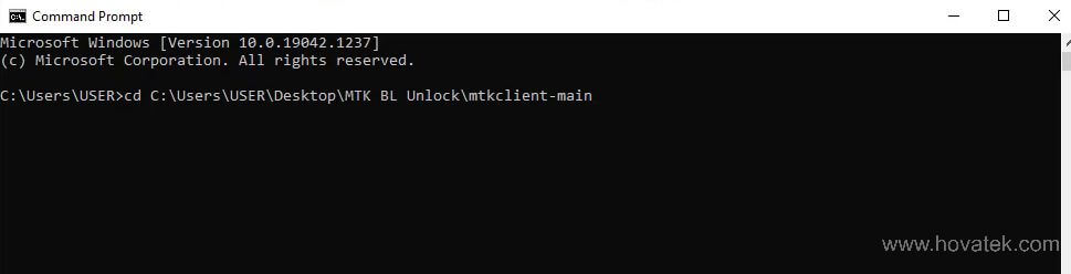

  2. Launch the Command prompt and type cd <space> then paste the address you copied and tap enter

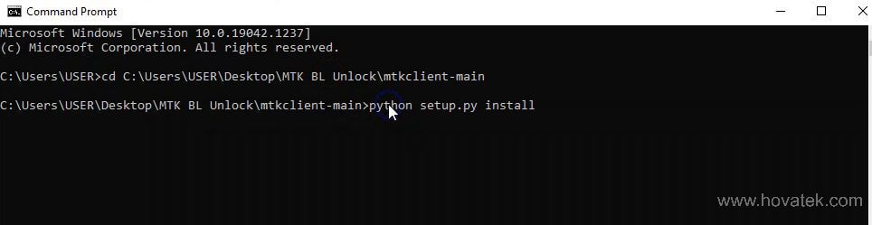

  4. Run the following commands
    python setup.py install pip3 install -r requirements.txt

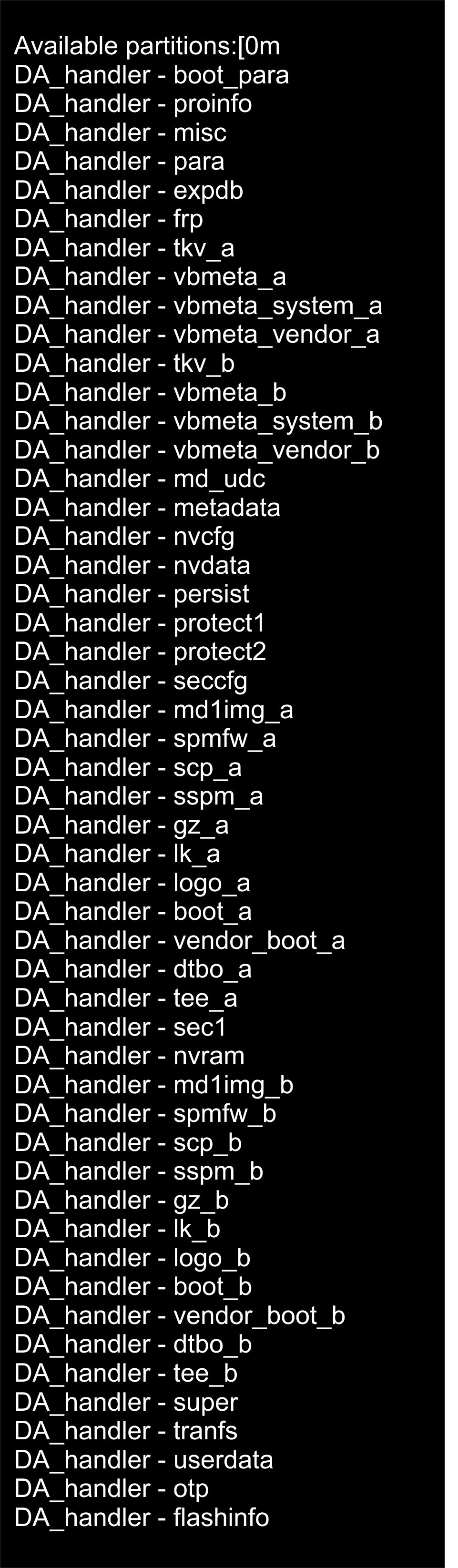

Alright, so that worked. So I have my boot image here. Here you can see the list of partitions which the tool can detect alright, so any partition you want to backup needs to be from this list. So if I want to do vbmeta for example, I'll go vbmeta_a because a is my active slot OK? You can backup all whether A or B whatever you want to backup. I will just stick with A. So let's say I want to backup two partitions for example or multiple ones, the command is simple. This command is what we'll be running. Mine is AB so I'll modify this. boot_a then you leave a space then this will be the output file name which you want OK? So python mtk r the partitions separated by commas.
Don't forget mine is A/B, that's why I have _a. If yours isn't AB, you skip this _ active slot or whatever slot you want to back. and then space file names separated by commas. Don't forget they need to be respective; boot_a before vbmeta_a boot before vbmeta don't forget, don't make that mistake of mixing them up. So I'm good to run this command. I'll scroll back to where I stopped. So, now I want to back up two partitions. I think I can delete this to avoid any issues. Now BROM mode and I connect. I'm using an LG K51 so my brom mode is my Google home key and volume down button. It could vary with devices of course. Alright, so I have my vbmeta and boot backed up. So that's how to backup or dump the firmware of your Mediatek Android device using MTK client
