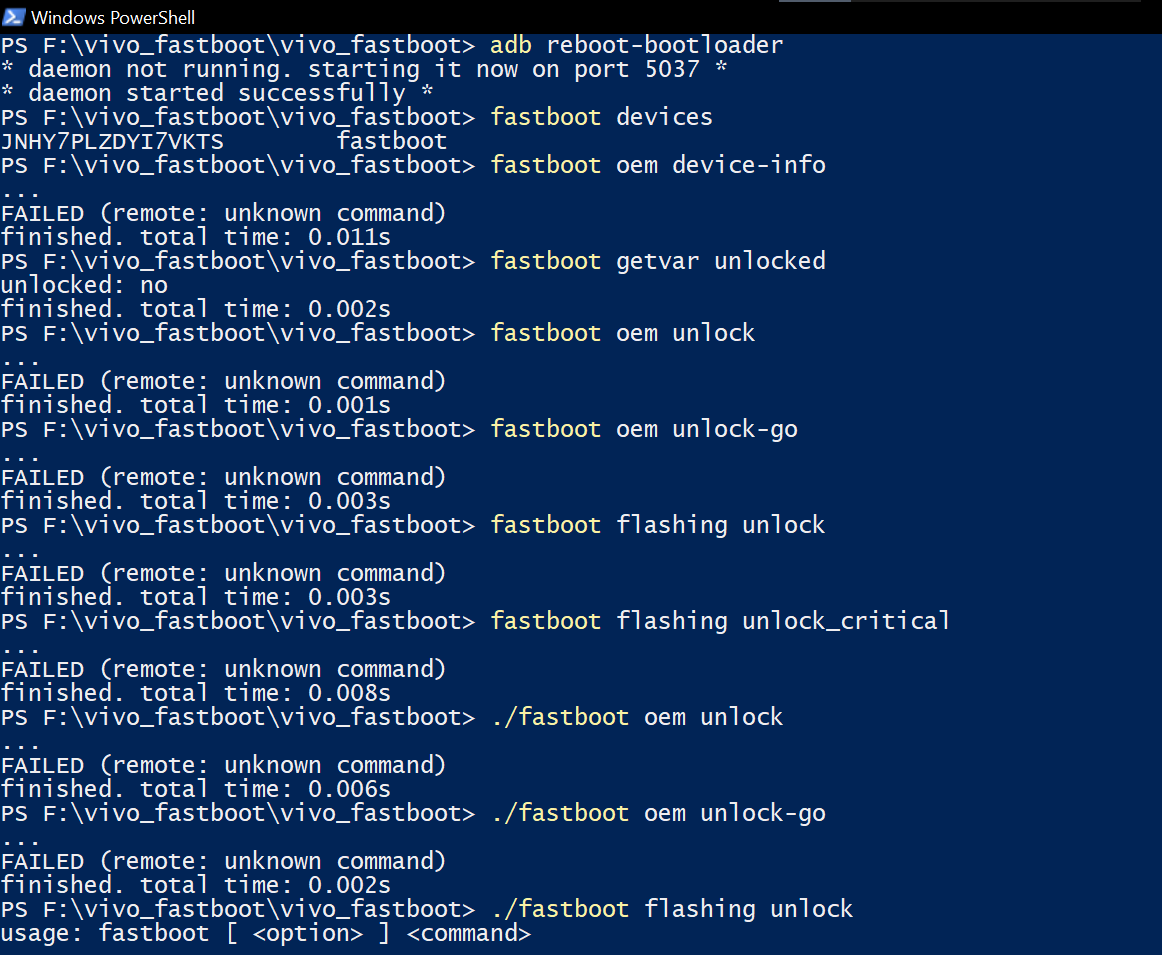

But how oem will assist me? tried all the fastboot commands from your site but says remote unlock failed, error:0x7000
nothing is there in google, everyone talked about vivo y51l , but mine vivo Y81 and I tried all vivo unlock commands but it didn't unlock my device bootloader
