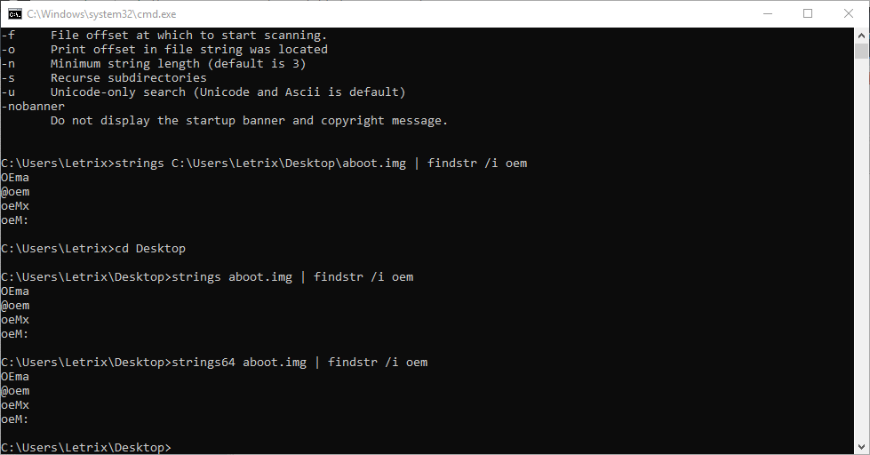

17-12-2017, 06:06 AM
This is my output
51,003
18-12-2017, 01:03 PM
(17-12-2017, 06:06 AM)Fermín“Letrix”Cirella This is my output
no OEM command there. You can try searching for other strings used in fastboot commands. OEM was just an example
This post was last modified: 18-12-2017, 01:04 PM by hovatek.
