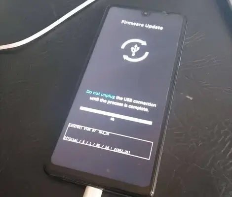

  • The device can enter Download Mode (Power off > Hold volume increase button > Connect to PC via USB cable > Keep holding the Vol+ button till it enters Download Mode)

  1. Boot the device into Download Mode and leave connected to the PC
    [Image: LG-Android-in-download-mode.webp]

Quote:In this video tutorial, I'll be explaining how to flash firmware to an LG Android device using LGUP (GUI) tool. First you need to have the dll for your device model. It can be in .msi or .dll. You also need to have the LGUP tool depending on the version you want to use and of course you need to have the kdz. You also need to have installed your LG drivers. I'll link  to that.. and boot the device into Download mode. Now, to boot into download mode, you power off the device. Hold the volume increase button, that's the up, then connect it to the PC via USB cable and keep holding the volume up button until it enters download mode then you'll see Firmware Update. This is what download mode looks like.
