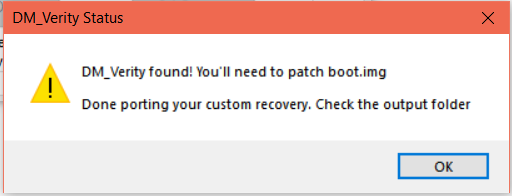

what's dm_verity status from the tool when you tried porting twrp?
also try flashing twrp ported from both v1.0 and v1.4

Hi, this is the status I am getting check the attachment please:

Hi, the problem is solved. Thanks for making this amazing tool as well as platform
