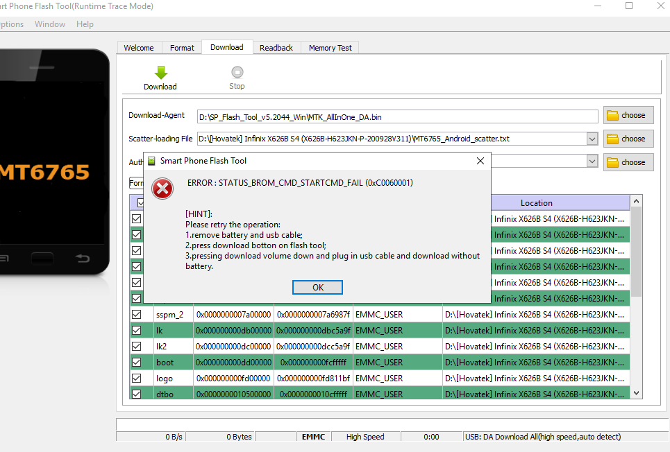

my phone is infinix s4 model x626b 64 gb - 6 gb ram v305
tried flash
4 firmware same proplem
1-[Hovatek] Infinix X626B S4 (X626B-H623JKN-P-200928V311)
2-[Hovatek] Infinix S4 (X626B-H623JKN-P-200307V295)
3-Infinix_S4_X626b_MT6765_H623JK_V226_190509
4-Infinix_S4_X626B_MT6765_V305_200727 (most tried)
but it wont flash it says: status brom cmd fail (0xc0060005)
same proplem in all flash tools tried (sp flash tool - swd -)
and lastest version of sp dlash tool says da file dont match when i insert infinix s4 da file in version 1824 da file work well but still same error (0xc0060005) .....tried format all + dowenload same in sp flash tool and in swd when i choose format all + dowenload its says use this function pls insert dongle i dont understand ??..... what should i do i tried so many solution
like chang usb , port , firmware file and flash tool
restart computer
start as adminstrator -charge phone few hours ..its dont give me any screen or power on ....im sure the device charged i put it like 2 hours then try then put it like 7+ hours but stil the proplem ...meanwhile the computer read phone normally and make sound when i put phone in usb
2 days ago flashed lenovo a5000 successful without any proplems idk what the proplem with that device
i want fast solution plz thank u ♥

see the fix for "lib da not match" @ https://www.hovatek.com/forum/thread-439.html
for SWD you're to use one of the previous versions that don't request for a dongle when you attempt using format all + download, it's indicated on the page @ https://www.hovatek.com/forum/thread-23708.html
