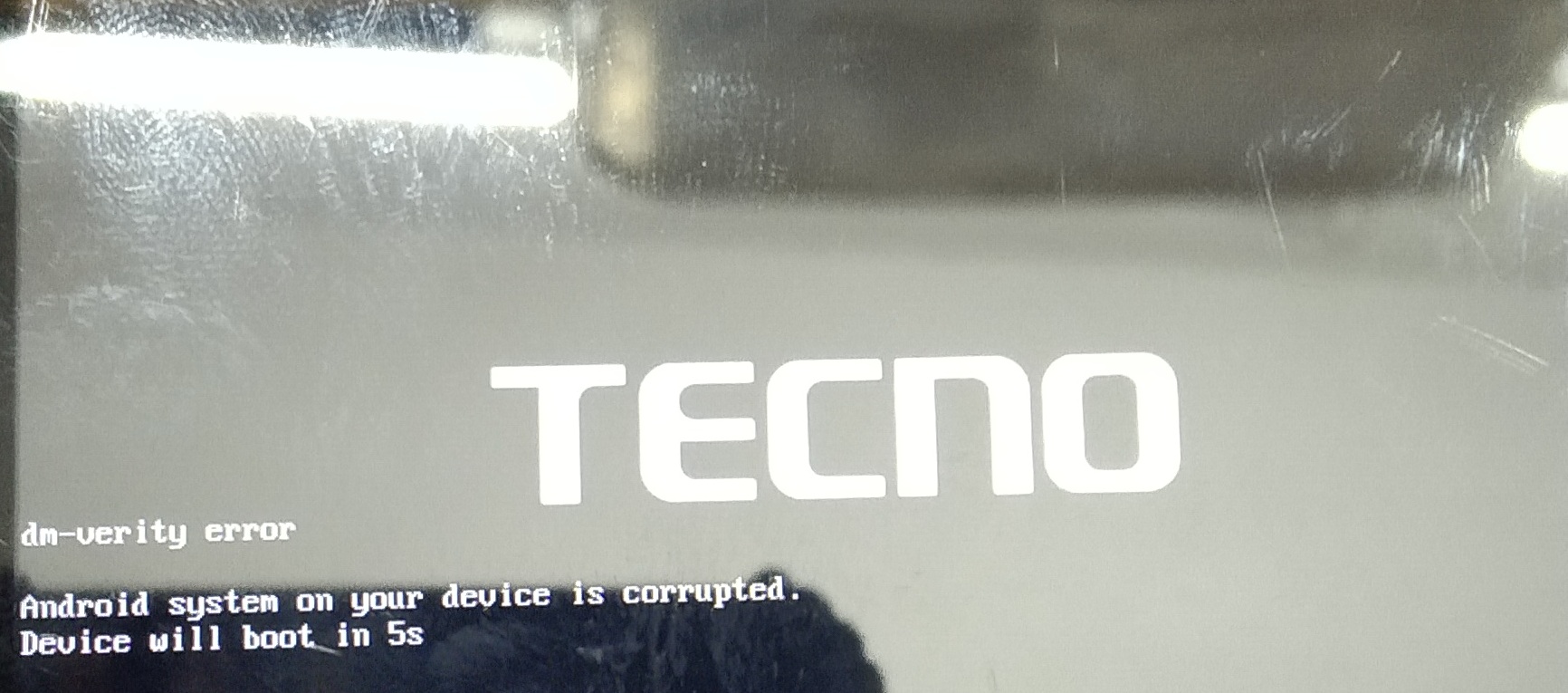

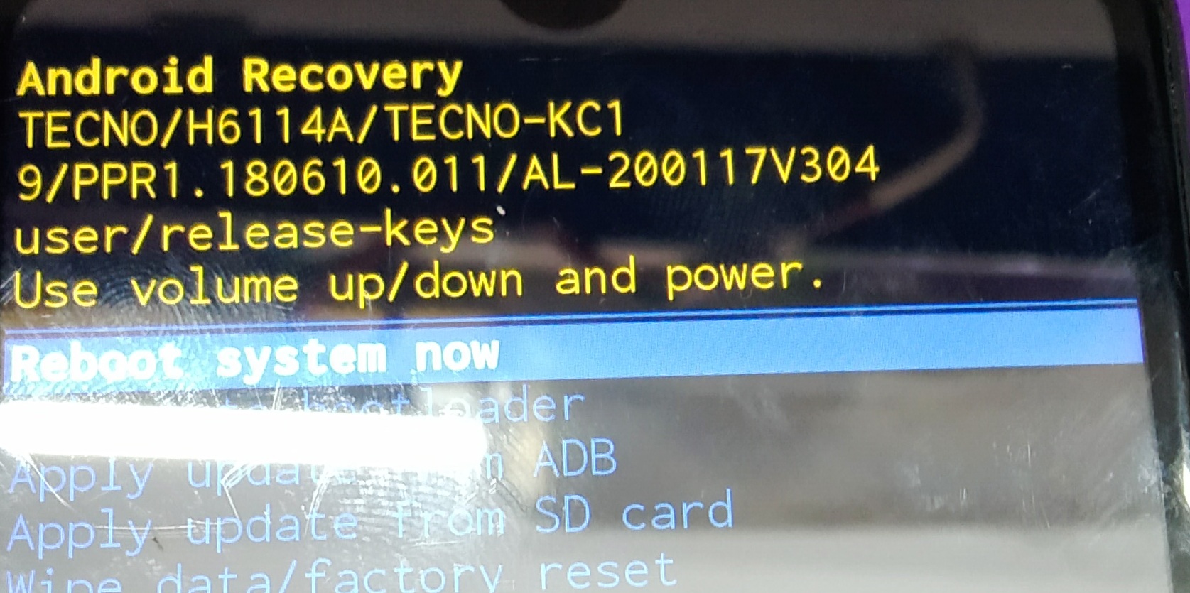

i have a Techno Kc1 ( 16+2A )
CONDITION :- " DM Verity Error Android system on your device is cruupted
device will boot in 5s "
PLss provide me tested flash file

(12-12-2020, 07:41 AM)mh_7878 i have a Techno Kc1 ( 16+2A )
Find out your build number using https://www.hovatek.com/forum/thread-16005.html
Download KC1 DA file @ https://www.hovatek.com/forum/thread-23243.html
Download firmware for your build @ https://www.hovatek.com/forum/thread-29560.html
Load the DA and flash the firmware using SP flash tool @ https://www.hovatek.com/forum/thread-159.html
