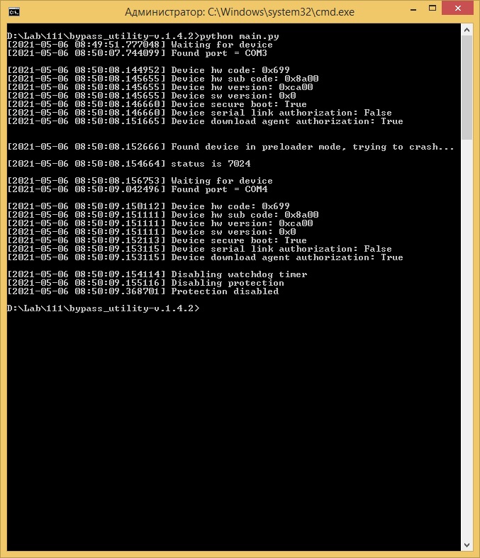

(05-05-2021, 08:34 AM)xfbvgsrgvs Still needed. Anyone have?
not available, you can use mtk bypass @ https://www.hovatek.com/forum/thread-37957.html

(05-05-2021, 03:01 PM)X3non

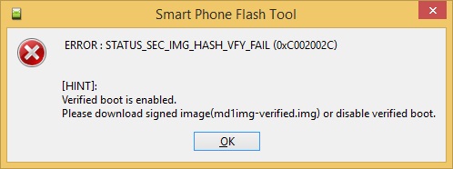

I tried, some parts of the firmware are not flashed.
This post was last modified: 06-05-2021, 07:02 AM by xfbvgsrgvs.

(06-05-2021, 06:46 AM)xfbvgsrgvs I tried, some parts of the firmware are not flashed.
skip md1img, try flashing the rest and if successful then confirm if you can boot to homescreen
