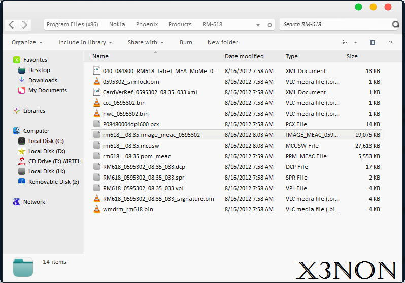

  5. Extract the contents of the compressed firmware file into the newly created folder. use the picture below as reference
    [Image: How-to-Flash-Nokia-Devices-Java-Symbian-ONLY-0.png]
