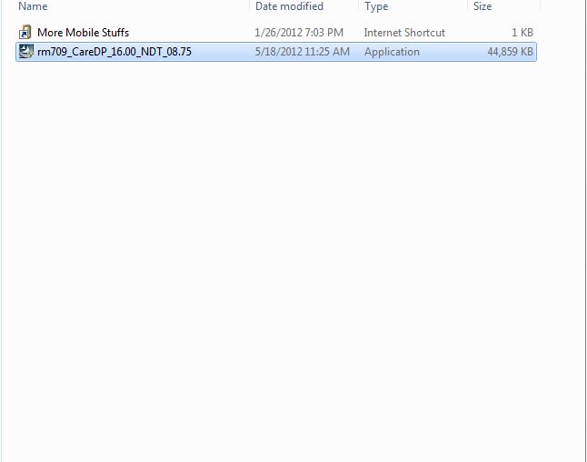

Hello,please can you explain to me on how to download Nokia x2-01 firmware, because I don't understand on how to download it? Thanks.
18-02-2018, 12:05 AM
(17-02-2018, 07:01 PM)walex24 Hello,please can you explain to me on how to download Nokia x2-01 firmware, because I don't understand on how to download it? Thanks.
Download @ https://drive.google.com/file/d/0BzbhQNO...lhcG8/view
This post was last modified: 18-02-2018, 02:13 AM by xerxes.
walex24
walex24
walex24
12

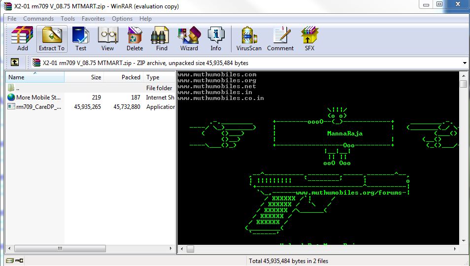

18-02-2018, 01:40 AM
Thanks for your response, but this is what I saw when I finished downloading and I extracted it and I opened the folder and run it but I cannot see anything.
But when I watch some videos on it and I think they are downloading it one after the other but there is one link that refuses to open please I need your help or I'm wrong, please I need your help. thanks.
18-02-2018, 02:11 AM
(18-02-2018, 01:40 AM)walex24 Thanks for your response, but this is what I saw when I finished downloading and I extracted it and I opened the folder and run it but I cannot see anything.
Please create a new thread so we can focus on it.
