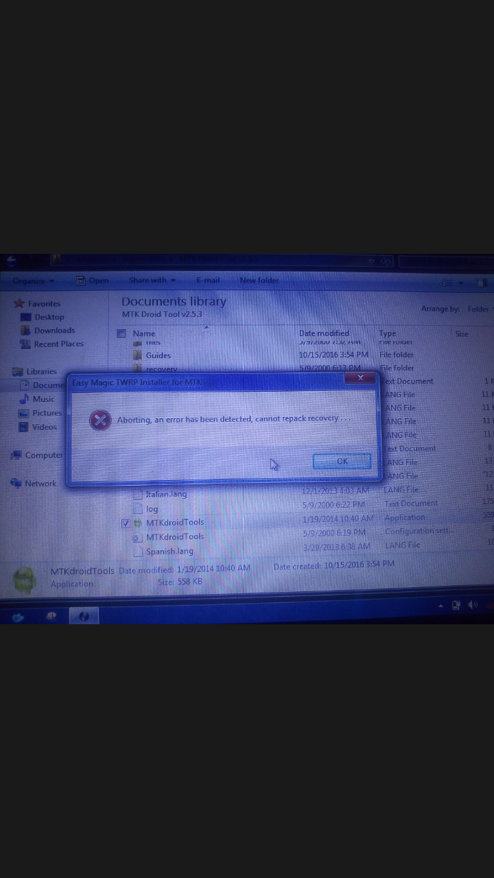

09-05-2020, 06:52 PM
This is the Easy Magic TWRP installer error

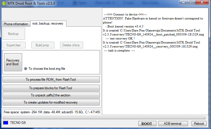

09-05-2020, 06:58 PM
This is the MTK Droid tool log. It said "complete, but, the stock recovery is still there...

(09-05-2020, 06:58 PM)dpol This is the MTK Droid tool log. It said "complete, but, the stock recovery is still there...
that is because you haven't flashed the ported cwm image. from your screenshot the tool only created the image but didn't flash
copy the cwm file from where it is stored and flash using your scatter file & spft

I have tried to use the method explained in https://www.hovatek.com/forum/thread-182.html but received en error response that the method is for MTK devices, of which Tecno G9 is one.
TWRP will be great instead, since it's touch screen enabled. Just that the method explained in https://www.hovatek.com/forum/thread-5162.html for its porting isn't working Tecno G9 either.

The CWMr has been successfully ported. The issue now is that the volume button hardware is not functional for navigation in the CWMr.  Please, can I get help with the TWRP (which is touch screen?)
disable your antivirus SW and retry the twrp tool again OR retry using a different PC
