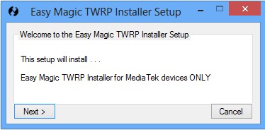

  • Launch TWRP setup.exe on the PC and click Next
    [Image: port-twrp-to-mtk-1.jpg]

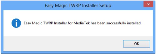

  • You should get a prompt confirming that the installation was successful, click OK
    [Image: port-twrp-to-mtk-2.jpg]

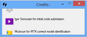

  • Wait till the credits note prompt is done then close it
    [Image: port-twrp-to-mtk-3.jpg]

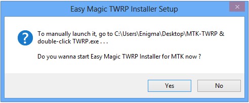

  • For "Do you want to start Easy Magic TWRP installer for MTK now", select Yes
    [Image: port-twrp-to-mtk-4.jpg]

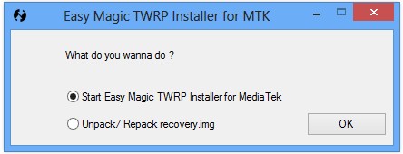

  • For "What do you want to do", tick "Start Easy Magic TWRP installer for Mediatek now" then click OK
    [Image: port-twrp-to-mtk-5.jpg]

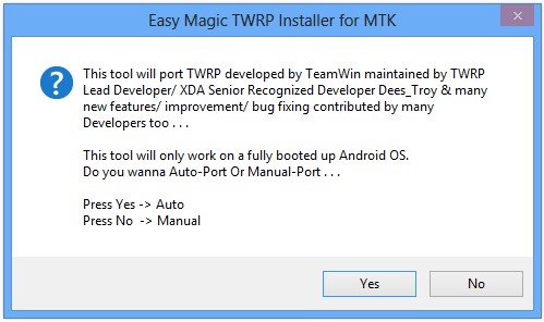

  • Click Yes for Auto-Port
    [Image: port-twrp-to-mtk-6.jpg]

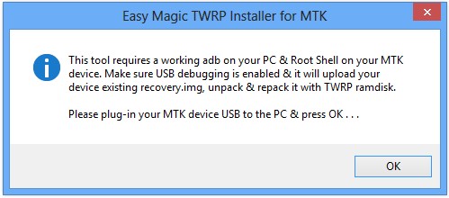

  • Connect the phone to the PC via USB cord then click OK
    [Image: port-twrp-to-mtk-7.jpg]

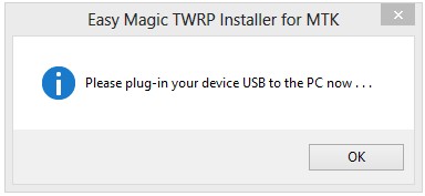

  • Ensure the phone is connected to the PC via USB cord then click OK
    [Image: port-twrp-to-mtk-9.jpg]

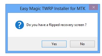

  • For "Do you have a flipped recovery screen", you may select No if you dont or dont know what this means
    [Image: port-twrp-to-mtk-10.jpg]

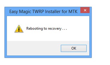

  • You should get a prompt saying "Rebooting to recovery...."
    [Image: port-twrp-to-mtk-11.jpg]

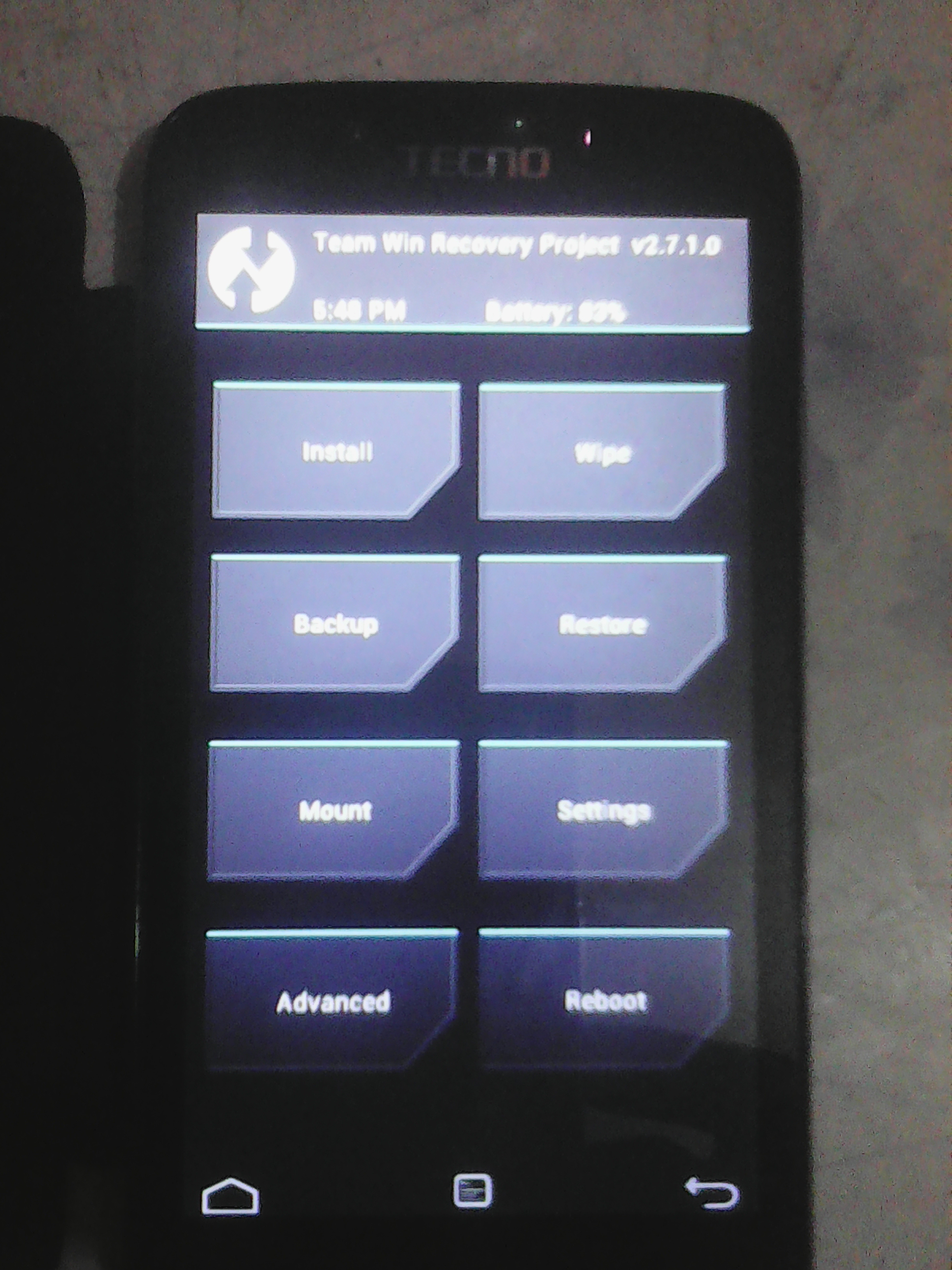

  • The phone should now boot into TWRP recovery
    [Image: port-twrp-to-mtk-13.jpg]
