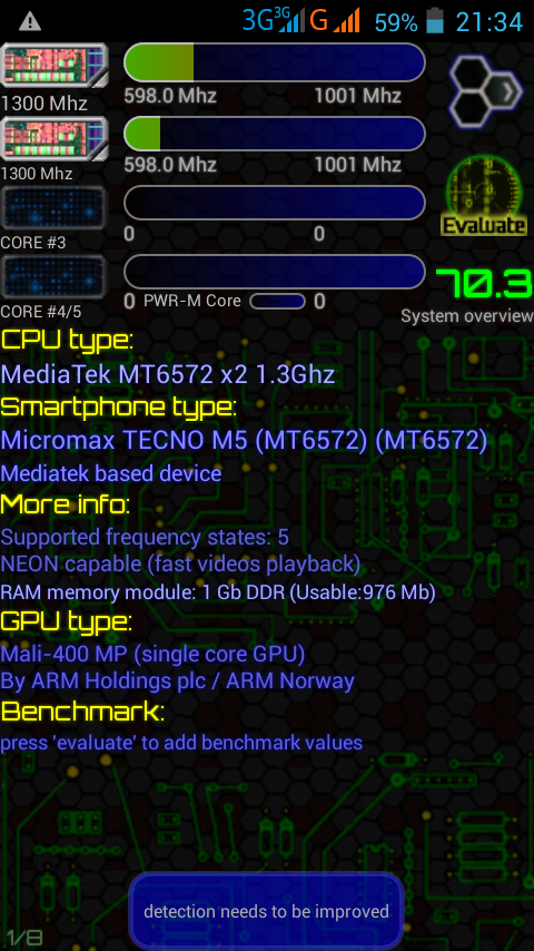

and please here is a screen shot of phone info and its model i just taken 5mins later

and please here is a screen shot of phone info and its model i just taken 5mins ago

(18-08-2014, 09:19 PM)mdavidlee no no please i did nothing either flashing rom or edit all idid was to install cwm image( recovery 5)!! so what can i do?
click No in step 9 to select manual port

(19-08-2014, 08:46 AM)mdavidlee ok thanks!! but if am going to do it in manual way then wont i be requested for additional files on it will continue normally on step 10.11 and so on basing on tutorial?
manual method will only ask for your recovery.img and boot.img
