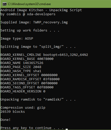

extract both your stock recovery and the ported twrp into different folders
copy the correct mount points values from stock\ramdisk\etc\recovery.fstab (you can edit the fstab file using any text editor)
copy the correct mount point values to twrp\ramdisk\etc\recovery.fstab
repack the twrp > flash and confirm that the mount problems is fixed. you can then flash supersu zip
for unpacking / repacking both recoveries, use AIK @ https://forum.xda-developers.com/showthr...?t=2073775
for unpacking, drag and drop the recovery file to unpackimg.bat
for repacking, run the repackimg.bat

Stock recovery's:
.zip
stock...fstab.zip
TWRP's:
.zip
custom...fstab.zip
Screenshots
TWRP process -
Stock recove. proc. -
Makes me wonder what the problem could be.
