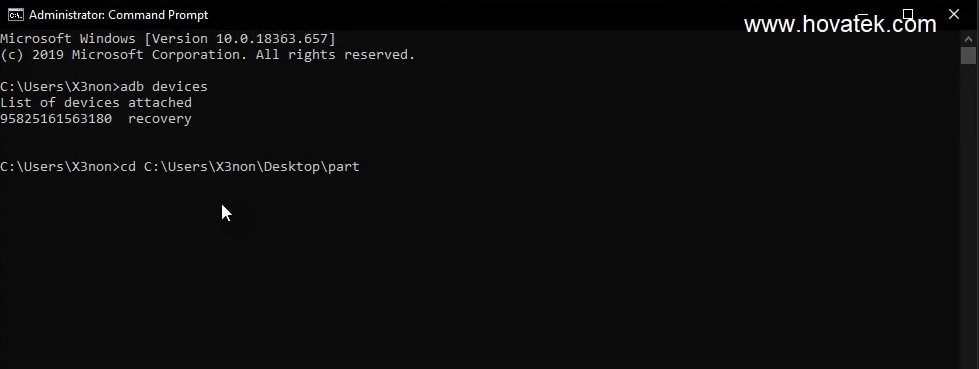

  4. Launch a CMD prompt / Powershell window and change directory into the folder containing the parted tool. In my case it's
    cd C:\Users\X3non\Desktop\part
    [Image: how-to-resize-partitions-on-an-android-p...rted-1.jpg]

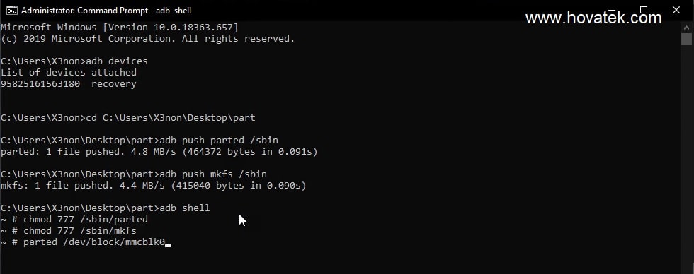

  5. Type the commands below and press Enter after each line
    adb push parted /sbin adb push mkfs.ext4 /sbin adb shell chmod 777 /sbin/parted chmod 777 /sbin/mkfs.ext4 parted /dev/block/mmcblk0
    [Image: how-to-resize-partitions-on-an-android-p...rted-2.jpg]
  6. You will be greeted with a welcome message from parted

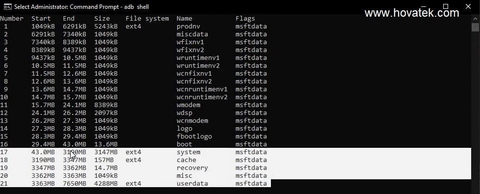

  7. In parted, type either of the commands below to view a detailed list of all partitions currently on your device
    print or p free
    [Image: how-to-resize-partitions-on-an-android-p...rted-3.jpg]

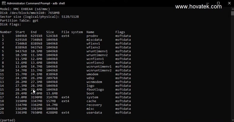

  8. I want to resize two partitions (system and userdata). Notice that there are several partitions in between the two partitions i want to resize (recovery, cache, misc)
  9. Highlight all the partitions between and including the two partitions you're resizing. Left click and drag to highlight then right click on the highlighted items to copy
    [Image: how-to-resize-partitions-on-an-android-p...rted-4.jpg]

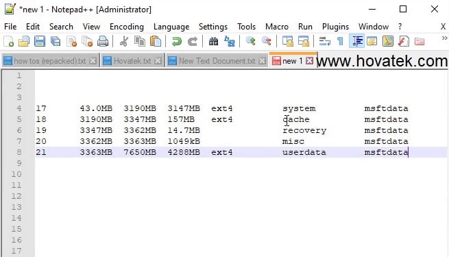

  10. Paste the copied items into any text editor such as notepad for safe keeping
    [Image: how-to-resize-partitions-on-an-android-p...rted-5.jpg]

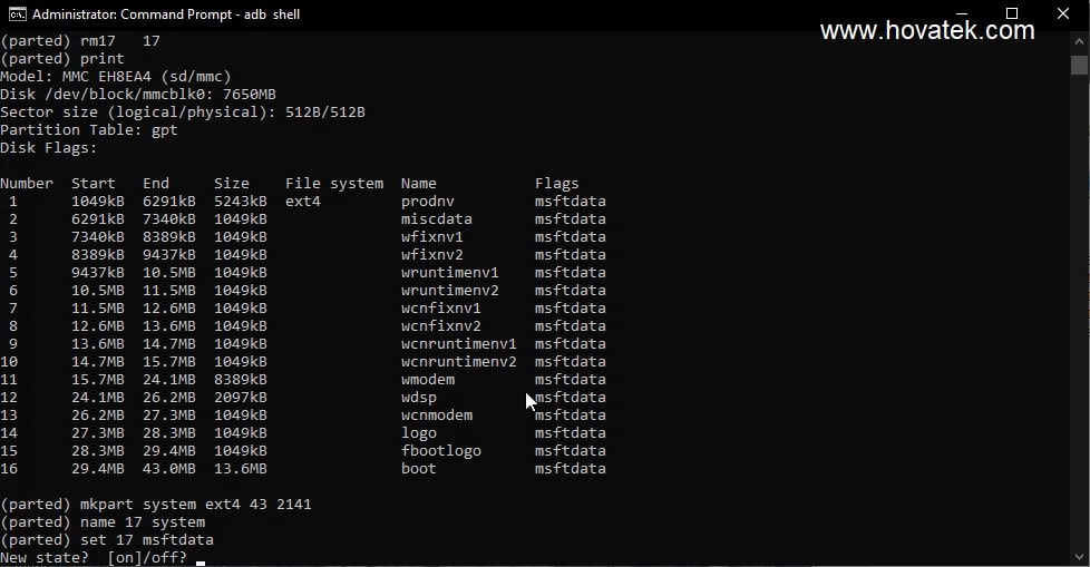

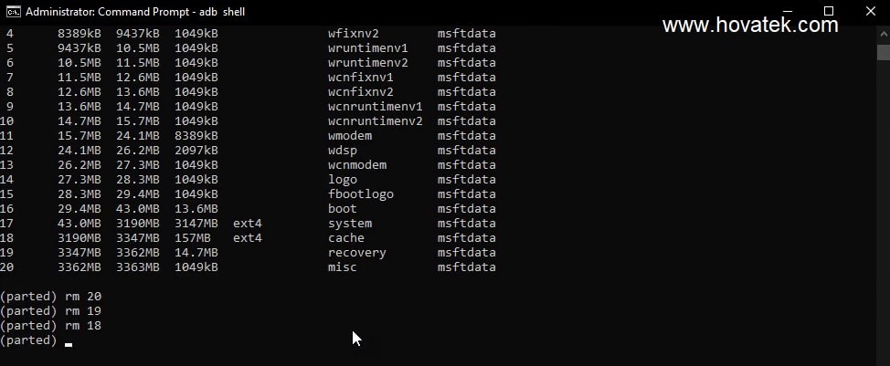

  11. Using parted, remove all partitions until you remove the partition you wish to resize (in my it's system partition at number 17)
    rm 21 rm 20 rm 19 rm 18 rm 17
    [Image: how-to-resize-partitions-on-an-android-p...rted-6.jpg]
  12. To recreate the partitions that has just been removed, use the command below
    mkpart system ext4 43 2141
    where
    • mkpart is the command for creating a new partition
    • system is the partition name
    • ext4 is the file system (if the partition has no fs, then use an empty space. So there will be 3 spaces in between the partition name and the start_length e.g mkpart recovery 2298 2313)
    • start_length is the end_length of the last partition (check using the print command)
    • end_length is start_length + the partition_size (unless you're resizing a partition, use the sizes from the values you pasted into notepad)
  13. Rename the new partition you've just created using the command below
    name 17 system
    where
    • name is the command for renaming a partition
    • 17 is the partition's number
    • system is the new name you wish to assign
  14. Set the flag back to the original flag the partition had before removing it using the command below
    set msftdata on
    where
    • set is the command for setting flag to a partition
    • msftdata is the partition original flag (you can check the text you copied into notepad)
  15. The output for above 3 commands for creating, naming and setting flag to a partition will look something like this
    [Image: how-to-resize-partitions-on-an-android-p...rted-7.jpg]

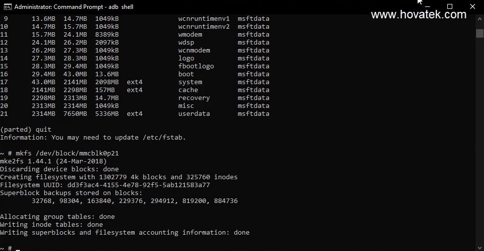

  18. Type the command below to exit parted tool
    quit
  19. Type the command below to format userdata to ext4 format (this will make userdata to become accessible on twrp for formatting)
    mkfs.ext4 /dev/block/mmcblk0p21
    where
    • mkfs.ext4 is the name of the second file you pushed into the phone along with parted tool
    • /dev/block/mmcblk0p21 ; 21 is the partition number of userdata as seen in the output of print command in parted tool
  20. Once successful, you should see the cursor blinking (waiting for a new command)
    [Image: how-to-resize-partitions-on-an-android-p...rted-8.jpg]
