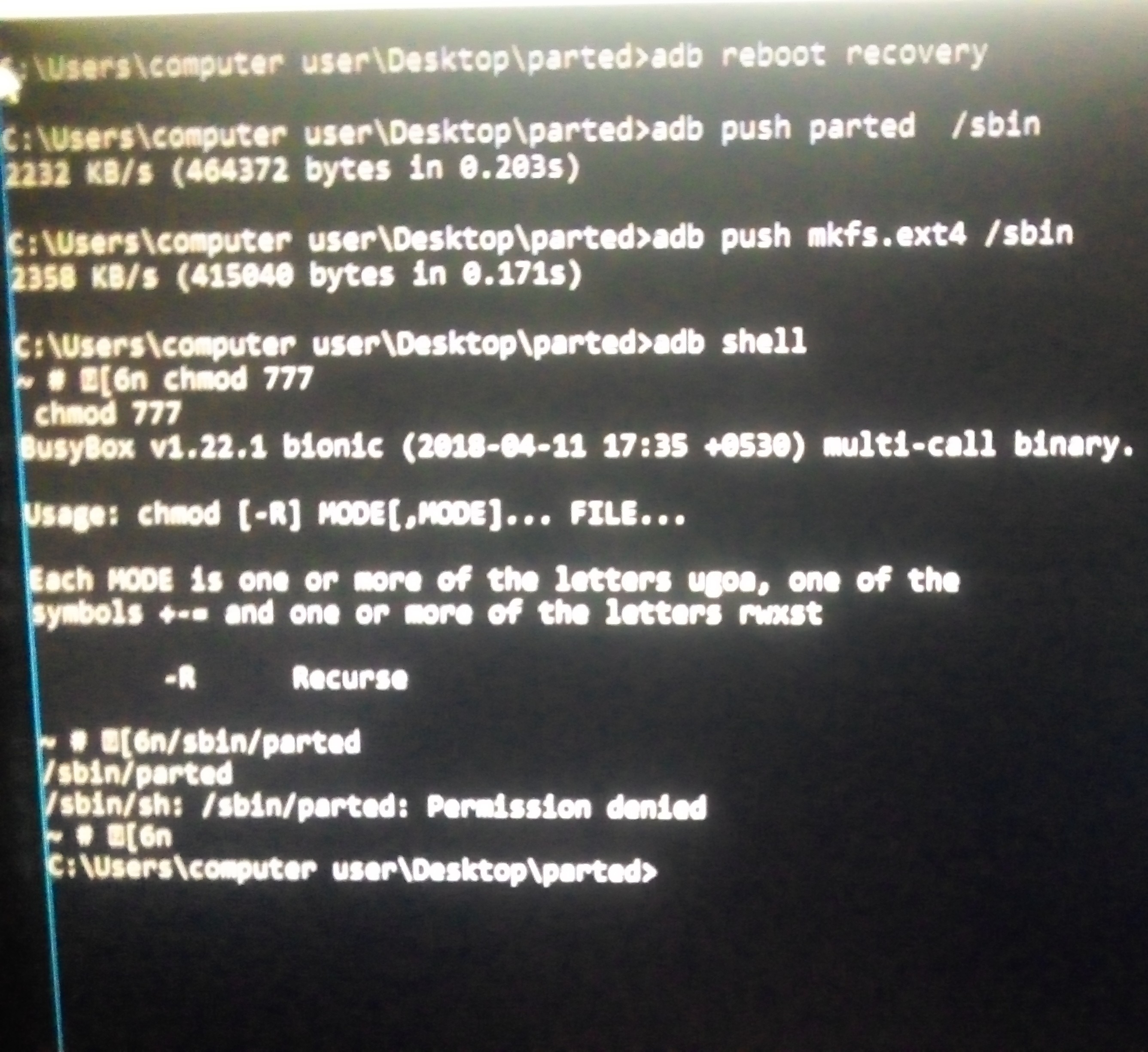

Hi! I download a costum GSI ROM and flashed but it was buggy so I decided to go for another version of it. TWRP said the file size is too big for my system.
Is there a way to increase The system partition or a tool I can flash to increase the partition?
Thanks in advance:-)

see https://www.hovatek.com/forum/thread-32750.html

18-07-2020, 04:11 PM
[attachment=7982   here the screenshot is. X3non pid='197690' dateline='1594886572']

the chmod command you issued seems wrong
go through step 5 in the guide and issue the commands as it is in the guide

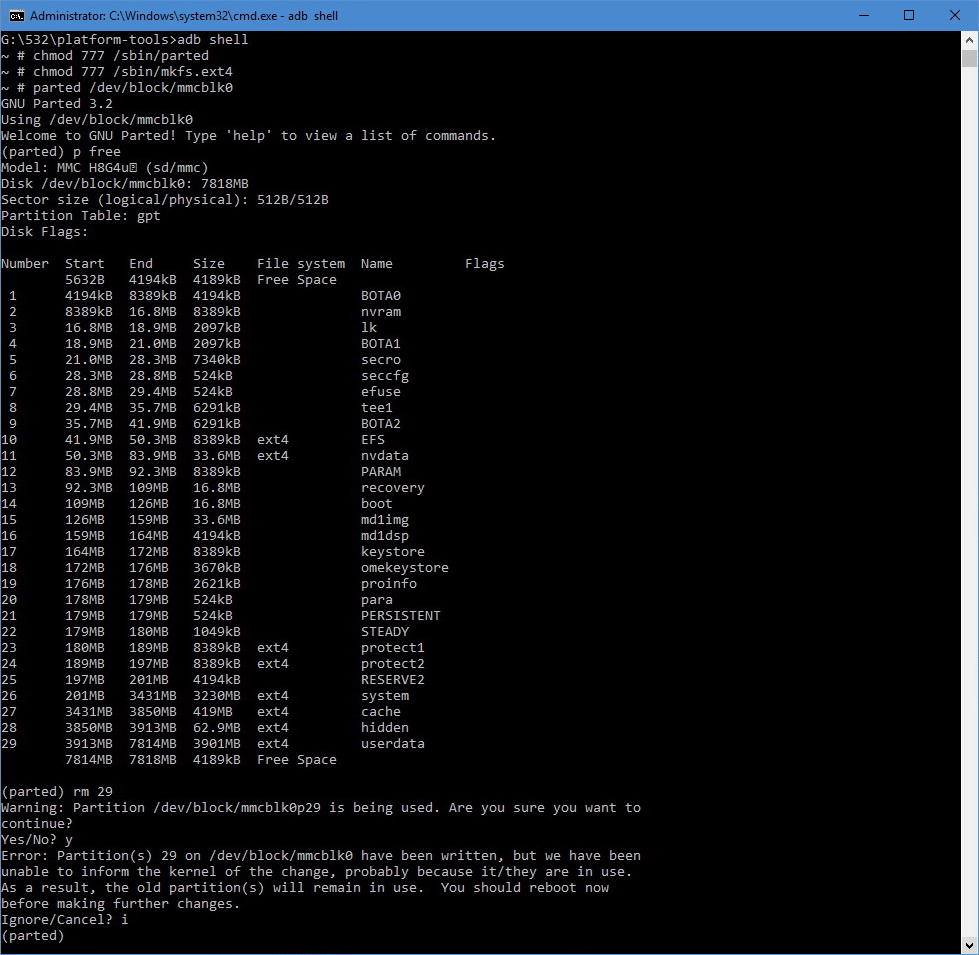

Hi X3non,
I am trying to resize partition /system and /userdata to increase space for apps.
I did steps as instruction from topic https://www.hovatek.com/forum/thread-32750.html
While deleting partition /system, an error happened, the partition /system has not been deleted and a message appear:
"Error: Partition(s) 29 on /dev/block/mmcblk0 have been written, but we have been unable to inform the kernel of the change, probably because it/they are in use. As a result, the old partition(s) will remain in use. You should reboot now before making further changes."
Please see the attached picture and help me to solve it.
Thanks in advanced.

18-11-2020, 10:17 AM
(17-11-2020, 11:34 AM)dunhill_ Hi X3non,
Thanks in advanced.
this is someone's thread, create a new thread for your device issue by clicking "Ask Question" at the top
and in your thread ensure to state your device model
