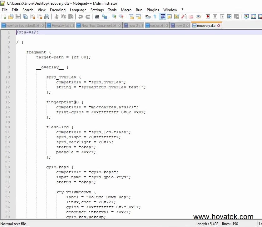

  11. Switch back to windows OS, Open the .dts file using any text editor such as Notepad++
    [Image: how-to-find-the-touch-input-driver-of-a-...vice-5.jpg]

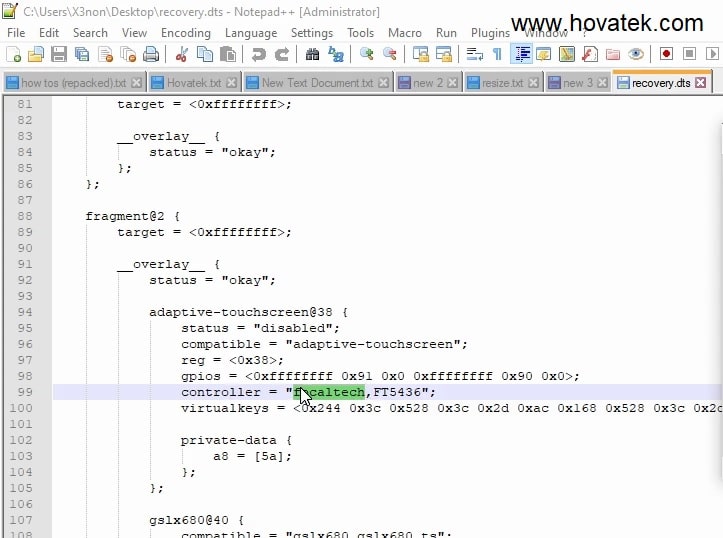

  12. In notepad++, click search > find
    find what: focaltech
    [Image: how-to-find-the-touch-input-driver-of-a-...vice-6.jpg]
  13. Now focaltech is a driver very common in spreadtrum / unisoc devices, but you need to look closely at the items both on top and below focaltech's section
    [Image: how-to-find-the-touch-input-driver-of-a-...vice-7.jpg]
  14. You'll eventually find the touchpad driver for your device (in my case, it's just below focaltech and it's named gslx680)
    [Image: how-to-find-the-touch-input-driver-of-a-...vice-8.jpg]
